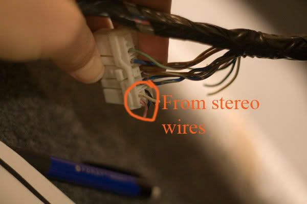

    if it doesnt then the way to figure out what speakers are what is to consult your aftermarket stereo instalation guide. simply find out what color the right front speaker is... follow the wire to the chassis's harness and then write that color down for the positive or negative terminal. this is how i did it as you can see in this picture

    another thing nissan and clarion did correct is they placed the INPUTS *from the head unit* on the RIGHT side of the plug if you are looking at the plug so where you can see the fastening clip.
    picture here:
    this is with all 4 of the input wires clipped

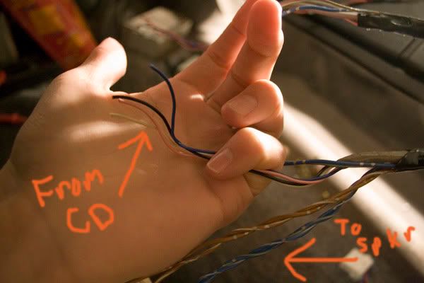

    anyway. after you cut those wires and put them aside the next thing you need to do is take the color codes i have on this picture here:
    and the picture after it is an example of the wires and what they looked like for all you visual learners like myself
    and just match the wires up

    ONLY CONNECT WIRES TOGATHER IF THEY ARE ON THE SAME PLUG... as the smaller plug is associated with rear speakers and the larger plug is associated with the front speakers. if you complete this and cant pull the two plugs apart... check your connections...
    yes there are two solid blue's and two solid pinks... but one corrosponds to the drivers front and the other corrosponds to the passangers rear.. you'll have some funkeh music if you wire it up wrong...
