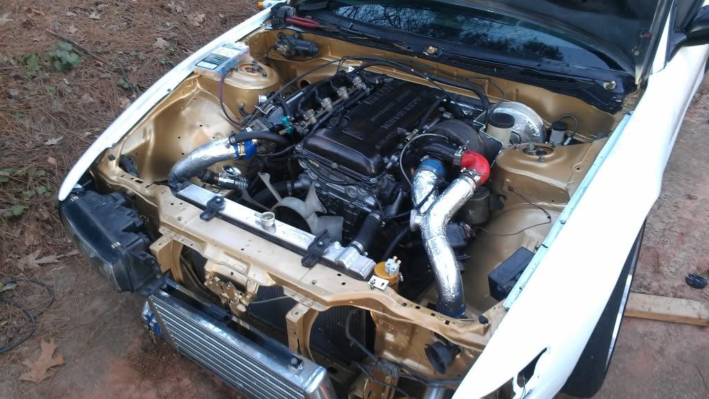

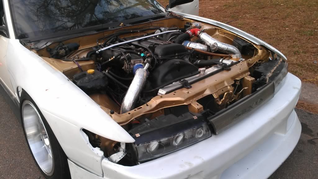

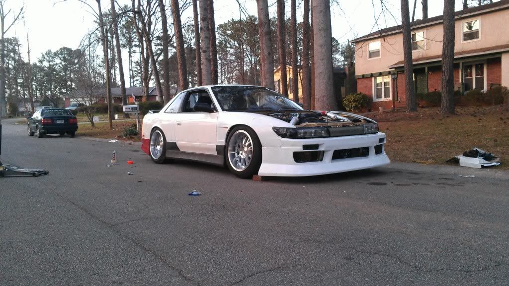

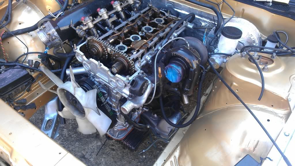

    Well car runs now. Timing Is alittle off but nothing major.
    Did a lot of custom welding work yesterday. Delted the flex area on my megan down pipe. Made a custom fmic mount (looks really good) mikes also making me a custom silvia hood using my s13 hood. Still have to do small things like hook up gauges, alignment, dp and exhaust. If it wouldn't have rained Saturday I would be diving it. We also has to modify my dual projector housing. We cut the fog light out and fitted it with a fog light from a tripple prjector since it had all broken tabs. All wiring was shrink wrapped and done legit. No more shitty speaker wire.
    Getting tires mounted. Payed 30 for all four they all still had a lot of life on them. Big side walls but couldn't beat the price.
    Drag car status lol
    Also had to fix the wiring on my old rb26 s14...hmmmmmmmmm I wonder why lol
    Will post some more pics and videos and a dyno sheet from sammy. Compression is 165 across the bored. Successful rebuild!
    Sent from my myTouch_4G_Slide using Tapatalk 2

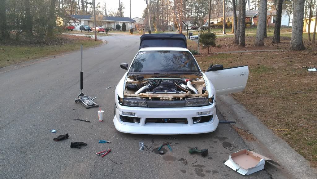

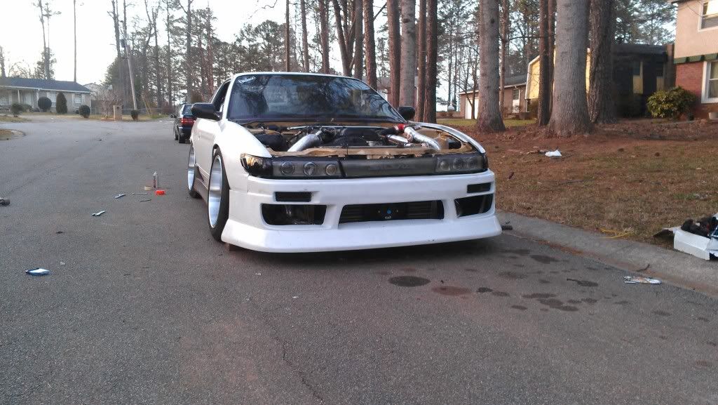

    Progress car runs and drives. Need a few more things to do

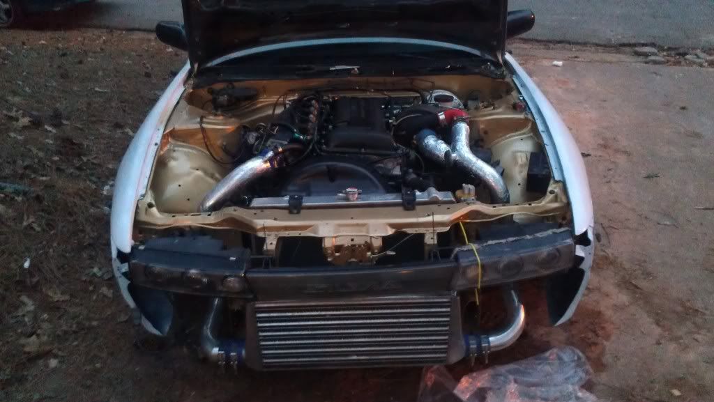

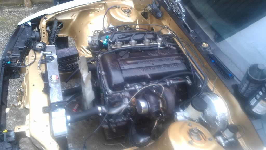

    The paint arrived time for paint this weekend. Also ordered GKtech offset spacers and stage two circuit sport inner and outer tie rods. Everything is ready and the car is drivable. Just needs a serious alignment.
    Also installed a GKtech aftermarket clutch fan blades with a oem shroud. Hooked up two high powered efans. One on my radiator (back up) and one on my intercooler up front which should defd cool the air passing by a lot more. Over kill but its better to be safe then sorry especially with ga heat.
    I decided on hot rod gloss black with some (tiny) gold holographic flake. We will see how that turns out.

    Fan on the intercooler is pretty pointless, its only going to have an effect when the car isnt moving... and the effect its going to have is going to be about the same as throwing a spoon full of water into a swimming pool. attempting to increase horsepower on a car when its sitting still makes no sense.
    If you wanted to create a temporary air charge or something to rapidly cool your intercooler, you should use water or nitrous. They make fogger plates specifically intended to cool your intercooler. Obviously that's not something that's very cost effective..... but you can also use water in the plate or make your own with irrigation parts from the hardware store. Most people who do something like that connect the lines from their window washers and divert them to the intercooler, you also have a factory installed control system already in your dash... when you press the window washer button, it sprays water on your intercooler. The downside is, you will now have dirty windows.
    That's actually not a bad idea. Thanks man.
    The fan was more for pushing air
    Threw both the intercooler and radiator I just mounted it on the front of the fmic so it could pick up a good bit of air. Didn't do it to gain power. just trying to keep the engine bay as cool as possible.
