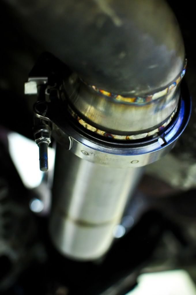

    Because I was using a stainless goodies, I had to get the flange cut perfectly flat before all the tubings got welded by Walker @ MPFab.
    If flange is not flat and tubings are not welded correctly, the heat this engine will produce will warp the flange and will have a leak.
    Here are some pics of the DP, turbo flange, heat shields, etc that MPFab.com made. The welding skill is one of the best in the country!!

    Downpipe is so straight, you could see the other side!
