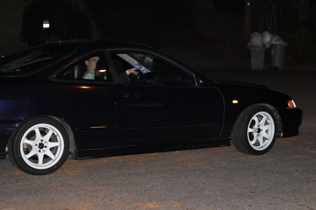

    This is what she looked like when i first got her.
    needed some new rims, xxr 16"

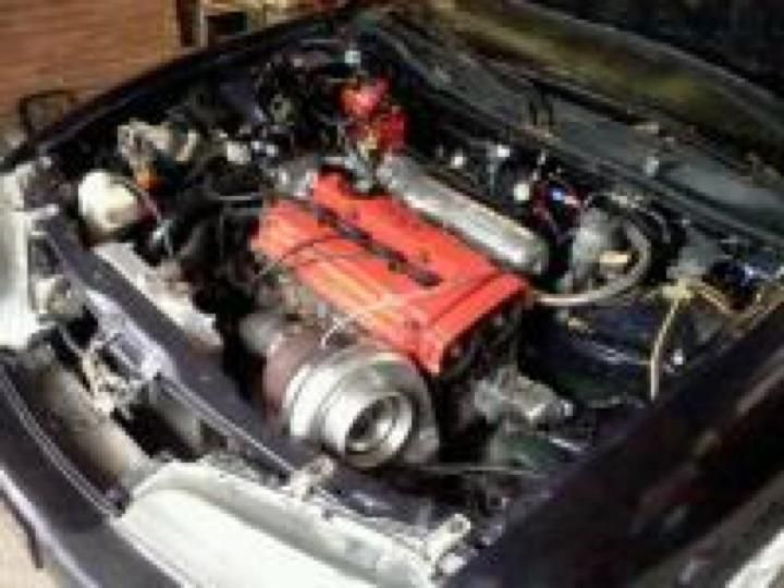

    engine bay when i first pulled her top off.
    [IMG][/IMG]
    bad ass carbon fiber headliner i had done.
    the turbo was so big the hood wouldn't shut lol
    So i cleaned her up and did a minor wire tuck
    then i cut her heart out....new build pics coming soon ill be uploading pics of the parts i throw at her.

    thanks guys, the headliner was done in canada at a shop called topshop fabrics, they unfortunately shut down about a year ago. So i have one of the only ones, i still haven't seen another yet. sorry about the pics they're kinda old, and off of different devices. the next pics will all be high res.
    the last build:
    b18c5 block and head, ported and polished heads,crower cams,titanium valves, springs, and lifters.
    darton 84mm sleeves je 10.5 to 1 pistons, eagle rods,edlebrock intake manifold,1600cc injectors, 1" steel braided fuel lines.
    custom manifold, garrett gt42r turbo, 3" custom piping, tial wastegate, bov, and intercooler.
    tuned on c16 with hondata s300. Im probably forgetting some shit just got off work so not really trying to think.

    How much did you put down (HP) on your former build with gt42r?
    Mar 2012
    atlanta ga
    151
    14
    on c16 it was making 503.4 hp 450 ft/lbs. the turbo came on so late it was worthless, unless you were doing freeway runs with the v8 cars. Im hoping for a lot more reliable build with a shit ton more power.
