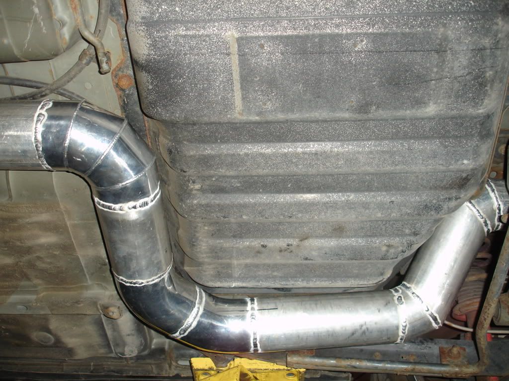

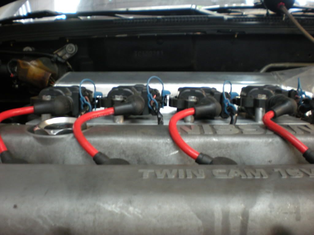

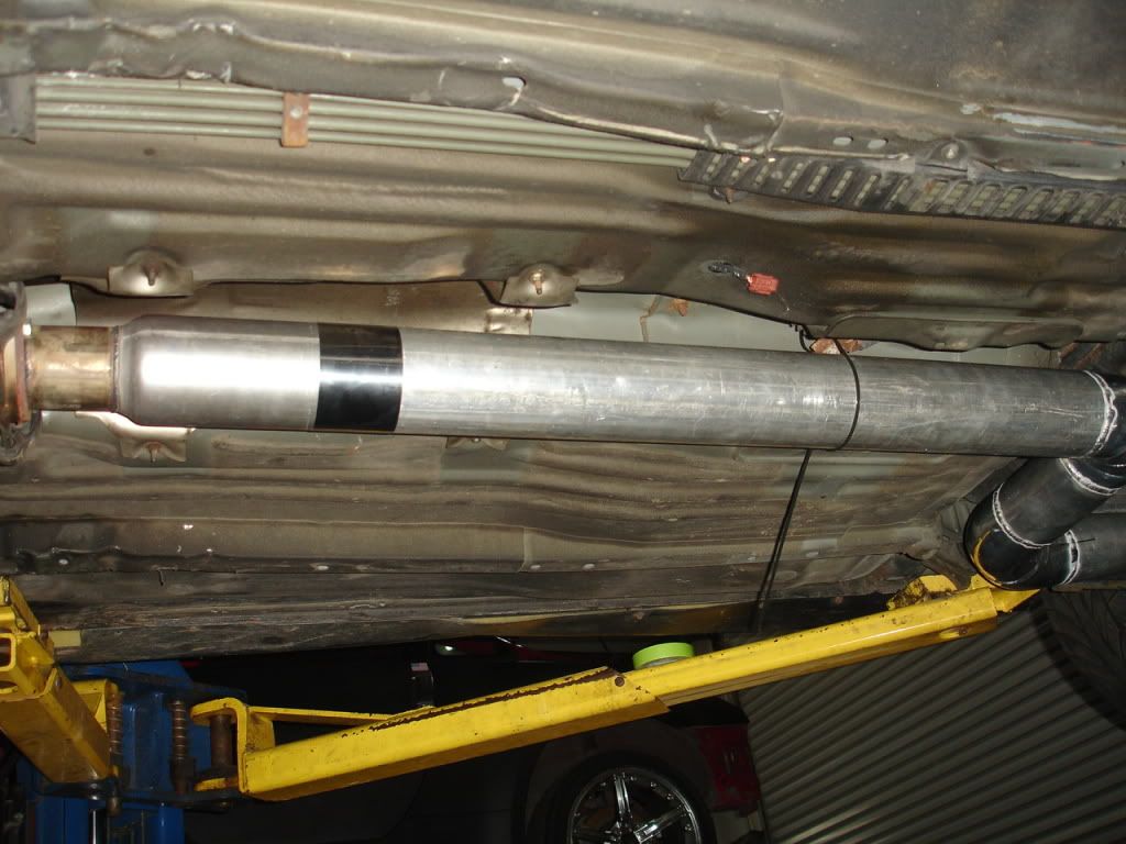

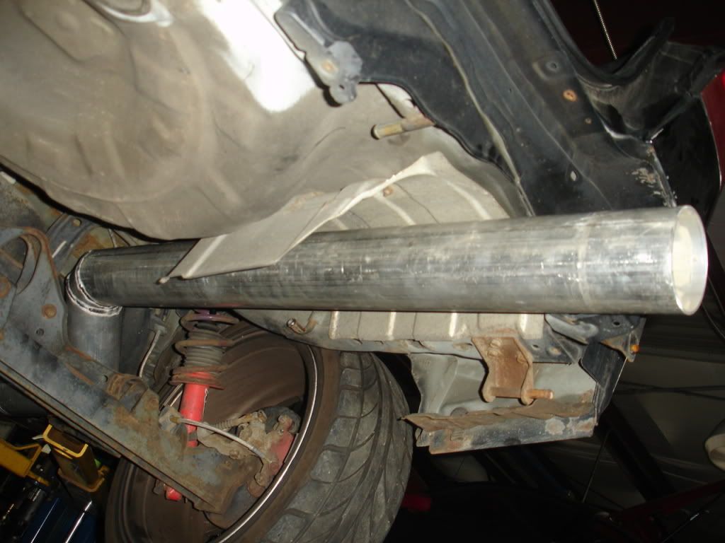

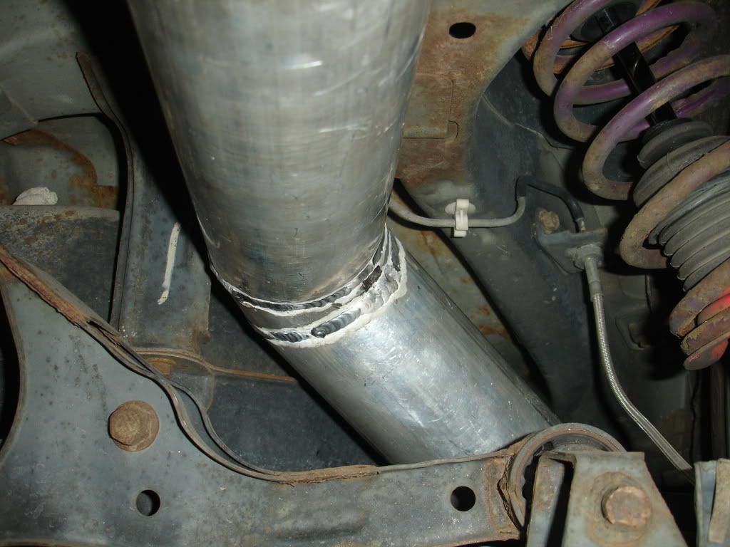

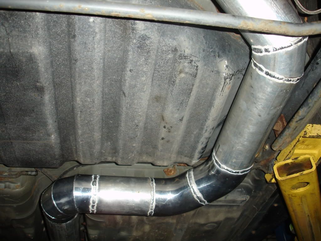

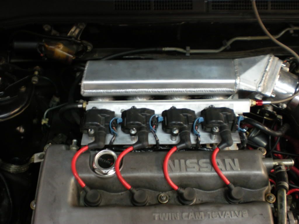

    This set up was done for a 200sx that was having ignition problems at high (24+) boost. Running an AEM EMS, so this set up was fairly straight forward. I really like the way this turned out. Ultra clean and low profile. We also fabricated a 4" aluminum exhaust. No BS straight through no muffler. We made a 3" to 4" steel section and then band strapped the aluminum section. Almost exactly like our drift car.
