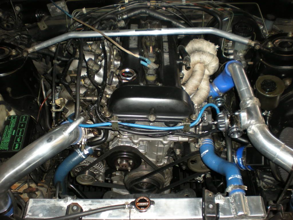

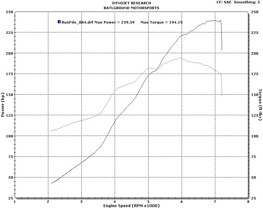

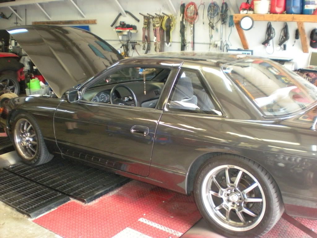

Customer Car brought to us yesterday on a flat bed. Simple set up, AFC-Neo, manifold, 3" down pipe, 3" exhaust, FMIC, Z32 MAF, 550cc inj. Only ran wastegate pressure, no boost controller, 10 psi.
