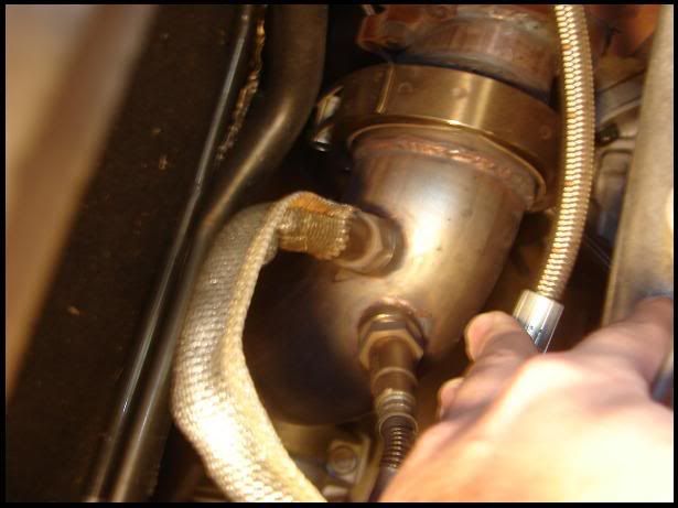

How to. You will want to drill a hole in the DP and weld the appropriate nut to the DP with the same threads an O2 censor will use. If the hole is not going to be used then get a screw(with corresponding threads) and a washer and screw it in the hole till you need it down the road. One thing that is important here is placement. You need to ensure that when the flow goes through the exhaust that it can pass evenly by the censors. In other words stagger them a little and don't put one right behind the other. Here are a couple shots of mine.
