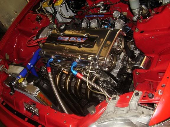

    Beau, what you want to do is really drill the front of the valve cover by the baffles. Run a baffled oil catch can, run both lines to the catch can, run the stock PCV line to the valve cover location but put a breather filter in between them
    Mine

    damn thats nice

    thanks mike that is a little more helpful.
    that last car is a guy named blake. he has some bad ass ITB he has made him self. and is gonna run the new RM h24x cams. with like a .500" lift cams. gonna be pretty sick.
