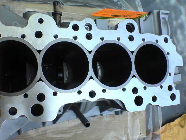

    heres a update my future set up just have to assemble it
    opinions welcome

    I already can guess what this will be... boosted B16 (1.7L). Am I right? Or if it's N/A you're gonna do the 1.9L Crower stroker kit.
    its built for juice on the compression i want . and it s 2.0+l and yeah its a crower stroker
    everywhere & nowhere
    16,170
    I got the 1.9L kit sitting at home in my living room (more rev friendly than the 2.0+ L B16 kit). Good stuff!!!
    thanks! im just waiting to to ship it here i left it in cali .. its the stoker for a 1.8 L 92mm still rev friendly but not to HIGh lol

    good write up. Is that ERL block got a deck plate on it? it looks like its got something on top of the deck, maybe its just the pic
    yup a deck plate . got it from ERL about 1 monrh ago just left the bloc in Cali when i moved out here

    good man! finally someone that knows how to stroke a stock block. People try to cram 95mm or 92mm cranks into stock deck height motors then want to rev the piss out of them. They have no idea what piston speed is lol.
    are those custom Crowers or off the shelf? just curious if you went with a long rod for the 92mm crank an a custom piston, or whether its off the shelf stuff.
    there not really custom . stroker for the 1.8 of the shelf , cp pistons

    yeah i know the 95mm cranks Crower sells B16 rods to go with them, so when guys run those rods in there 1.8 or 2.0l motors, the piston speed at 9000rpms is retarded. So most guys do a custom long rod wiht a piston that has the wrist pin moved to get some more RPM out of it.
    either that or buy the DART tall deck.
