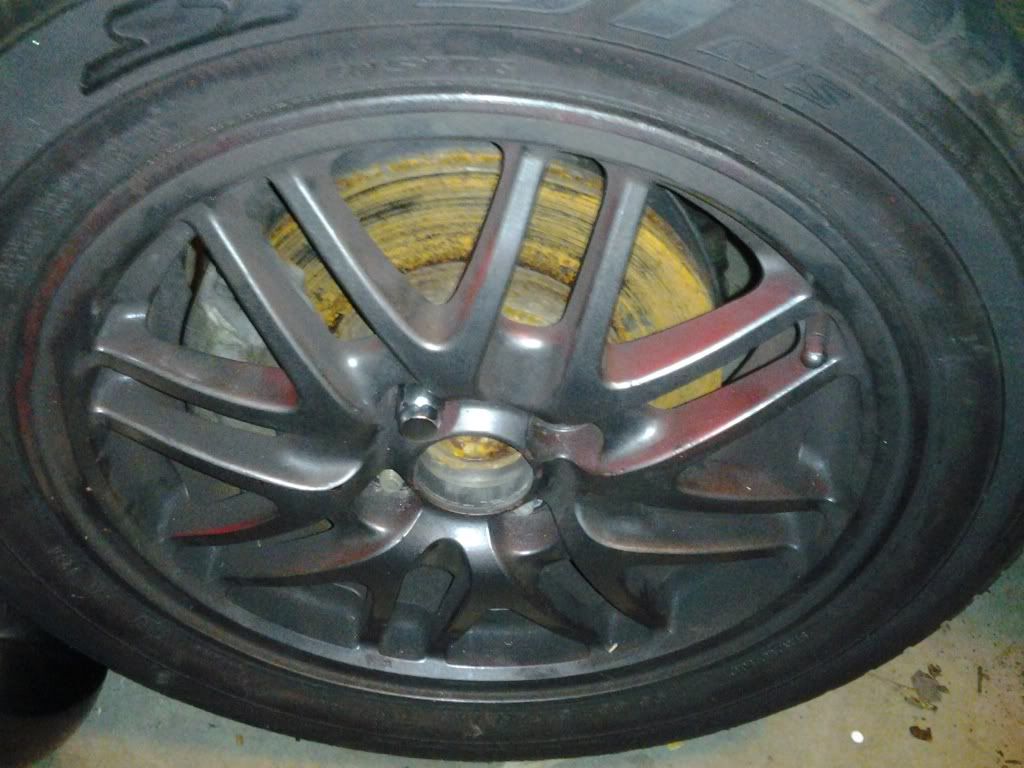

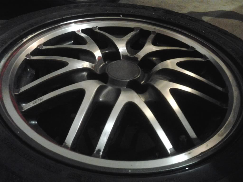

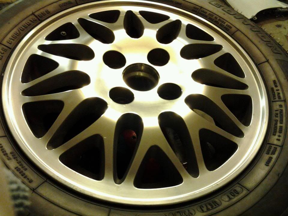

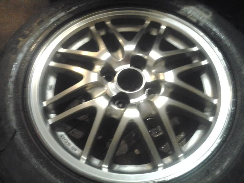

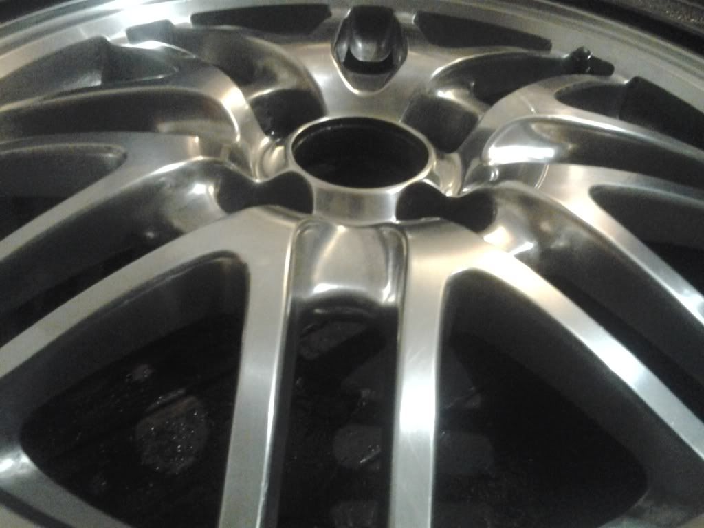

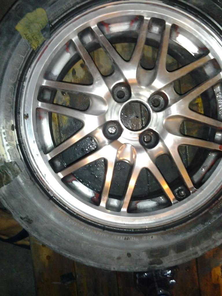

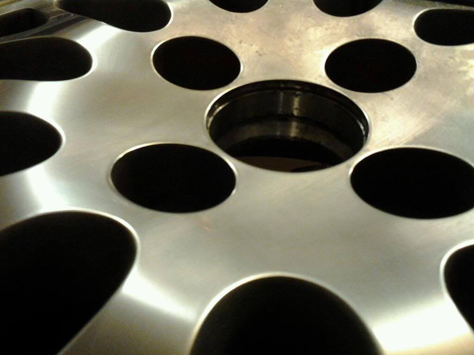

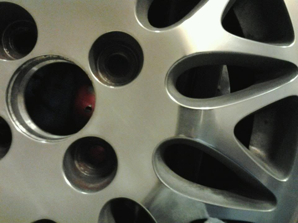

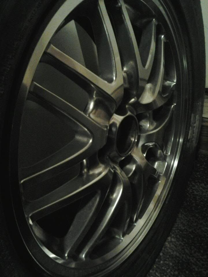

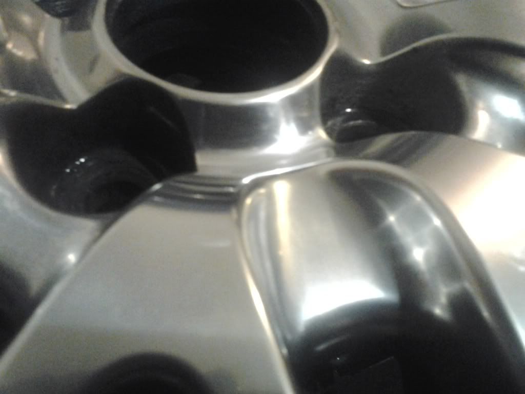

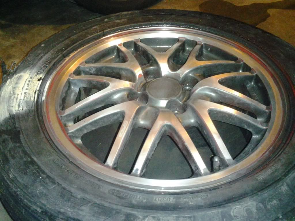

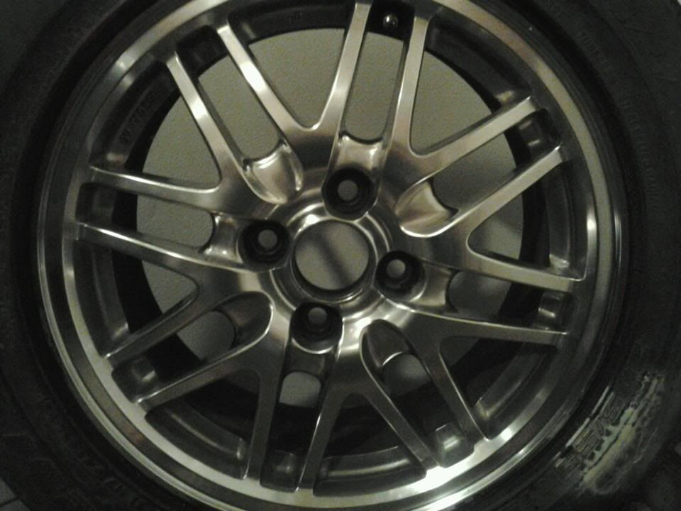

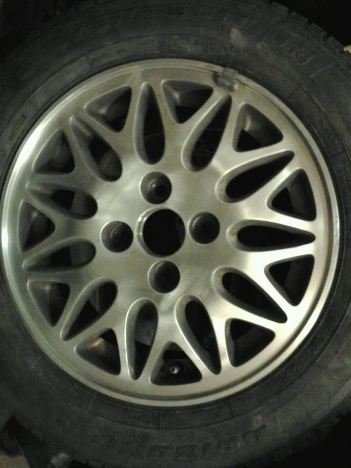

    PPLS.. alot of ppl didnt believed when i said... i can make sum ugly ls meshies look hella good.. well.. i took it like a challenge... not just by polishing the face like sum other ppl do to their wheels i decided to go the extra mile even if it takes longer.. so HAND POLISHED!!!!!! the whole thing... here are some pics to prove it =]
    but then after!!!! my boy wanted me to polish th face to his snowflakes.... and so.... i did.... =]

    damn those look SICK

    @munky... you need 400 grip sand paper.. 800 grip.. 2000 grip finishing lots of water.. lots of time.. gloves so you fingers wont peal as bad
    and lots of patienceeee.. and ofcourse some very understading parents to let you do what you want in your garage lol

    GREAT JOB i have done this myself so let me translate;
    you need 400 grip sand paper.. 800 grip.. 2000 grip finishing lots of water.. LOADS OF FUCKING TIME.. MUST HAVE gloves if you want to have fingers afterwards
    and BUY LOADS LOADS LOADS OF PATIENCE.. and ofcourse some very understading parents to let you do what you want in your garage lol[/QUOTE]

    it's grit, not grip LOLOL also...when i did mine i only went to 800 and worked my way up and mine came out fantastic...you go w/ lower grit if you care to remove some gashes on the lip pretty much, i had some gashes, but they werent that bad to where it'd make me go that low of a grit.
