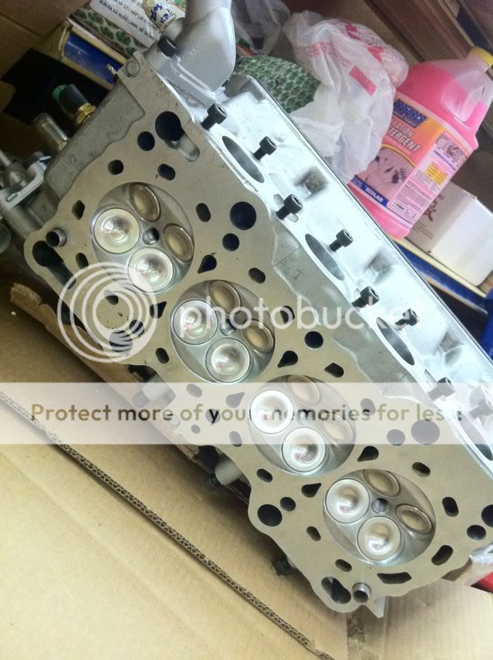

    well i would like to share to the community a build i have going on- my last setup was a 84mm b20v on pr03 cams with supertech valvetrain...after 10k miles of abuse/daily driving and 9k revs the retainer decided to fall apart...almost dropping a valve..some said its ok to run pro3s on supertechs/daily/ etc etc... some say dont...well i took a chance.. and learned from my own experience.
    new setup going to machine shop monday- hopefully to get her running for IFO.showdown
    h22 head
    ferrea valves/springs/retainers
    mild port/clean
    skunk2 pro2 cams
    skunk cam gears
    special h22 intake
    highend header/logic motorsports?
    3'' straight pipe

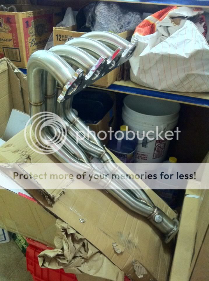

    Nice Build. Thats the same header Im going to use..

    thanks man- i got really confused... whether logic and highend was the same... im sure they are..

    Yes pretty much the same thing, i plan on running that header in the future but couldnt pass up $50 for my rmf rep lol.

    The reason I like this one.. I can still use my Full size Aluminum Radiator! It doesnt stick out as far, like the Kiddracing, or what not... And still makes good power!

    Kidd racing doesnt hit a full size radiator but i still prefer the logic both nice headers both make power. Im glad to see another h2b project good luck man .

    In a EG? Maybe in a Teg.. But that Kidd racing comes SUPER close to the core support.. No room for my Full Aluminum. But the Logic is perfect.

    Good to know i got one on the way .Thats the last thing i needed i was just working a deal for one lol im cheap.

    Only thing that sucks bout the header is ur gonna have redo the portion that goes under oil pan, if I'm not mistaken. Used a header recently exactly like that and we had to. Other then that looks decent

    maybe hes talking about the rmf style header? cause this is specifically fitted for h2b.... in my case b2h

    Why would he have to redo it? Its made for H2B and this is the first ive heard of this from anybody with that header...

    Yea I'm a noob but I've done 3 h2bs and the last one we used a header identical to this one, and had to get the header re-done. If this is the logic header then yes it will fit. If its not the header from logic it won't fit without re-doing it. But suit ur self, just thought ide help out. Since I've done this enough to know

    what he is probably trying to say is that these headers are prone to be miss-shaped, and may point towards the sky when installed, from what I have seen, or they may sit too low/ hit the oil pan. I think it varys from header batches.

    Finally some1 with some sense. I have shopped for h2b headers and the only one that lines up straight is the logic motorsports header. All the other ones are made for straight h and have to be modified. Well back to the build. No need to ruin the thread

    The r was made for a h to h not a h2b so that might be why it doesnt fit right . We sent jasons header to be copied back when mike sent them and it was built for the h to h that made 227hp not for a h2b . Wasnt it 227 james ? Hell its been 6 or 7 years i cant remember all this shit lol.

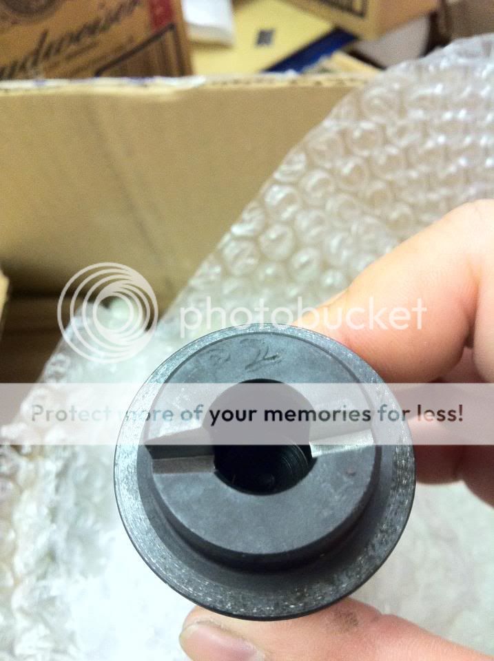

    here you go
    Attached Thumbnails Attached Thumbnails -390642_2260608046520_1587990542_1572427_368946014_n-jpg
    TDC Performance
    Mobile, AL
    KiLLa K
    acworth
    106
    damn pt... beat me to it...! ^^ balanced ,blueprint, stock sleeves -re hone
