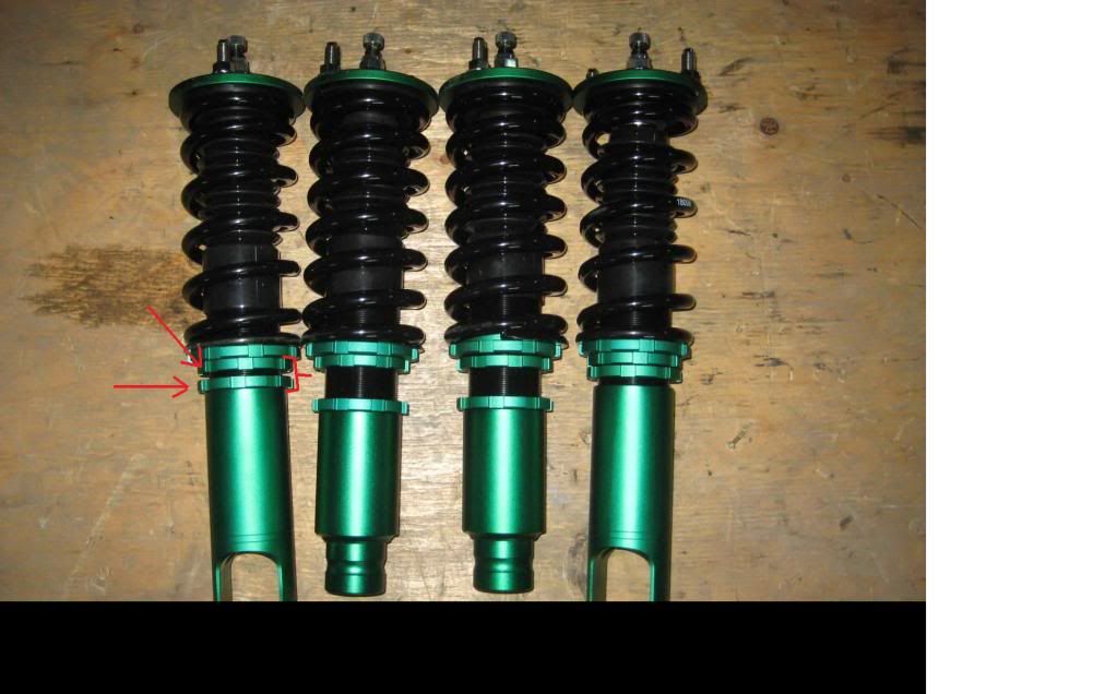

    remove the collars if you havnt already. thats how people go super low.
    Columbus GA
    11,435
    like so

    Yeah i used to do that on all mine haha. I know crx coil overs on eg will give a mean ass drop but ek idk

    So I remove all three rings?, is it still safe to ride around ?

    no just two main

    The Tein SS should only have 2 lock rings. Just remove the lowest one and you will get another 1/4 inch. If thats not enough, you'll need a diferent setup. I believe the Teins in the picture above are Tein Flex or higher which will come with 3 lock rings.
