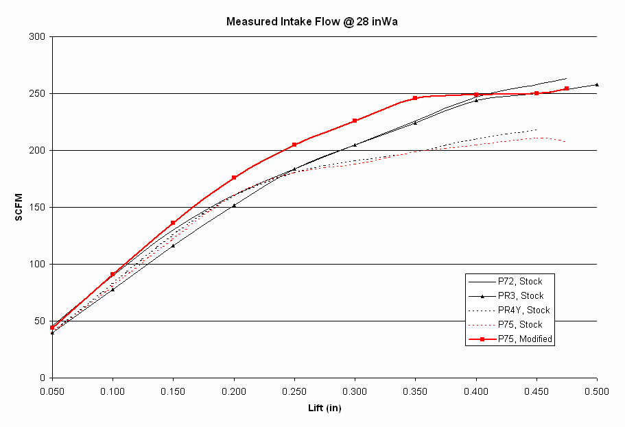

    It can see 220-230 with a stock port, mine is stock!!
    But yes;
    We flow tested a b16 and a GSR head back in the day, and they flowed the same amount... Just some food for thought

    And people want proof so here it is...

    ITR is a B16 head casting pulled straight from the assembly line, then is it hand ported ONLY behind the valves(steeper valve angle), a lighter intake valve(thinner stem), dual springs on both sides(itr intake= yellow..itr exhaust= blue), different LMA's(blue dot) and cams, That's it!!
    Honda never stamped a R on the head maybe the rails, but I doubt you even knew that, only did they put the green paint by the dizzy, so the out sides look the same...
    They have a - 1,2,3,4 next to the PR3 B16 head so ITR can be a PR3-X, 2,3,4..
    But If you wanna bet some money I'll Bring the Coupe out which has a real ITR swap in it.. I have no problem proving the differences in person!!
    Just because you don't understand what i'm writing don't mean I'm a noob, take my bet, 500 says you don't find an R on the out-side casting of this ITR head in the Coupe(95 ex).
    Pics for those who don't know!! ITR port work, yes it's an ITR head.. PR3 casting!!
