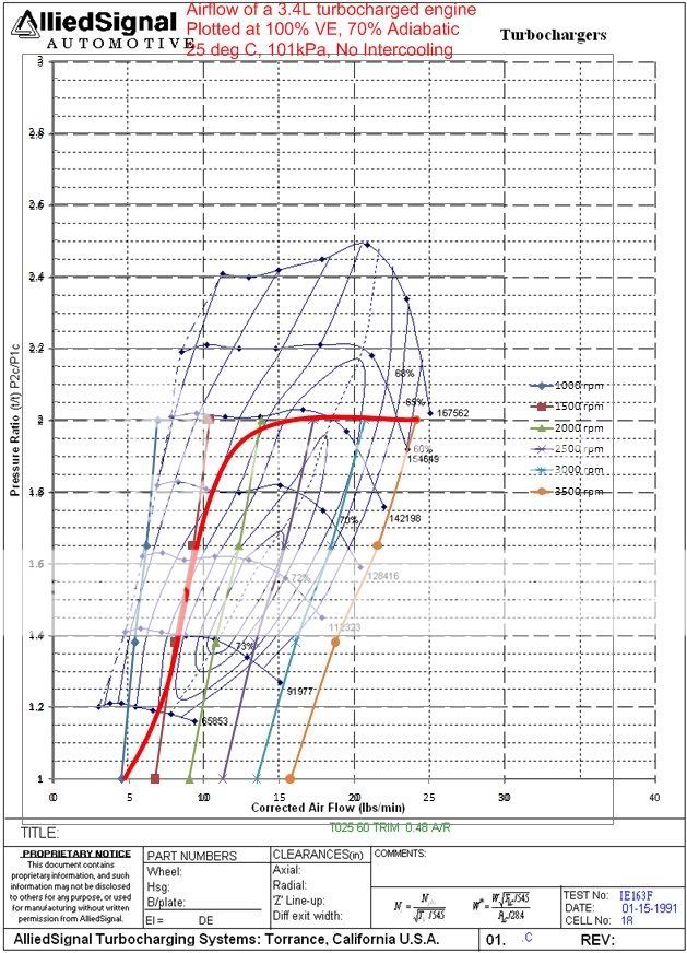

    So I had someone ask me the other day about an idea he had. Like the title states, he's wanting to make a "procharger" FI kit using a belt driven turbo. I actually thought it was a neat idea.. but was unsure if it would really work. His idea is to replace the turbine housing and wheel with a pulley, leaving the center section of the turbo and the compressor housing/wheel in tact.
    I ran through some numbers and tried to come up with an estimate of how quick he could actually get the turbo to spin. Assuming that the crank pulley is somewhere around 7 inches in diameter or so (and lets say that the engine is spinning at 5,000 rpm), I came up with that if he could somehow find a blower pulley with only a 1 inch diameter, he could get the turbo spinning around 37,000 rpm.
    He said he has a small turbo.. so I'm thinking maybe a T25 or something. I looked up a compressor map for a T25 and found this... (just ignore the engine rpm on here)
    I'm definitely not a pro at reading these maps, but from what I see, it's taking around 65,000 rpm from the turbo to flow 5ish lbs/min.
    So Basically what I'm thinking is that this idea wont work?.. Or do you think it will give some/any kind of hp gains?

    Yea, that idea doesn't sound very good. If it would have worked well, I'm sure manufacturers would have been on it a long time ago. I'm curious what he's trying to accomplish? By the sounds of it he can't run a turbo setup, but is trying to do a procharger setup on the cheap? If he's trying to be cost conscience and doesn't have the room to run a turbo up front, why not a rear-mount type setup with that turbo? It would be a lot of piping, but such a small turbo it should spool a lot better than trying that hybrid turbo/procharger.

    I think he's trying to accomplish the absolute cheapest way to boost his car.lol But I agree, if a design like this would work, it would be in production. A rear mount setup would probably be best for his case. I'll suggest that to him.

    It isn't nearly as outlandish of an idea as you're making it to be.. and I have no idea why you are.
    Flowing at least a few psi using a large enough difference in the diameters of the pulleys, along with a good sized compressor housing, is attainable, just not practical. I can assure you my mechanical understanding is sound... probably more so than the majority of people on this site, including you.
