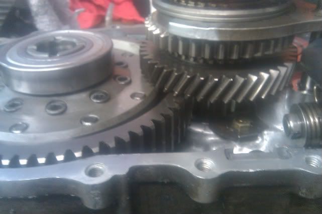

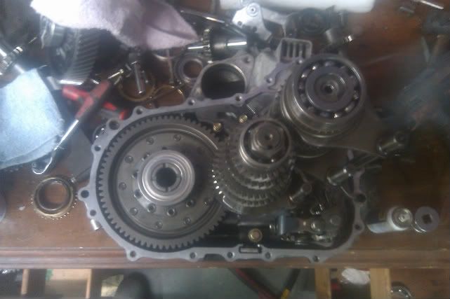

    Default finaly got my tranny put together (pics)
    b16 first
    b16 second
    b16 third
    gsr fourth
    ls fifth
    obx lsd (with quaife bolts and washers)
    4.9 final drive
    252plus hp and 34.5 miles to the gallon all motor. 12.2 at 111

    what are you revving to with that 4.9?
    TDC Performance
    Mobile, AL
    SOUTHERN SPEED
    macon ga
    2,159
    I set everything up for around 8,500 rpms. Im running a pretty big stroke so not sure ill be able to revee any higher then that. At 8,500 rpms with 24 inch slicks i can trap 118 mph with the gsr fourth gear. Thats why i changed to the gsr fourth instead of the b16 fourth . I dont want to change to fifth in the quarter mile. I have a couple more final drives but i think this one will be just right . If not ill change things around a little bit.

    Well i decided to tear my tranny back down lol before i ever put it in the car . After talking to james i decided to go ahead and put all new syncros in it there on the way . Im going to threw it in the car on the stock b16 motor and see how it does so i will know its ready for the beast when im done with it.

    Now i just need to pull it back apart and install the carbon syncros that just came in lol.
