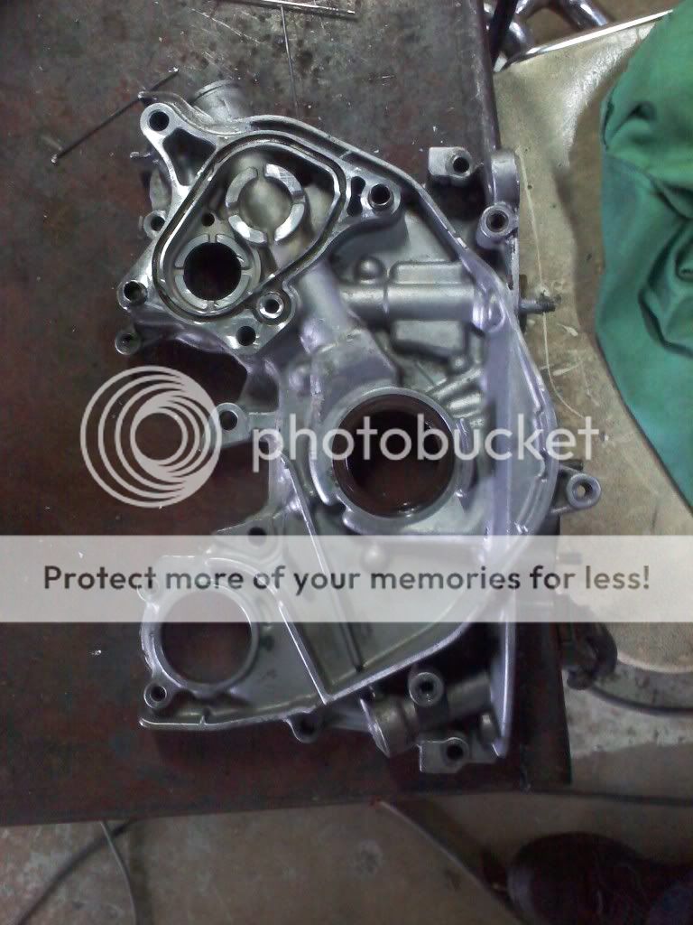

    What would be some things that have to be done to make it a safe build. I'm planning on boosting an F2OA SOHC NON-V. Pretty much in the same boat as Chaseamundo. Only difference is I want to build the head, rods/ pistons an remove balancer shaft. Well I guess I'm not in the same boat. LOL.
    Didnt mean to thread jack.

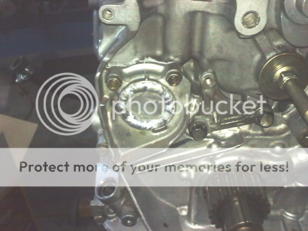

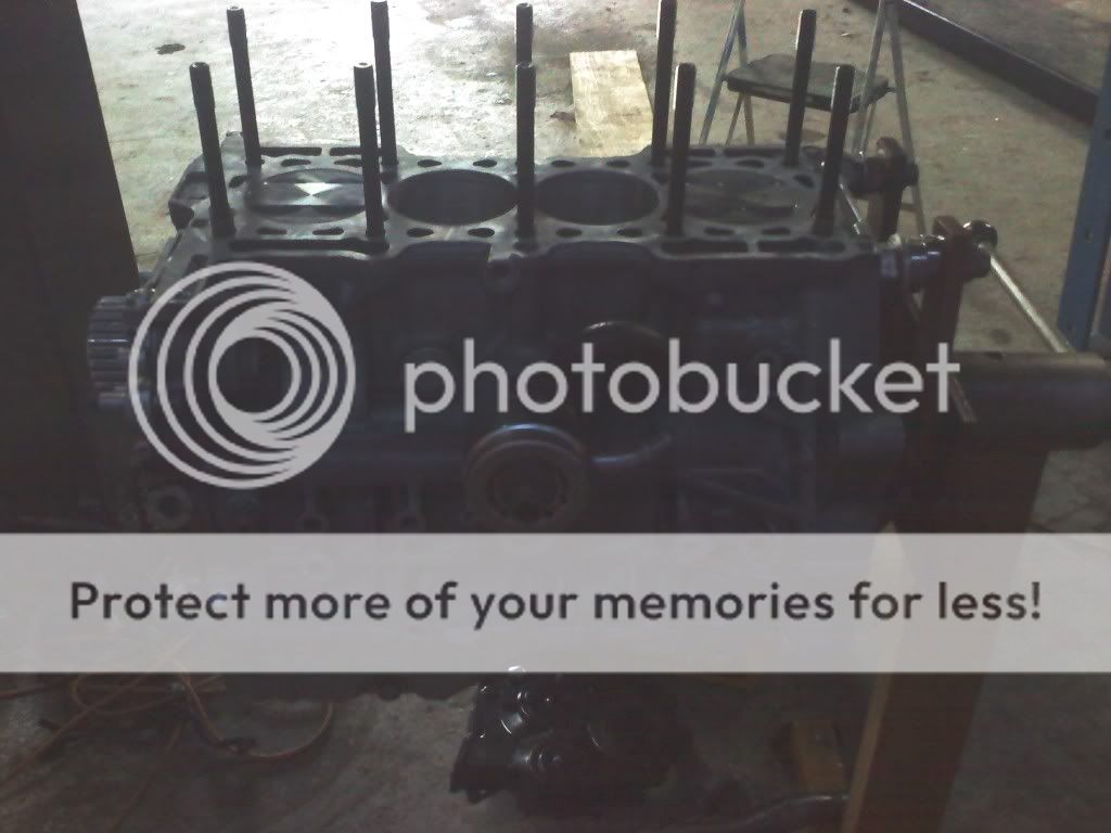

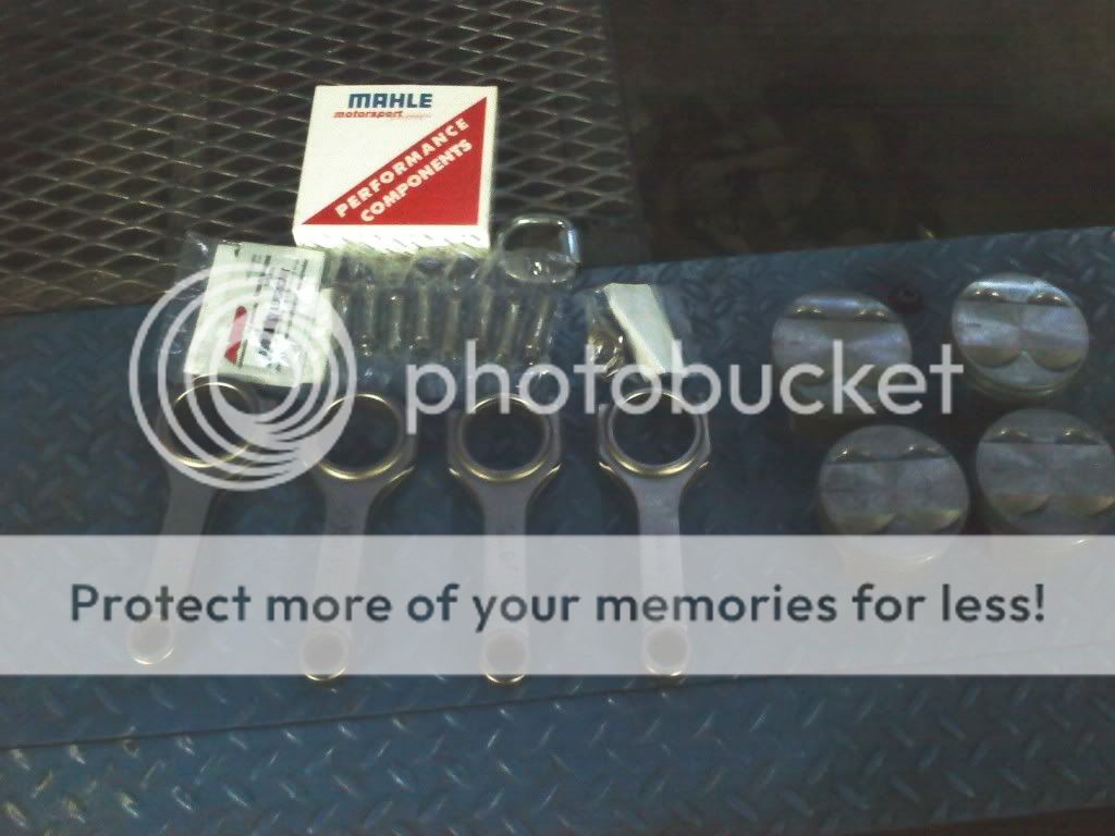

    This....
    Mahle Pistons/ Eagle Rods
    Installed
    Headstuds
    Balance shaft deletion. This mod helped the engine loose close to 12 lbs in unneeded weight. 1lb was straight off the crankshaft.
    500whp of spinnin fury!!!
    KNXWLEDGE EssexCounty's Avatar
    South Side
    364
    Is this a kit or custom fabbed..?
    IA Sponsor JJSPEC Racing's Avatar
    www.jjspec.com Macon, Ga
    1,619
    Quote Originally Posted by Looney Tune View Post
    We welded the balance shaft holes up.
