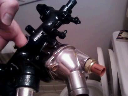

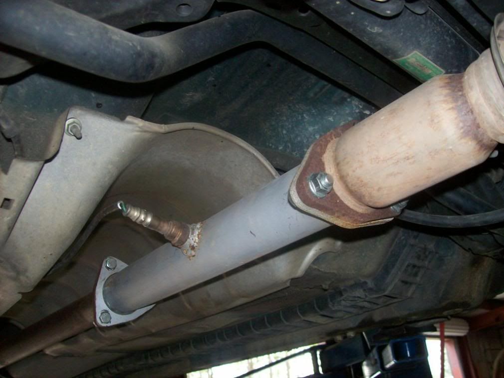

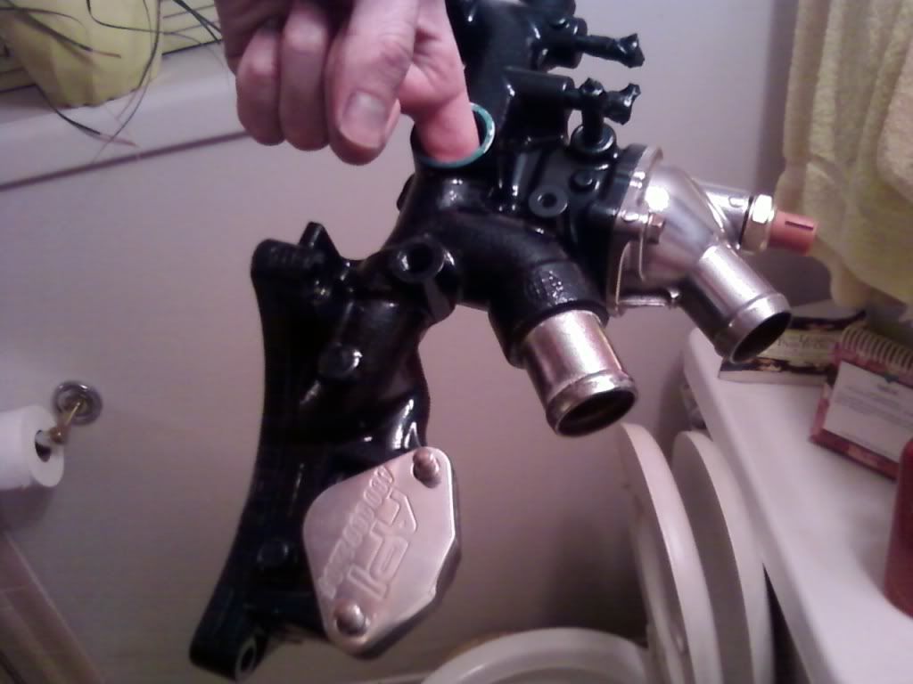

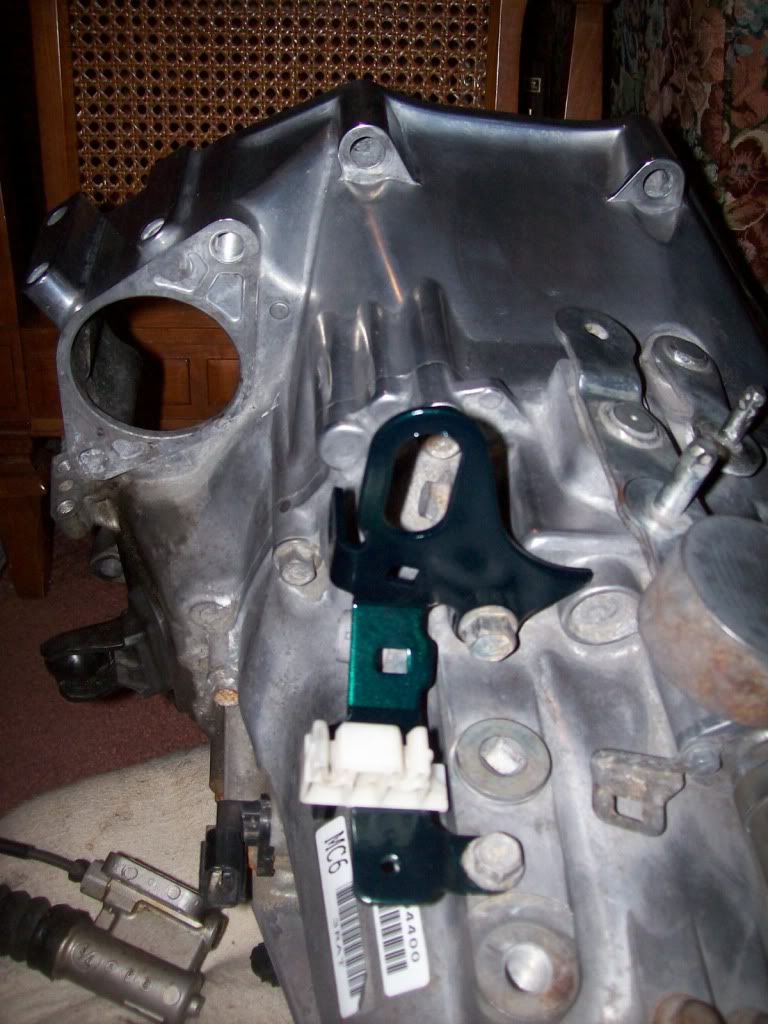

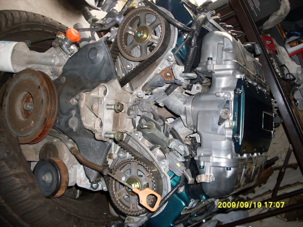

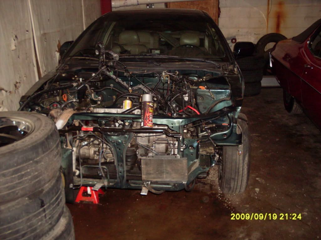

    I have my own thread on v6performance.net but i thought I would post one in here. I have a 1999 Honda Accord EX coupe. It came with a J30a1 but, that motor is flawed so i stepped my game up. I thought "Hey, a huge J35!" ,but i was like i need stronger internals and plus the Type S motor is more suited for boost. So i am almost done swapping A J32a2 into my car with an 03 Honda Accord Manual Tranny. Since my XS power Turbo Kit fits all J Series i swapped that over too. Here is my parts list:
    J32a2 Type S motor (auto) Auto has more power
    PnP IM
    PnP TB
    P2r TB Thermo Gasket
    Missing Link
    Butterfly Valve Delete
    EGR BOP
    Iridium 2 step colder plugs
    AASCO Lightweight Flywheel

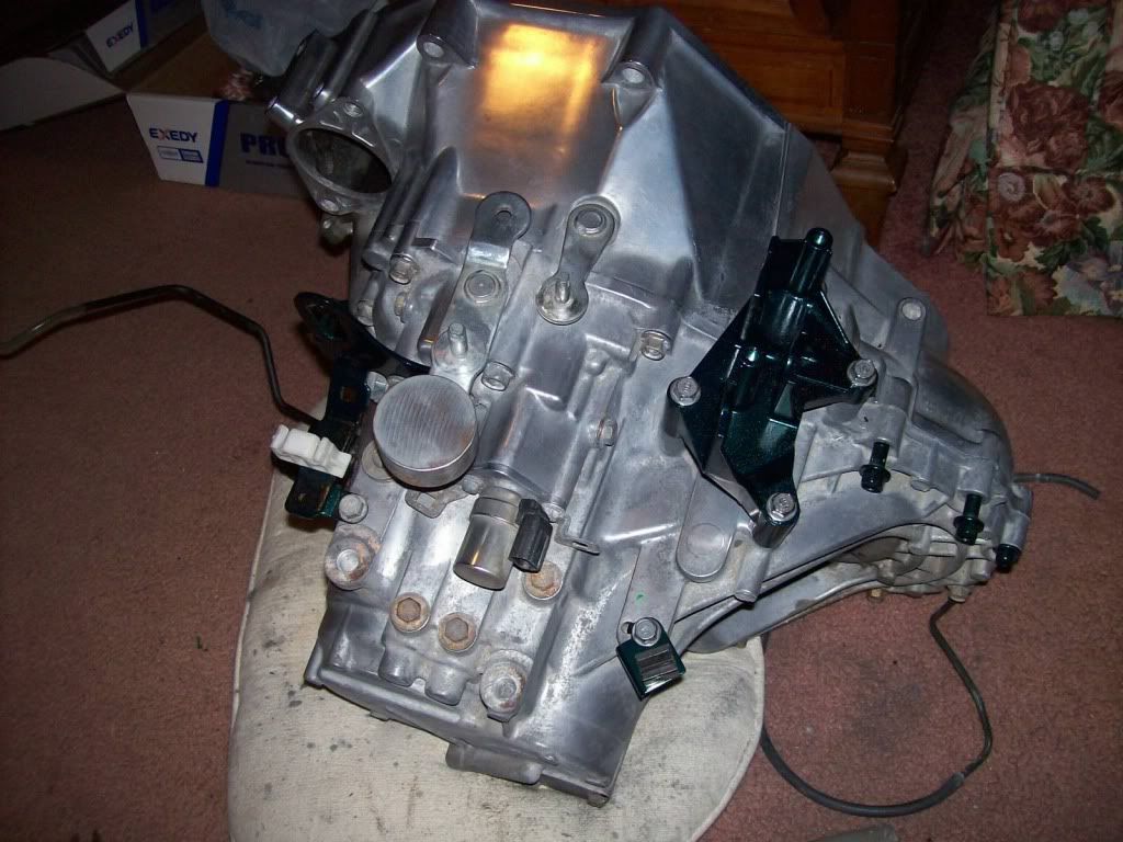

    03 Accord manual tranny
    Stage 2 Clutch and PP
    1 and 1/32 Input Shaft
    Omni Power Clutch Cylinder
    Slave Cylinder Mod
    Mishimoto 5th gen Accord Radiator Retro fit
    Radiator twin fan shroud

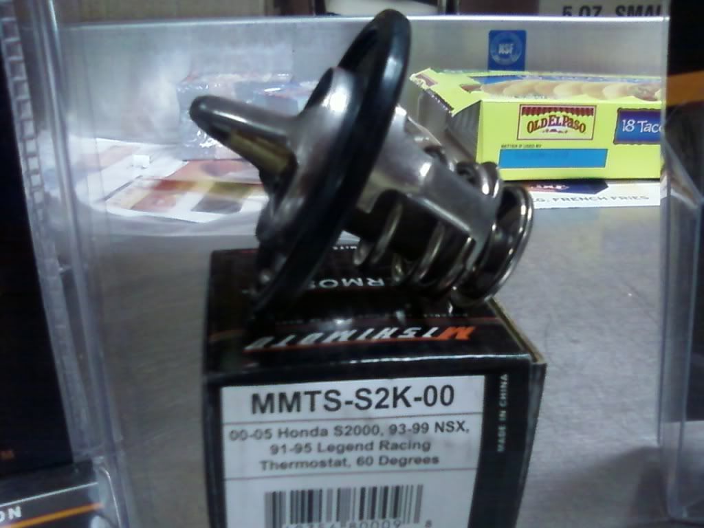

    S2K racing thermostat
    5thgen Fan switch
    1.3 bar Rad Cap
    Weapon R catch Can
    DIY Tranny Mount Stiffener
    Richie's Auto to manual Harness and ECU program
    Emanage Ultimate
    E-01 Boost controller
    Remote Switching system

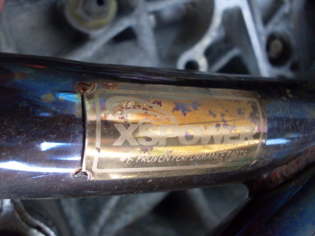

    XS power Turbo Kit
    Reversed turbo mod
    t70 Turbo
    HKS Green Filter
    Cat delete

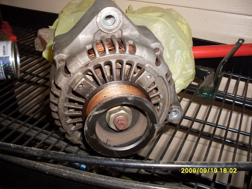

    Honda Odyssey Alternator Upgrade
    255 walbro Fuel Pump
    3inch Catback

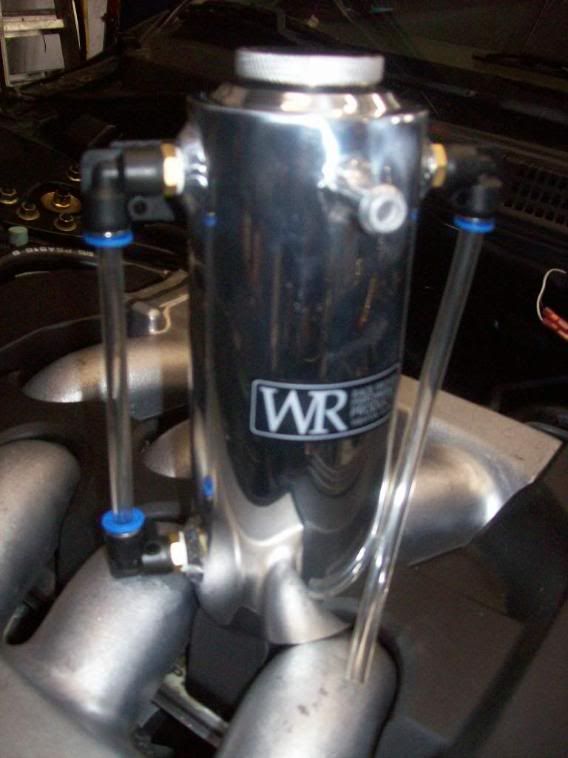

    Magnaflow turbo resonator
    Evo 2 Tip
    NRG weighted shift knob
    Header wrap
    Dry Shot NOS kit

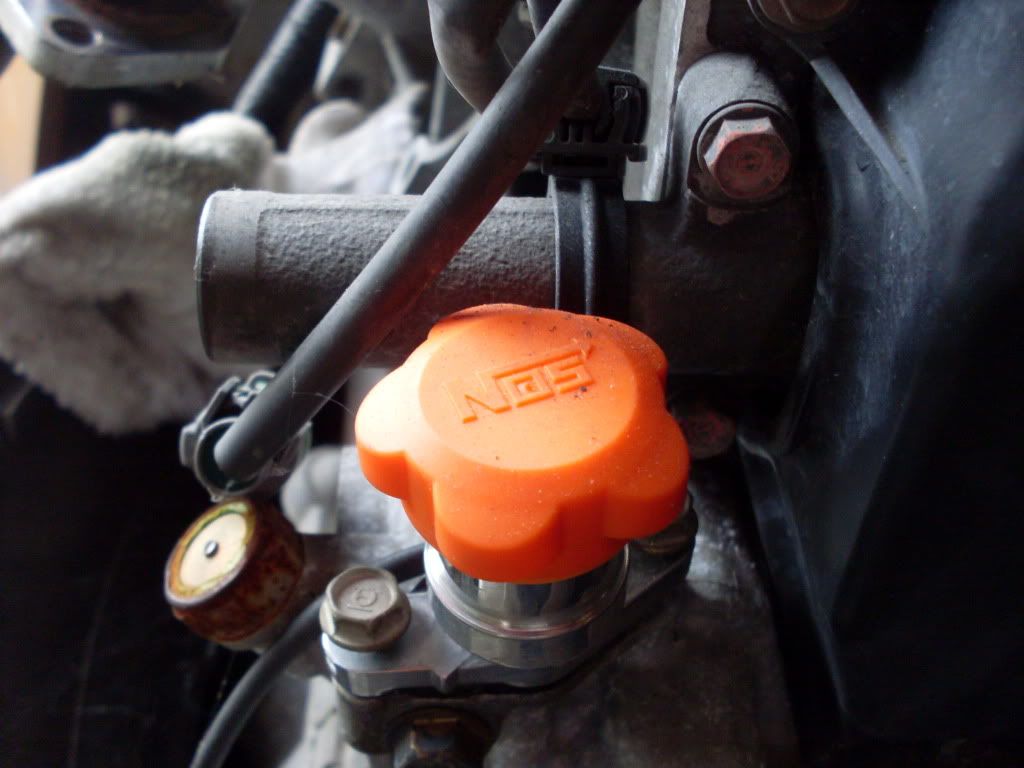

    Oh and a NAWZ cap on my VTAK solenoid.
    More parts will be added as i get/remember them....

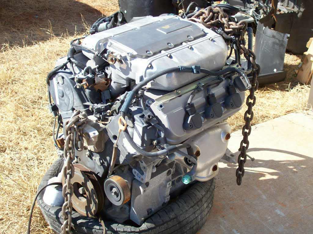

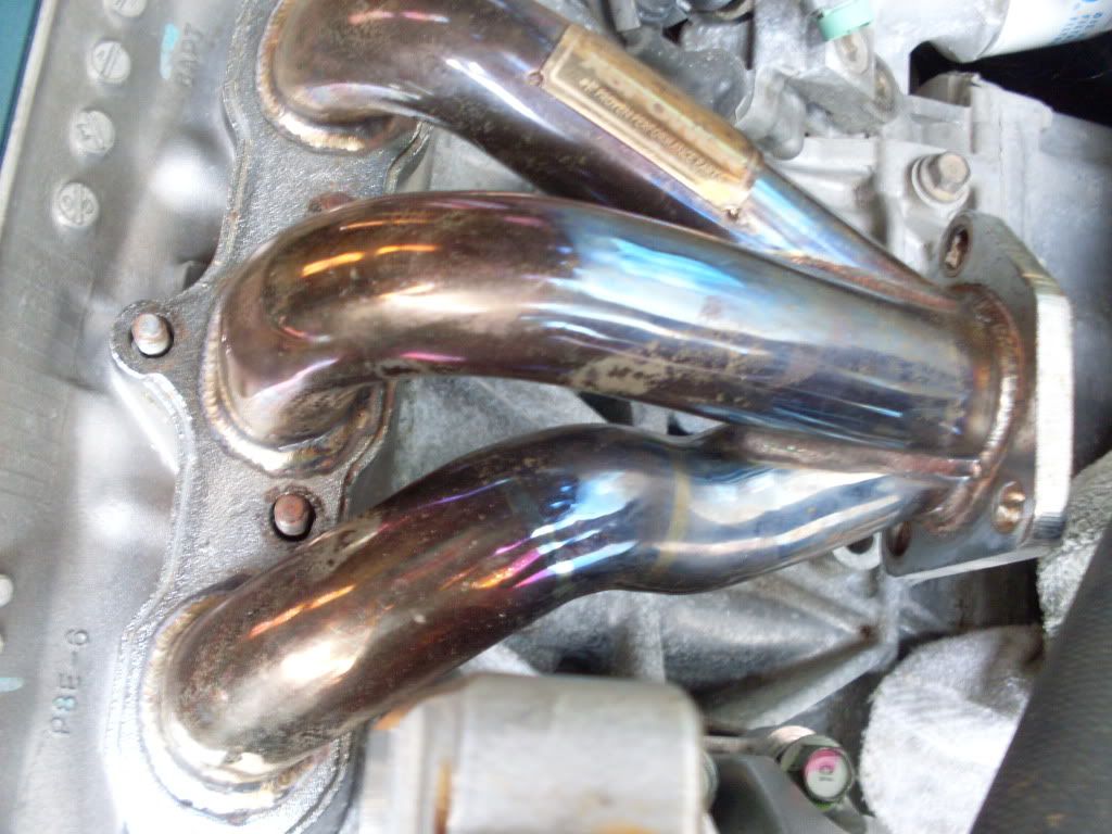

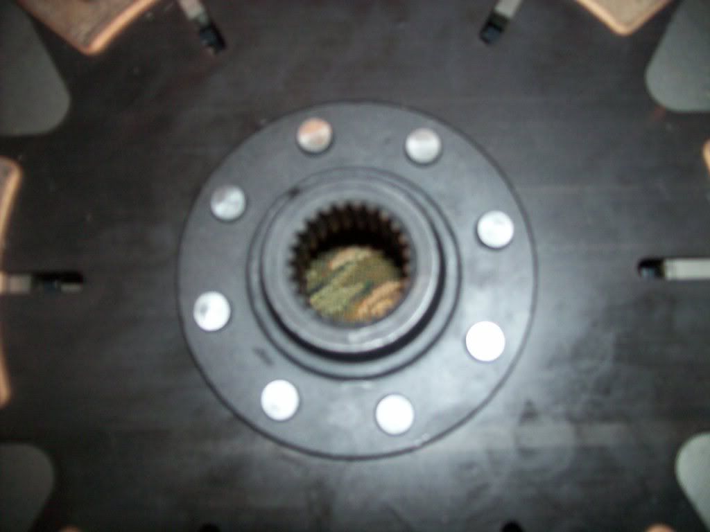

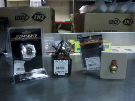

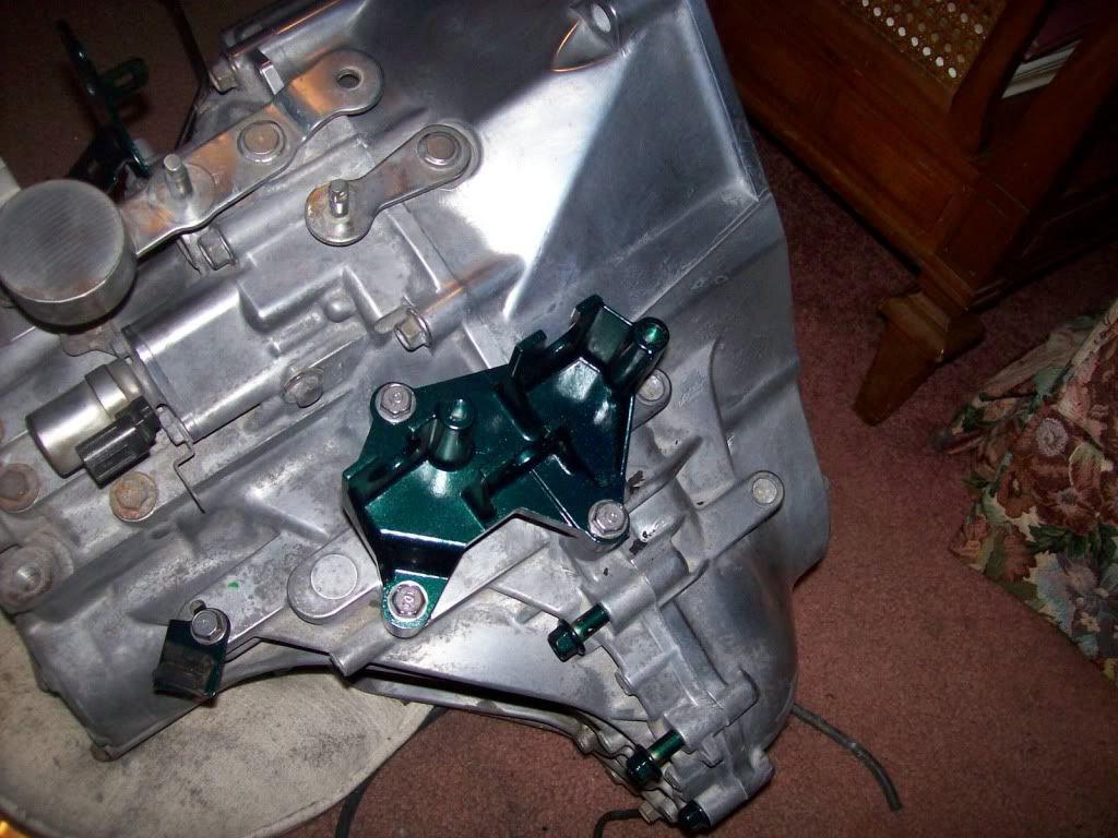

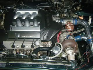

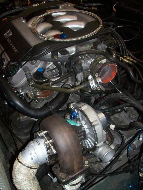

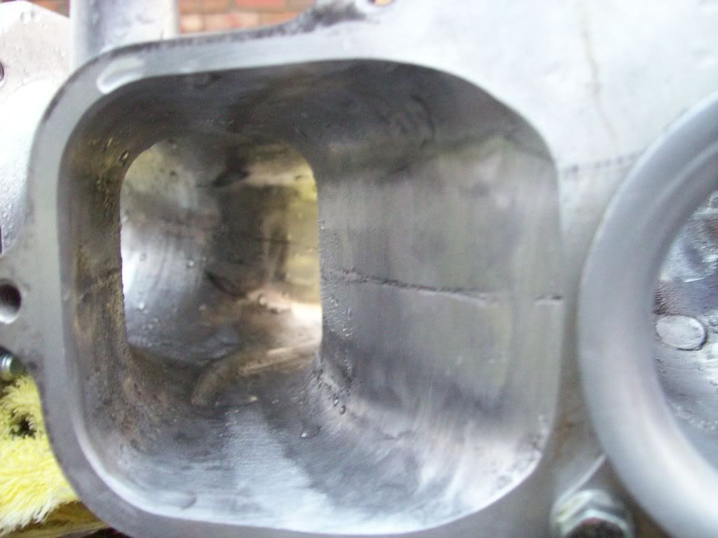

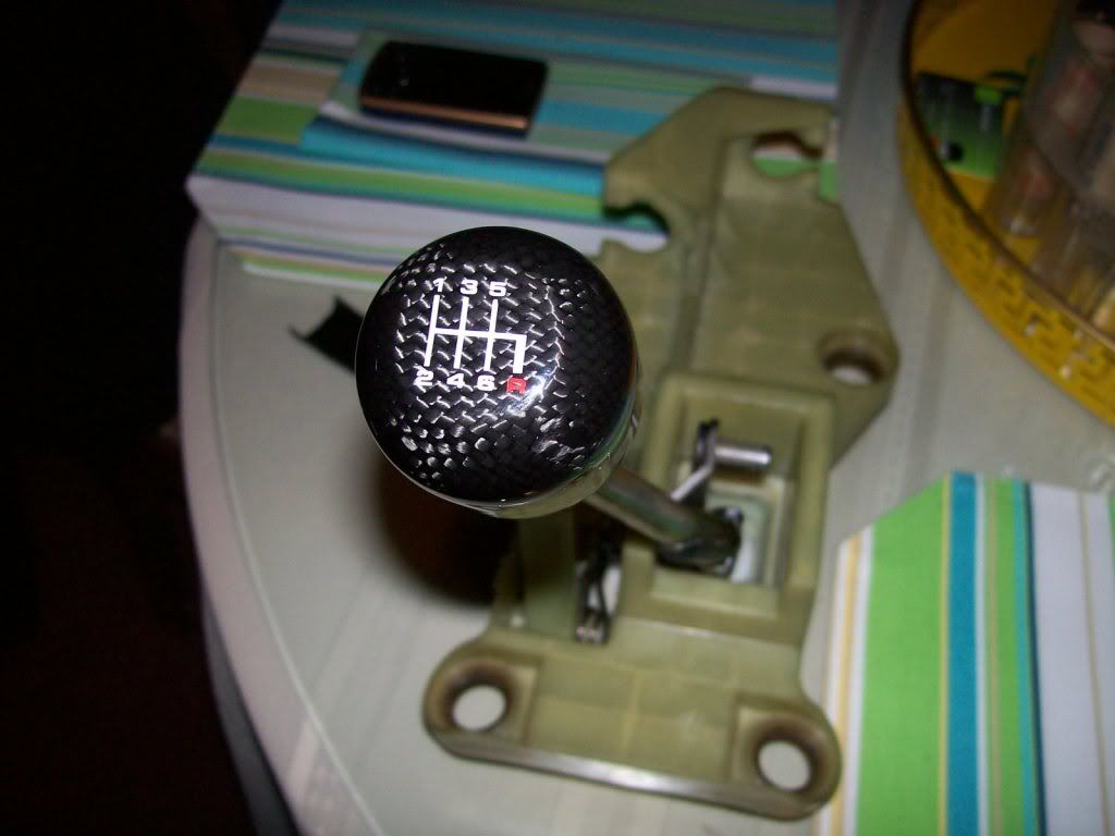

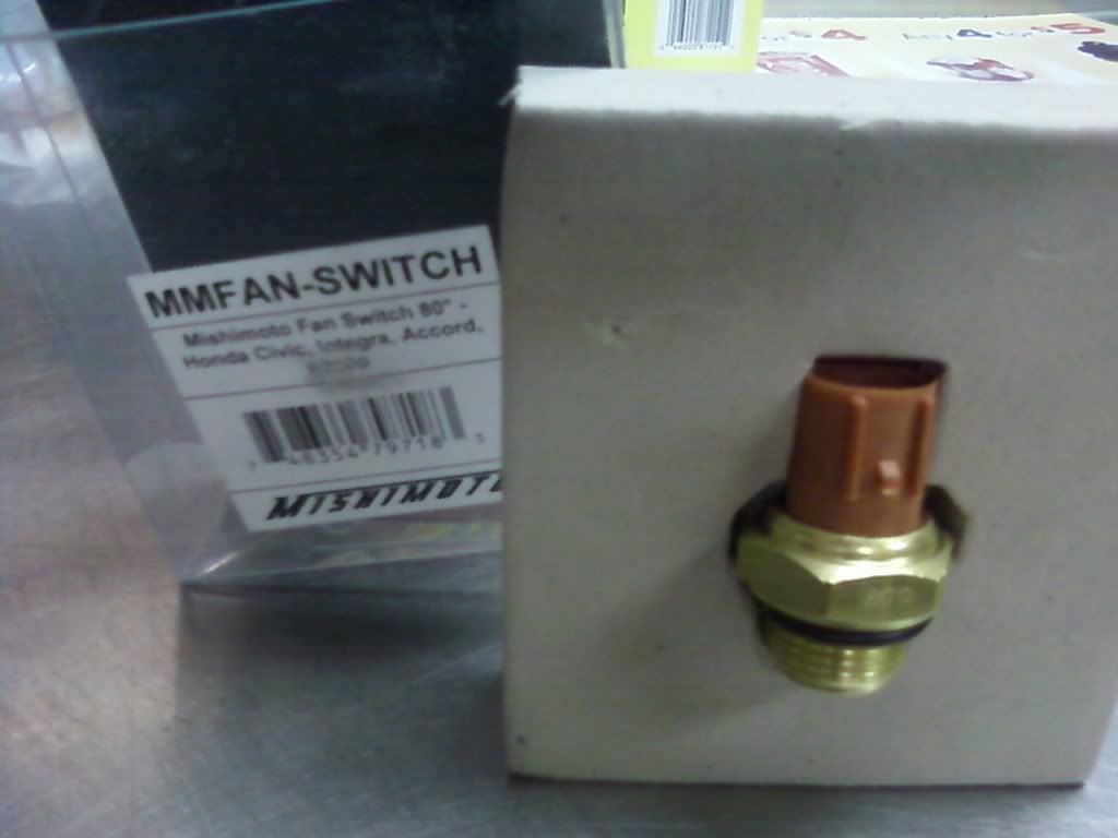

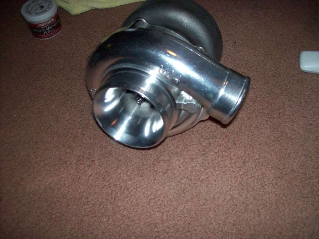

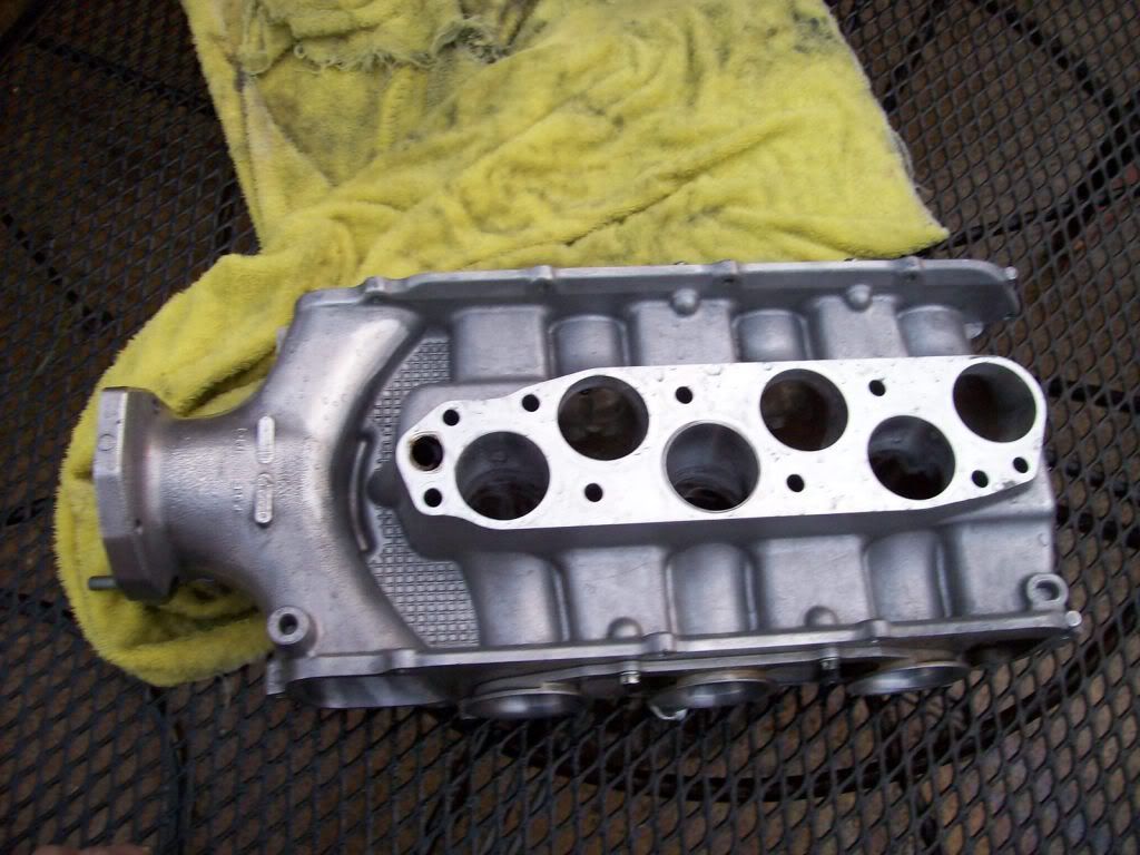

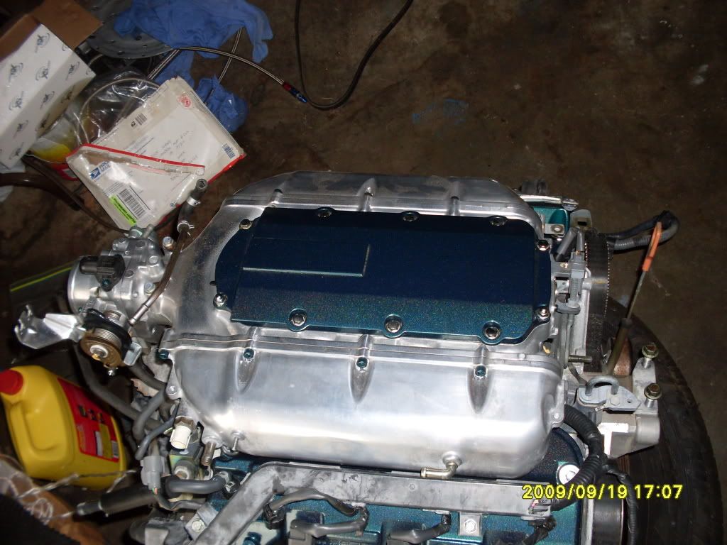

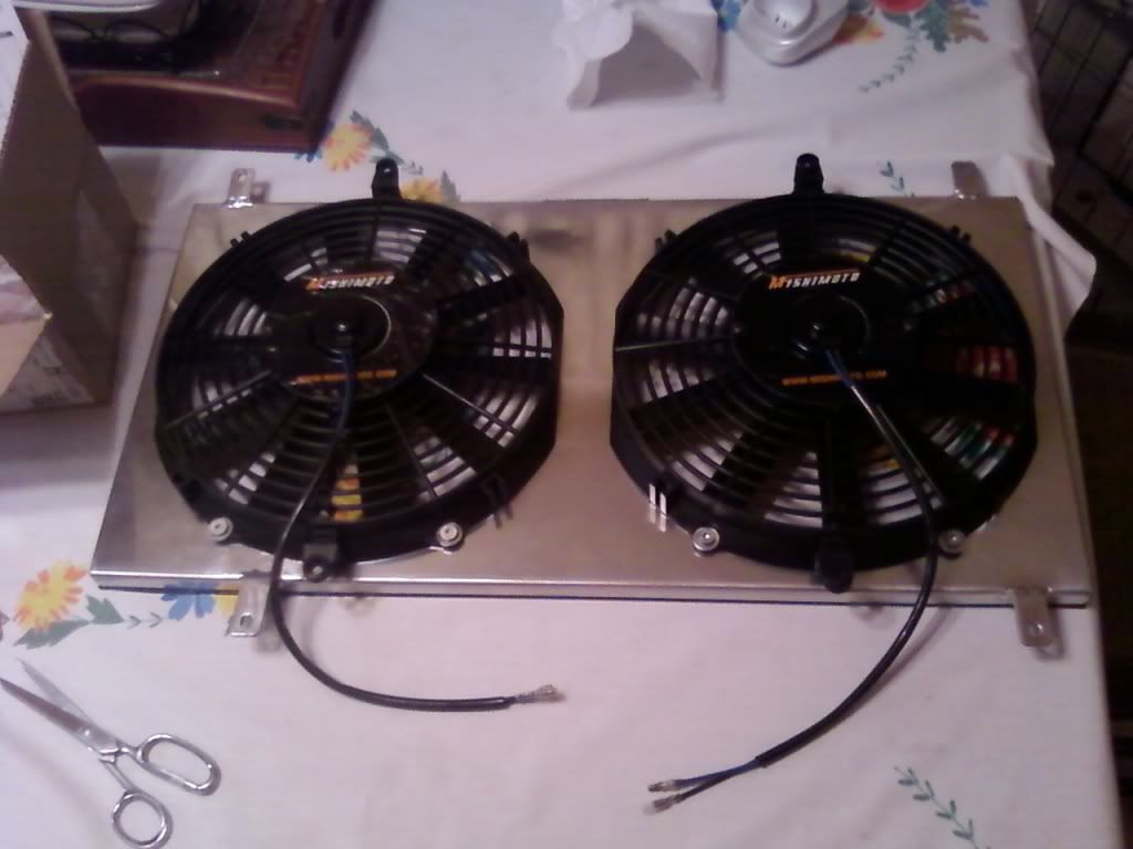

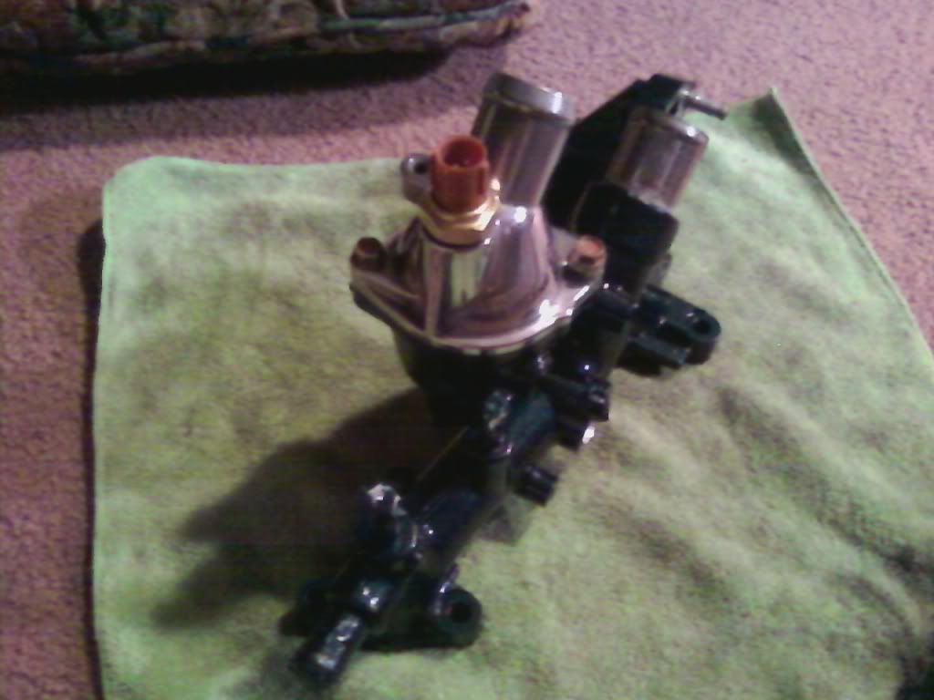

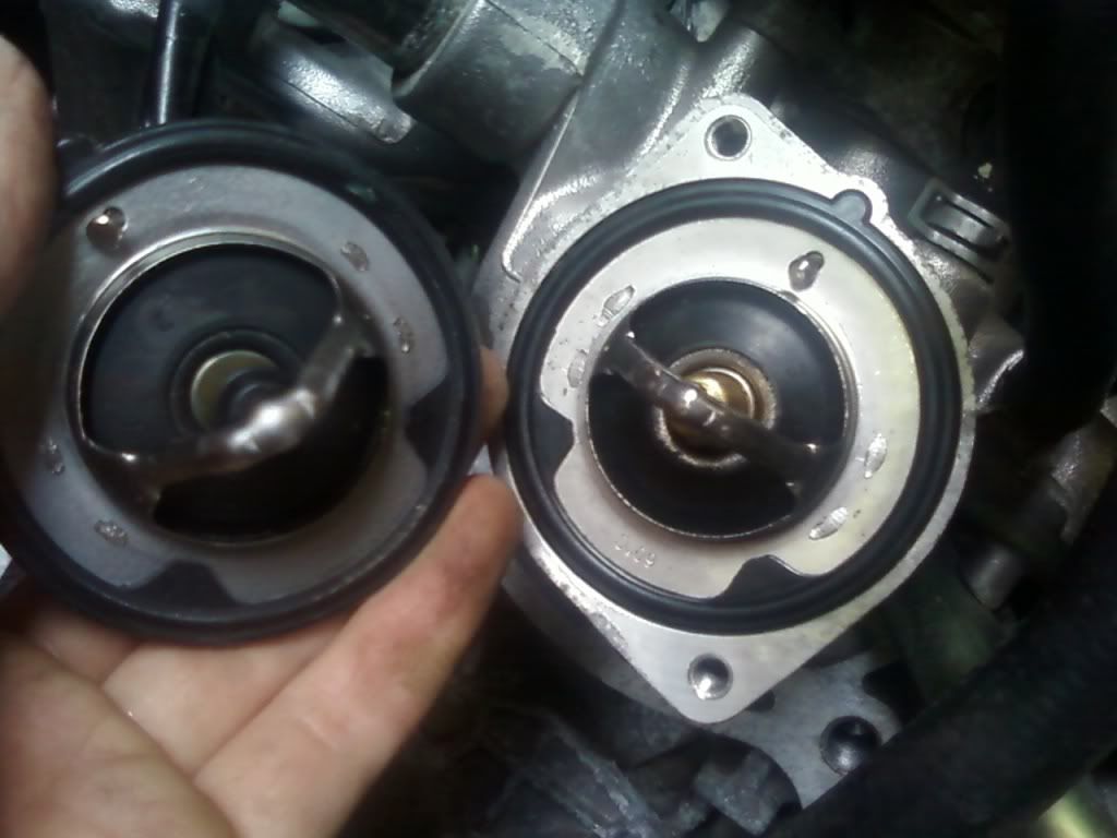

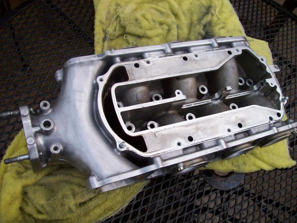

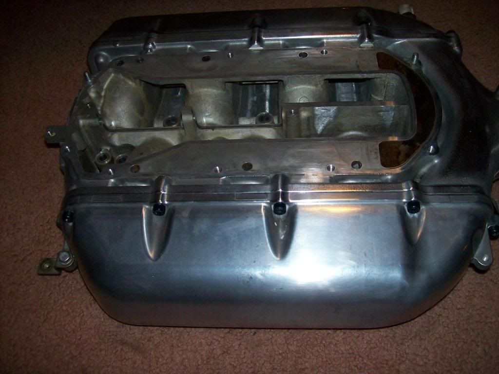

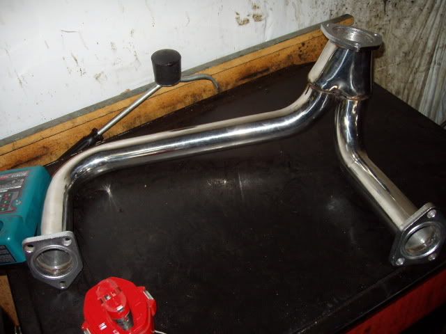

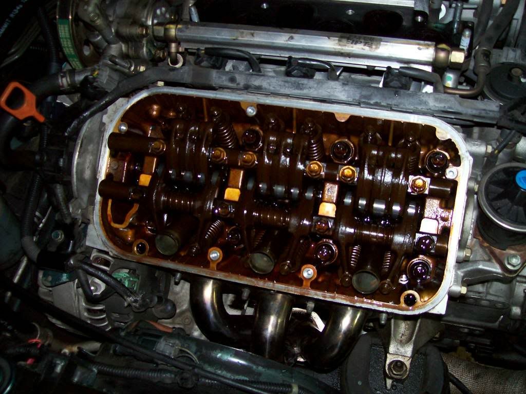

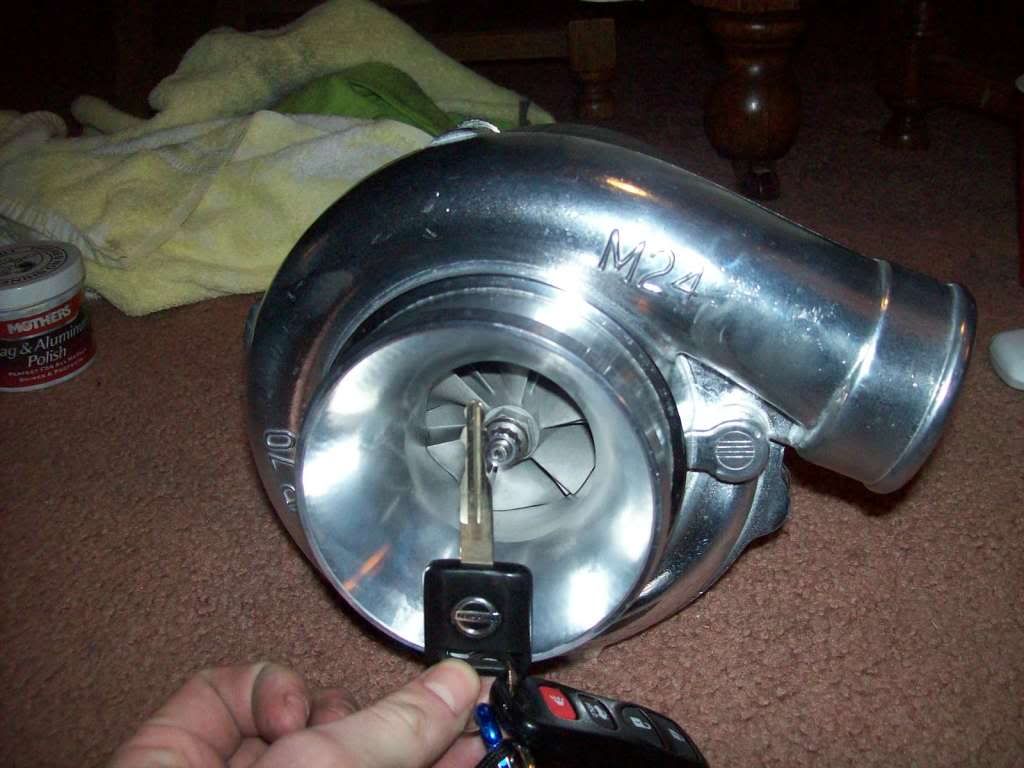

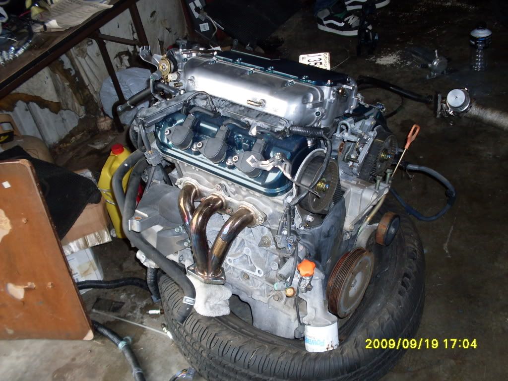

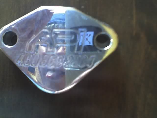

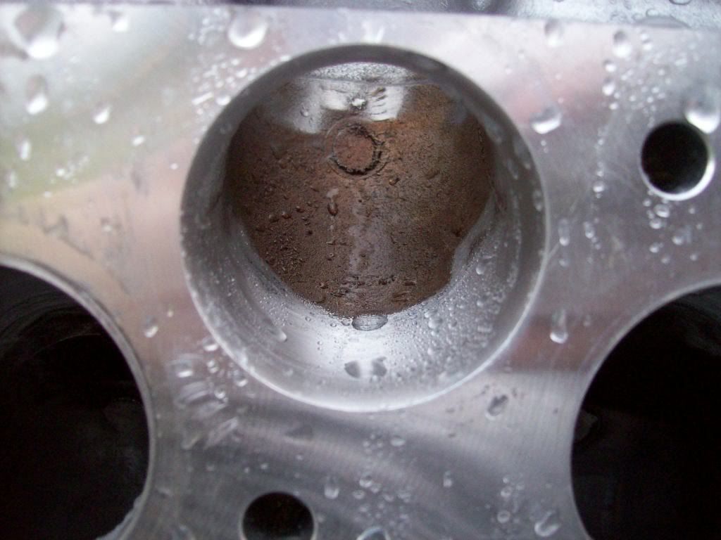

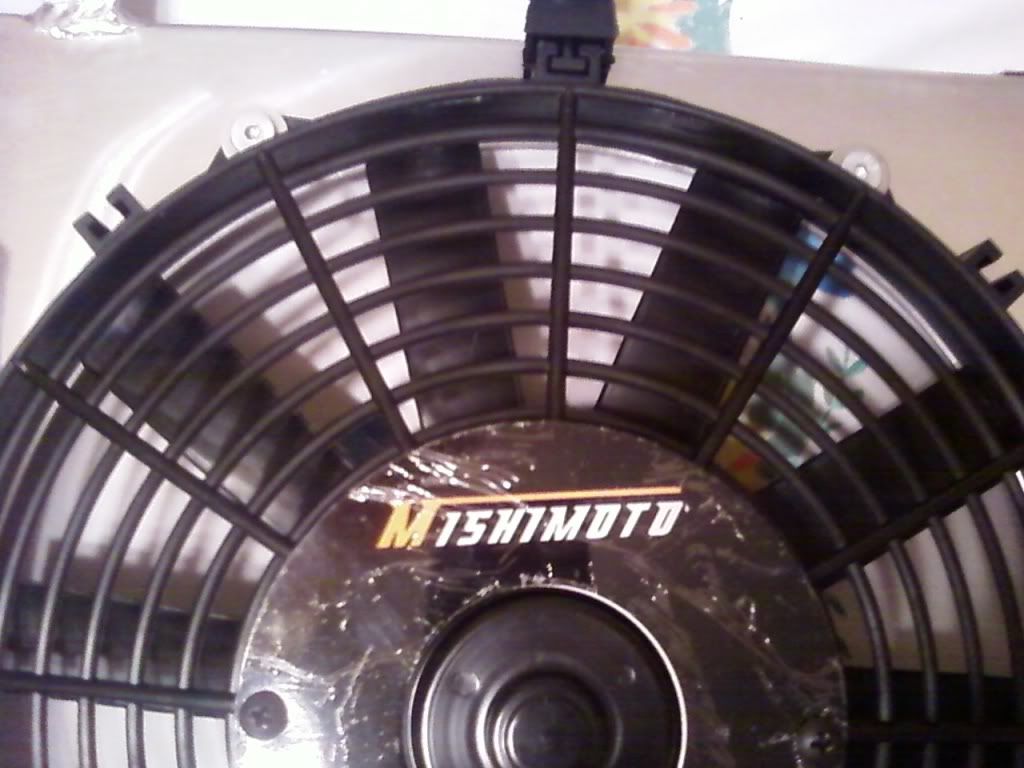

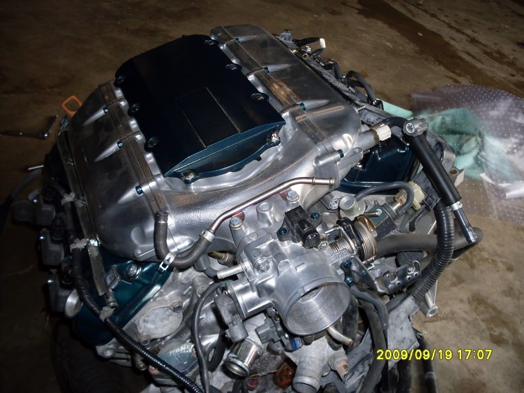

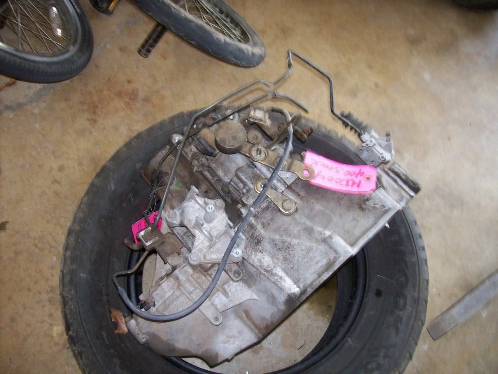

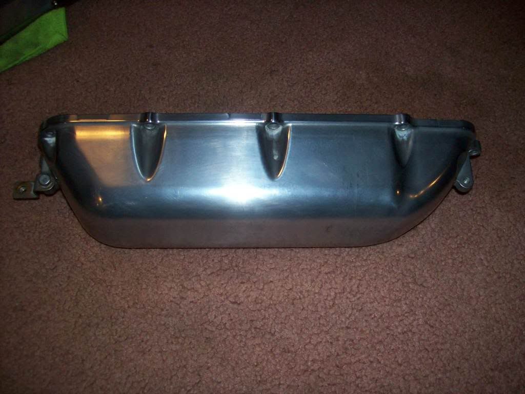

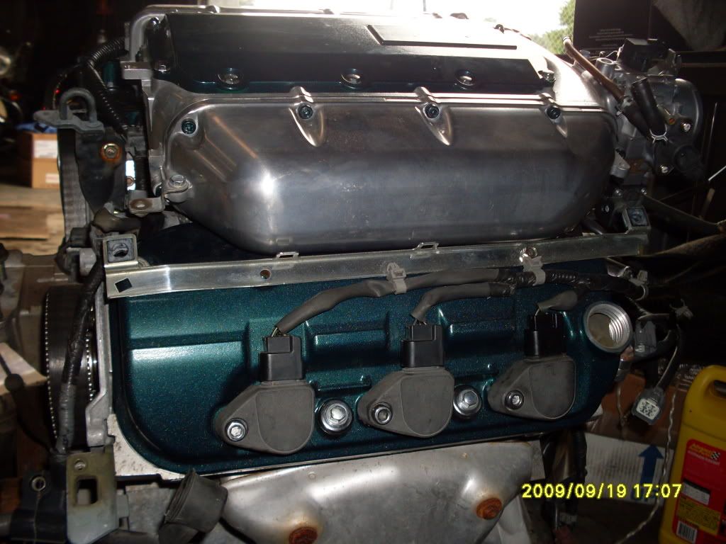

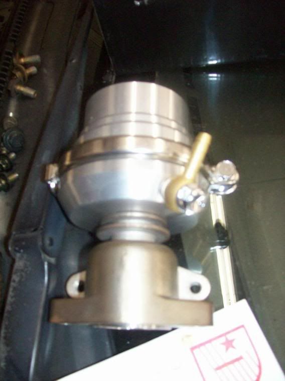

    Ok here is some of the build pics...
    I started with

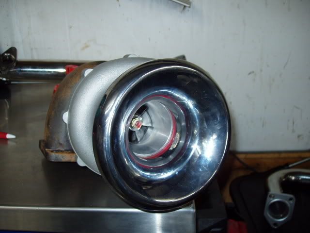

    then the turbo kit

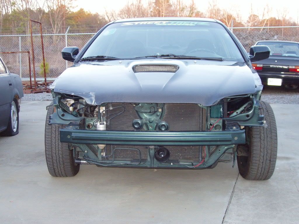

    Then the shitty Hood for when it rains (notice nothing on the front end is actually bolted on just the headlights.)

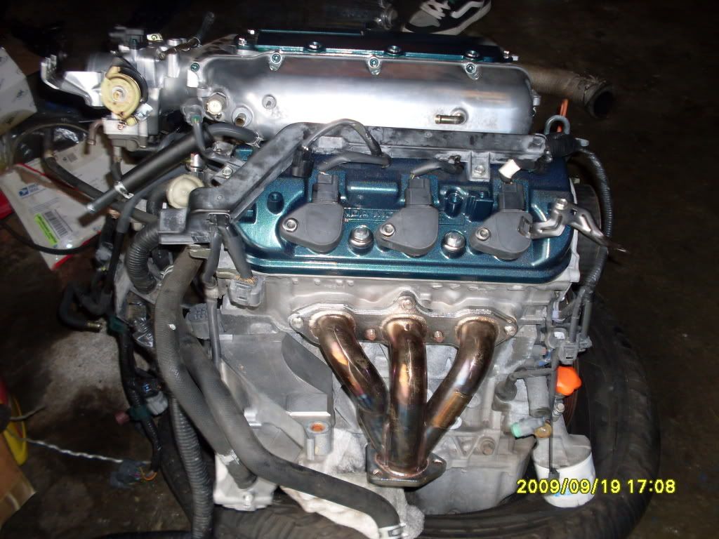

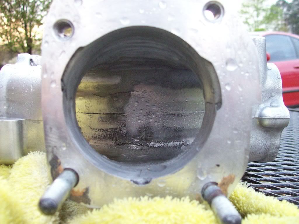

    Then the J30 SHAT on me

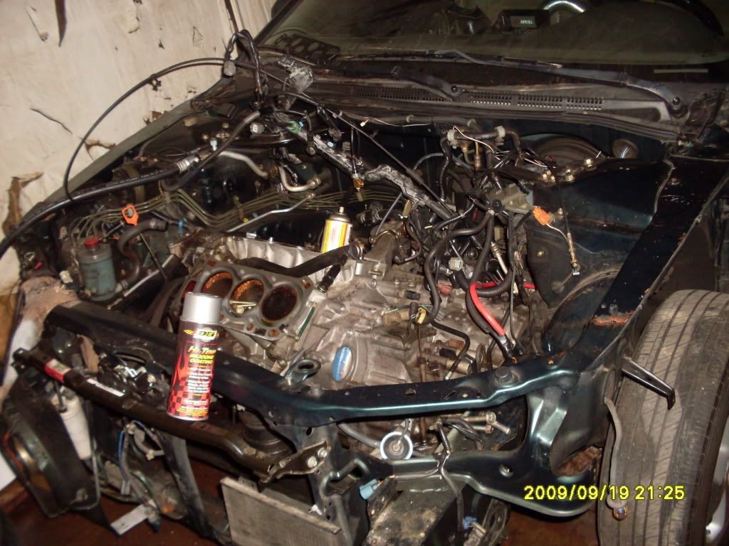

    Then i stepped my Game up
    Mmmmm Frosted Camshafts
    more pics as build continues.......
