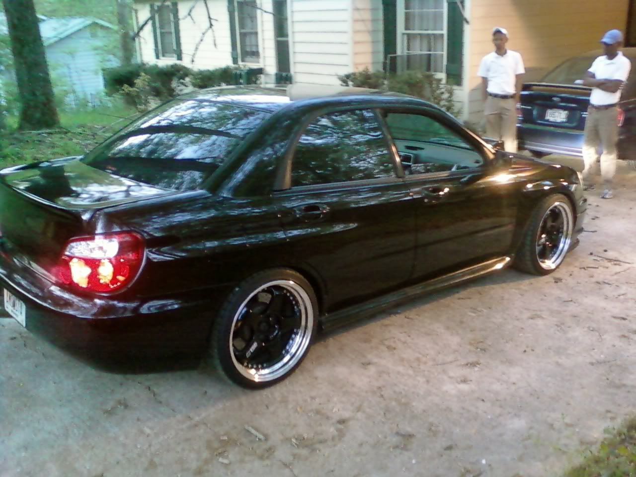

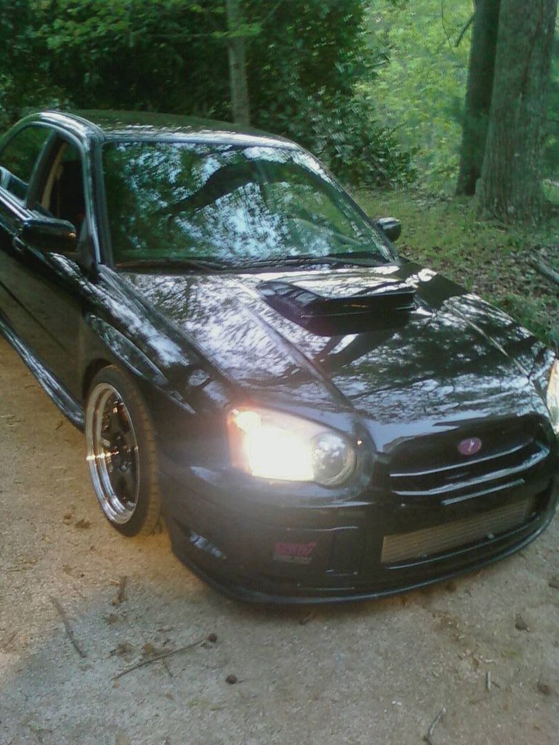

    Finally got some pictures today while doing a check up on the car. Still going strong!
