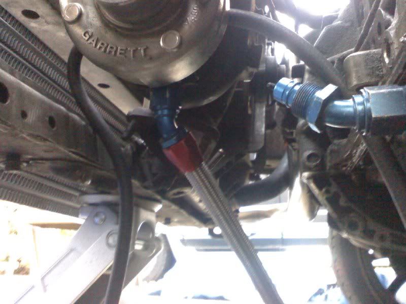

    damn, rain prevented me from working much so i couldnt get any good pics. tmrw morning if its nice outside. But i got some questions:
    Does it matter that the oil drain pipe is horizontal or has a dip in it.. or will pressure keep the oil moving?
    Also, on my radiator i have 2 tubes coming out from the bottom.. im not sure what they're for, but i was thinking of hooking up the water ports from the turbo to them if it flows through?
    .. sorry im new to all this, but reps for help!

    the oil drain need to be perpendicular to the ground, it doesnt have "pressure" it just flows with gravity.
    and that line on the rad if for a auto trans cooler. i wouldnt hook it up.
    Save ur engines!

    Not 100% sure, but I don't think you have to use the water. The oil alone should cool it just fine.

    ok so still didnt get much work done with the intercooler piping, but im havin an issue with the oil drain.
    not sure how im going to get it perpendicular to the ground :\

    I'll get you some pics later today. From what I am looking at, you turbo really needs to be turned around. The DP is keeping you from getting your drain line right and radiator is preventing you from getting you intercooler pipe on.
    If its just the pic and the dp isn't in the way just turn your fitting back a 1/4 turn.

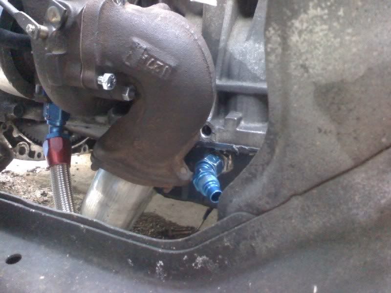

    haha so true. I actually did that the first time around, but the way the downpipe was facing made me think that it could only face one way however, i just turned the turbo around, and with a little cutting its looking ok.
    Its hard to tell from the pics, but the oil drain is still somewhat level to each other, and i need to get a new downpipe made . Does anyone know if it is ok to ride like that just until i make it a few miles to the exhaust shop?

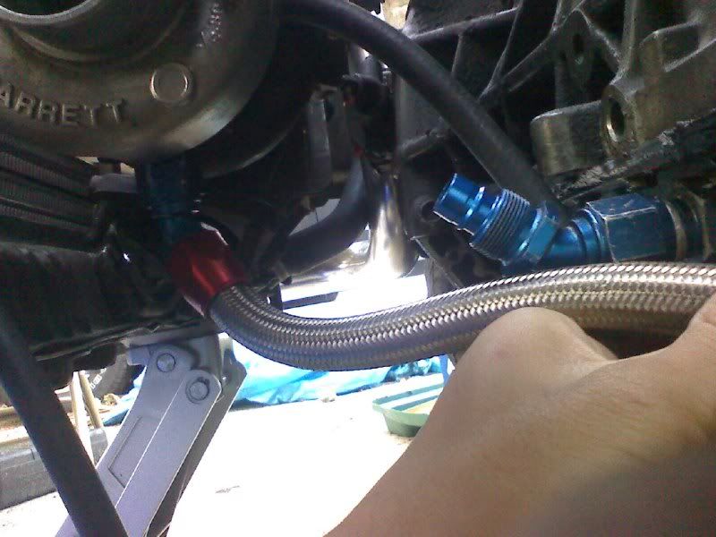

    here's a better pic showing it, if i actually connect it, its going to have a dip in it

    Looks like if you put a straight at the oil pan you may be ok.

    yeah, put in a straight fitting.
    also, dont drive it without a downpipe.
    just mock one up and have it welded later.

    As said above....a 45* coming out of the turbo into a straight fitting.

    eh, as long as u have a 02 sensor in the DP, u can drive to the exhaust shop. dont get on it tho cuz of the lack of a tune.
    but the drain, like they all said, a straight off the oil pan will prob work.
