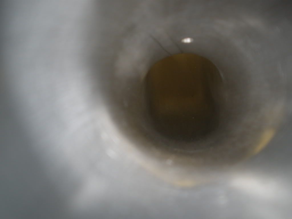

    We finaly put the new head and intake on and got it tunned again last night this it what it did. It still has a stock throttle body and stock intake that has been ported.

    this is one great build. i was impressed as soon as i started the first part throttle pulls. it ran out of stock injector around the high 230ish range and made high 240ish with injectors totally leaning out.
    bore out the stock tb and open up the exhaust and it should pick up another 5-10 easily.
    did you drive it on the street yet? how'd it feel?

    I have a shop in macon but i dont pay to avertise on here so i dont think it would be fair to condone buiseness on here but im sure you can get my number from somebody. It is not a real exspensive build still old ass skunk 2 stage 2 cams just alot of port work done to the head and intake. My dad has 40 hours in the head.
    h23 crank
    golden eagle block
    cp pistons 88 milimeter
    h23 crower rods
    stock ported h22 intake
    stock throttle body
    ported and polished head by my dad
    kidd racing header
    rc 550 injectors
    aem cam gears
    cc the motor its 12.3

    Well my dad just wanted it to look stock under the hood i had a skunk 2 manifold and throttle body on it when it was in my car but when we put it in the hatch this is just the way he decided to go .If we had all that stuff on there and pro 2 cams everybody would say well thats what it supposed to make so we decided to do things a little different. This is my dads daily driver not a race car we was not trying to make this much power dont get me wrong the motor is done right i can tell you the cc of every chamber on the head and alot of time has been put into doing it right with parts we had laying around . We could have got the same compression with type s pistons but they wouldnt run in the sleeved block thats the only reason we changed them. The cams came out of jason wallaces motor three years ago. ive had the rods for four years somebody ordered the wrong ones and i ended up with them not that these arnt nice parts but if we was trying to build this monster motor and buy new parts these would not be what we would have bought .its just a budget build on what we had that turned out pretty impressive if you ask me.

    We have several different intakes that we have done and this is just the one we found that works best for this motor .The webbing is cut down pretty far on the one on this motor.

    I didnt know the intake was all slicked up too, I just assumed after doing 40 hours on the head he might have left the intake alone to add an RBC or something else later on. I believe the intake still has some power left in it too. When you say stock TB, is that the little 55mm thing or 60? My stock intake entry and TB were 56mm for some reason. Maybe mine is just an old H22 intake? Its all 65mm now.
    The big thing with the B series tranny is drivetrain loss, like you referenced. I believe they use about 3% less power than the M2B4, it could be more but thats a safe bet. I sent you a pm about the kit.
    SOUTHERN SPEED
    macon ga
    2,159
    It is actualy a f20b throttle body which is 65 mm stock i believe .You can stick a stock 62 mm h22 throttle body almost inside of a f2ob.
    252plus hp and 34.5 miles to the gallon all motor. 12.2 at 111
    347
    Cool, so my theory of the 65mm being perfect size for my build seems accurate.
