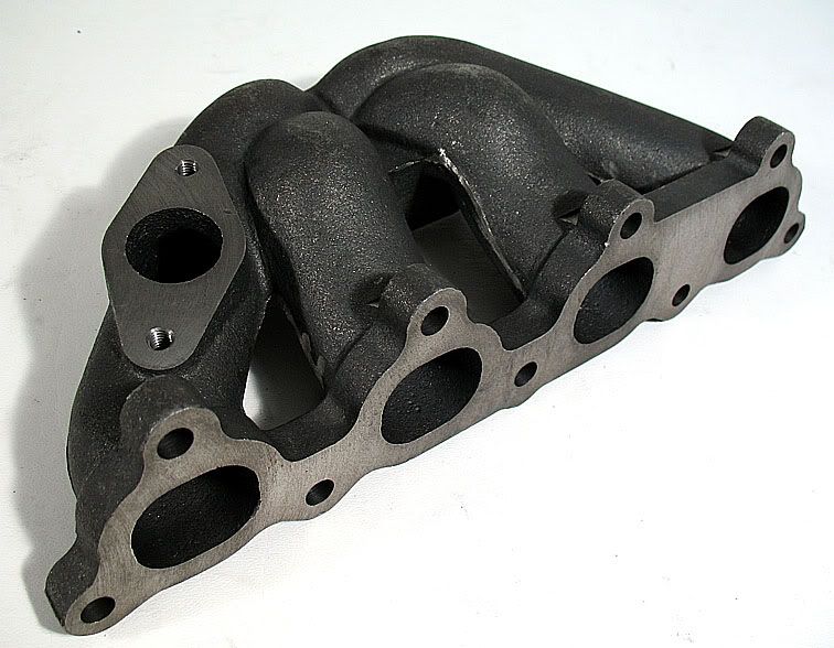

    so i'm looking to do a uber cheat turbo kit on my d16z6. but i was on ebay and i came across a cast iron manifold. but i wanted to know if anyone has ran this manifold on there d series with a/c and p/s... reps for help
    picture:
    p.s i know that the wastegate placement is shity but if i get it when i will block it off and run a t25.
    Imy ruckus

    get one that has the wg flange in the midle not just on one cylinder.

    i'm getting a block off plate made.. and running a interal wastegate that came on the t25.

    in that case you should be okay as long as it is cast. they last for ever. i have a rev hard cast iron on mine and i love it

    yea... lets see what it can do. i hope it will not crack.

    Hell yea, good to see another single cam turbo project. That manni will do just fine with the block off plate and a internal gate.

    that one looks like a drag knock off..... with a t3 t4 it will not clear the a/c compressor. the p/s will be ok.
    if your running a smaller t25 you should be fine..
    enjoy boost, a/c, and powersteering.
    i had a drag with the wastegate oriented like that..... i welded an elbow to a flange and just remoted my waste gate over a bit.....

    i'm planing on running the t25 just cause i'm running a sohc..
