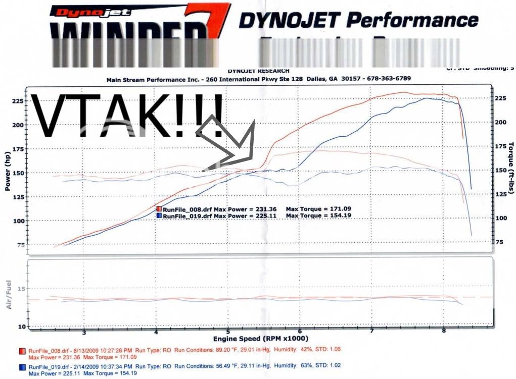

    Well im sure by now everybody knows i put my built h22 in my dads hatch and his stock f20b in my accord well the skunk 2 manifold was to big of a pain to me to put in his hatch so we just put the stock one back on we had a little problem with the motor so we changed a few things and this is the new dyno numbers.The blue is the old dyno and the red is the new tell me what you think.
    h23 crank
    crower roads
    type s pistons
    balance shafts removed
    skunk2 stage2 cams
    kidd racing header
    stock h22 intake
    skunk2 cam gears
    252plus hp and 34.5 miles to the gallon all motor. 12.2 at 111

    Im happy with the more horse power but realy happy with how much more horse power its making through out the power band thanks to scottie at mainstream for the tunning.

    Looks like that SKunk2 manifold was really killing you in the midrange

    naw wasnt the manifold i think it was the pistons hitting the valves and head lol the block was decked a little further than what it was supposed to be everything has plenty of clearence now though. The guy i bought the block from said they took five thousands off when it was more like fifteen. the pistons were supposed to be sticking out twenty thousands they were sticking out thirty six thousands.

    scottie said would actualy make about five more horse power with the skunk 2 on it i might find a uro r manifold but its fine for now. It was fourty degrees cooler last time also id like to see what it would do with a uro r manifold and fifty degrees 240 maybe with old skunk 2 stage 2 cams not to shaby.

    Dang thats a huge gain from 5500-7000!!! Those are standard stage 2's correct? Is this through a standard prelude tranny?

    thanks man yea just skunk 2 stage 2 cams and stok m2 b4 trany

    is that at the wheels? And awesome jump in torque!

    last time it was dyno'd it was in an accord with 19's on it

    yea thats to the wheels thanks . The nineteens are actualy realy close to the same size of the tires thats on the car now just the first time we had it dynoed we had some clearance problems with the pistons barely hitting the head and valves so that was taking away power . I actualy had a skunk 2 intake and higher compression the first dyno .
