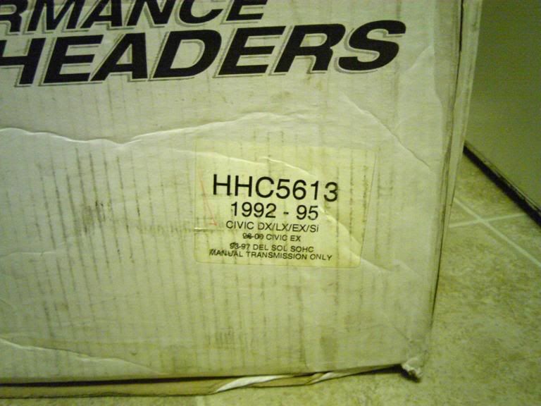

    All Motor BlackDubs's Avatar
    Atlanta,GA
    2,427
    Heres a picture of a DC header that I found on here fs (by EJ1soSlo) , its to show you how D series are compatible. It says that it will fit 92-95 Civics/96-00 Civics/92-97 Del Sol. So you should be good with any header you choose.
    kangarooster meadows
    4,382
    The bracket on the bottom isn't an issue, the whole stock system will be gone so as long as the HEADER bolts up to the head it will be worked out. And on that box it doesn't say cx, that's what I've run into with every one I looked at. Fuck it though I'll try one out. Thanks guys.
