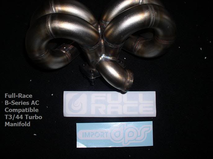

    idk about you, but to me i find it somewhat odd that on ebay, they have the shiny pretty looking turbo manifold selling for much cheaper than the cast-iron manifold...and since the parts are supposed to last forever according to the purpose of the build, which is a daily driven turbo honda, which manifold would some of YOU all choose, and why? It seems to me that the cast iron manifold would absolutely last forever, and even be able to withstand higher boost pressures than the second one. But still, im not sure. So here it is:
    Either....
    Exhibit A - the 'good ole' cast-iron "like stock", upgraded log?
    or...
    Exhibit B - the "ebay special", super-shiny, header-like turbo exhaust manifold?

    Never tried niether one but I picked B. If it breaks, re-weld it.

    i have two of the second one. and i heard that u should strengthen the welds on the wastegate flange

    The cheap ass shiny egay ones basically have to be re-welded if you want them to last for just a decent amount of time. And even with the reinforcements, Iv seen them fall apart.

    Yea, everyone else pretty much sumed it up. Buddies of mine have ran the ebay tubular manifolds, and have bought, welded, and reinforced, only to have to them brake. Cast is the way 2 go.

    A- a cast manifold will hardly ever break and it actually will help spool some.
    Option B will not only break but the design will make it boost creep also.

    i haqve one of teh second one on my gsr and ive had to replace the wastegate mount completely because the metal is a cheap carbon steel and is very prone to heat warp and flex and the pipe will break and the two stabilizing braces are no good i fixed mine with a piece of exhaust adapter from auto zone which joins two pices of pipe together and rewelded the wastegate flange on it then welded it to the manifold so far no problems since i redid the wastegate and it boostin better to.

    where those crack is almost impossible to weld it to where it holds.

    the cheap ebay tubular's are not even stainless steel....... they are coated steel thin wall mani folds being 18 guage (regular header grade steel). i have cut one up and the sparks from the grinding wheel shoot orange like steel not white like stainless.... plus they are magnetic......
