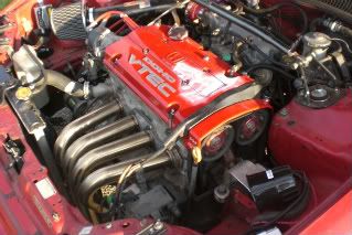

    Just got the motor from Matt at JEI and its awesome!!! got a few more things to purchase before she will be where i want her, but for now....
    No name hacked accord intake
    Kidd racing RMF style header(fucccin sweet!!!)
    MSPi custom exhaust(thx Rob)
    18o somethin whp and 150 somethin tq
    not too bad....this is all in a CX hatch. 10 gal. tank FTW!

    those headers are sex!

    Thanks!!! they look even better now that they have changed to the goldish tint

    yea i love the goldish tint it'll last about 3 weeks that color, wish mine can stay that way.
    I got a MSPi magnaflow Catback to, but i went with the 3inch piping w/ 3inch resonator and 3inch Muffler and actually gained TQ instead of a loss, since most NA cars gain HP but a loss in TQ, H & K-series love the 3inch piping, with the RMF header and the 3" exhaust i gained 14whp and 6-8tq from 3800-7500rpm over a DC sport header, 177->191whp imagine if it was stock headers compared to the RMF.
    Thats crazy how your gaining that power from your 2Krpm range, are your butterflie valves still connected and are you using a P72 ecu or a P28, I want to take mine off but i have to get it retuned since it'll run leaner since mine is already tuned with the butterflies.

    i drove on the stock header and a horrible exhaust for a week...garrrrbage.
    I couldnt believe the dyno pull he did when i heard vtec amost instantly. Me and Baby J looked at each other like "wtf". it is crazy on the street too. ur in vtec so soon u barely notice....after 3500 its just pullin like is being towed by a vette at WOT.

    is this the EDM h23 stock vtec motor or is it a frankenstein?
    also, those numbers seem low. i made 180/156 with my stock h22 w/ i/h/e

    Its a blue top.
    Most likely H23a

    yup...OEM h23a. numbers are a little low cuz i have a hacked ass intake and Rob forgot to bolt the tensioner to the alternator bracket so the voltage was all over the place. also has the smaller h22a TB on it cuz obd2 sucks and the car was already wired for obd1.
    Im making that at 7000rpms max not 8200...good to hear your h22 made that tho

    checked the datalogs and the voltage was stable throughout the final runs. the voltage issue coincidentally happened when it was done...good thing because the tune should be straight.
    as for the poster that said it seems low...motors can be all over the place. i've seen h23vtec come in at 150 (ouch) all the way to 230ish.

    iab open with p28. this is a freak motor. i was thinking one of the cams is off a little, but the timing and the power curve look fine otherwise. there may have been some head work done on this motor by the previous owner, maybe.

    ya, my butterflies are stuck open
