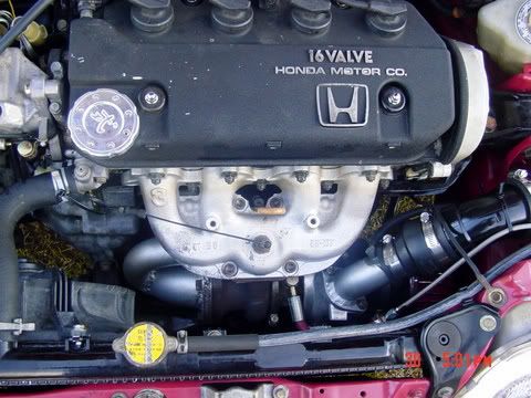

    I put a real cheap home made turbo kit together for about 700 dollars. 14b turbo, hf manifold, hm dp, JRC IC abs plastic ic piping, dsm injectors, turboedit. It was on my 214,000 mile stock d16a6 crx, my boost was around 8psi, sometimes it wanted to creap up to 12psi. It was fun!
    I wouldn't worry too much about blowing it up, as long as you have the correct fuel and timing from a tune, your good to go!
