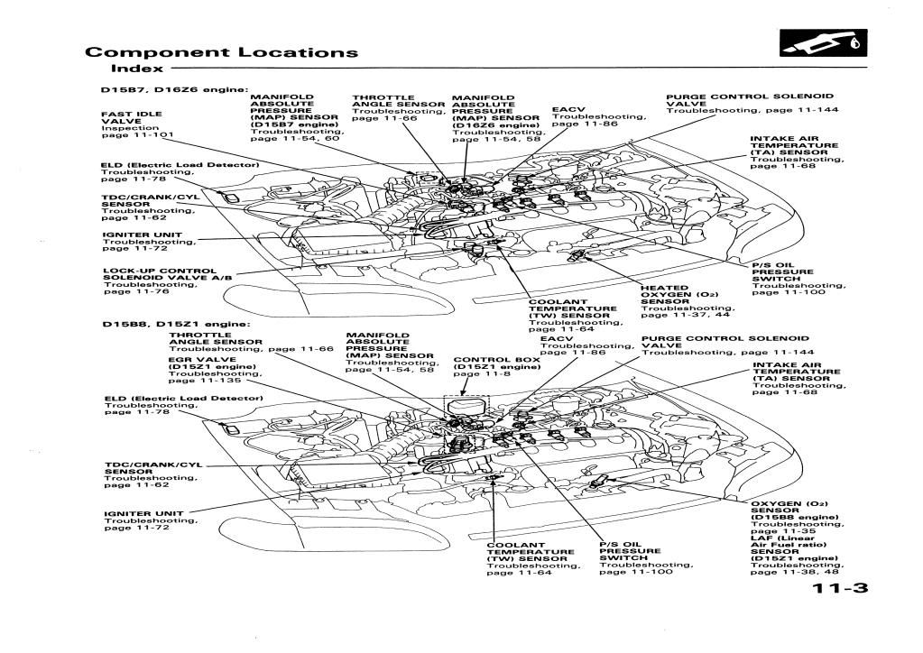

    were is the intake air temperature sensor located on a d16z6. thanks reps for help.
    Quote Originally Posted by weaver89
    hope this helps...:-) here is the site http://raptor-tech.com/Documents/diagrams.pdf
