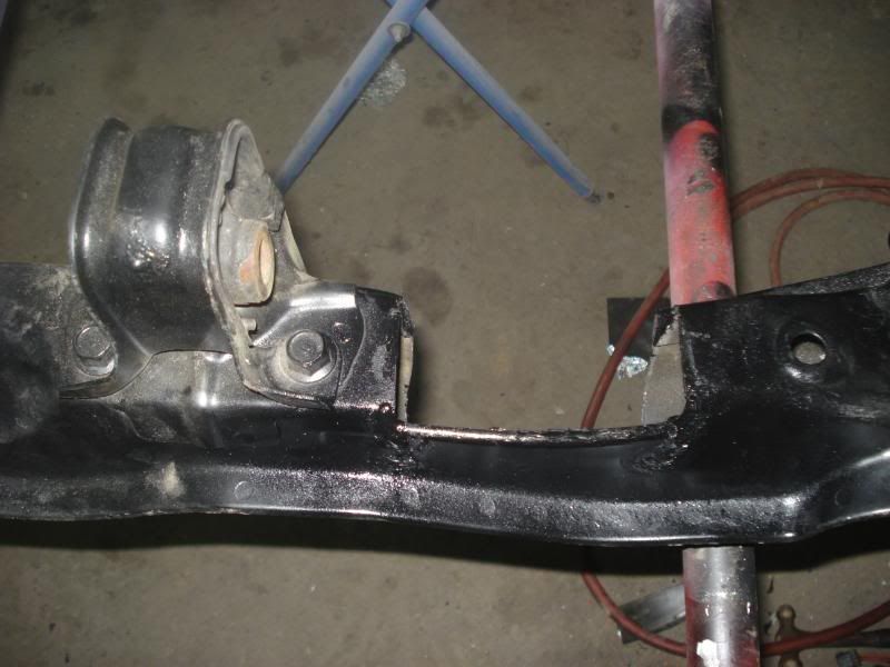

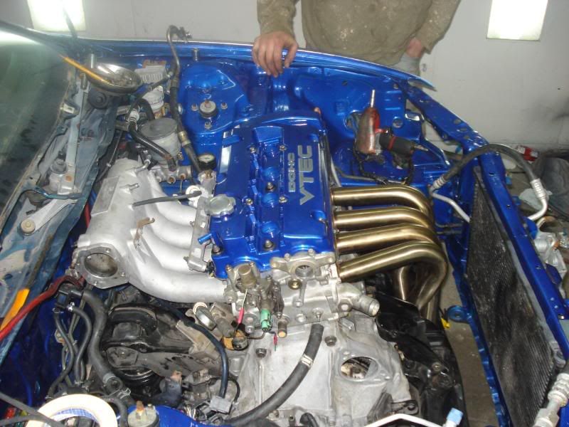

    I finaly finished my h22 build so i figured i would put some pictures up to promote the new kiddracing header so tell me what you think. I had to notch my cross member and trim the front bracket for the motor mount just a little but other than that it fits great. I installed a rmf header a couple of years for accordm3 and it broke in three places on the way to macon. The steel and construction of this header seems to be alot better i will let you guys know how it holds up.

    nice, btw, we need bigger pics.

    pics are smalllllllll... nice header.

    engine bay looking great. Bigger pictures are a must

    pics edited so they are now bigger

    that engine bay has alot of potential with some tucking

    This kinda shows the accord guys how much they have to trim their crossmember, not too bad about like an EF
    Looking good Mike Jawnz, get her running so we can tune it

    holy crap i have a lot of crossmember triming to do i think im going to box in my cutout portion though. i wish my header would hurry up and get here

    I realy dont think it needs it but i know were ten more cross memebers are so i will box in one just to be on the safe side. I did bend the metal i cut back into the cross member and weilded it . It is just hard to see in the pictures.

    Looks great, id like to see the numbers. But i dunno if i wanna notch my crossmember out that much tho. hmmm

    I do have prelude specific headers, and an accord that is based off the Tri-Y style. They are about to be released.
    H22 Jones just wanted to test fit this header in an accord and post the results.
    Now the trimming of the crossmember is about the same as an EF, so structual wise its fine, i wouldnt be worried about it failing or anything like that.
