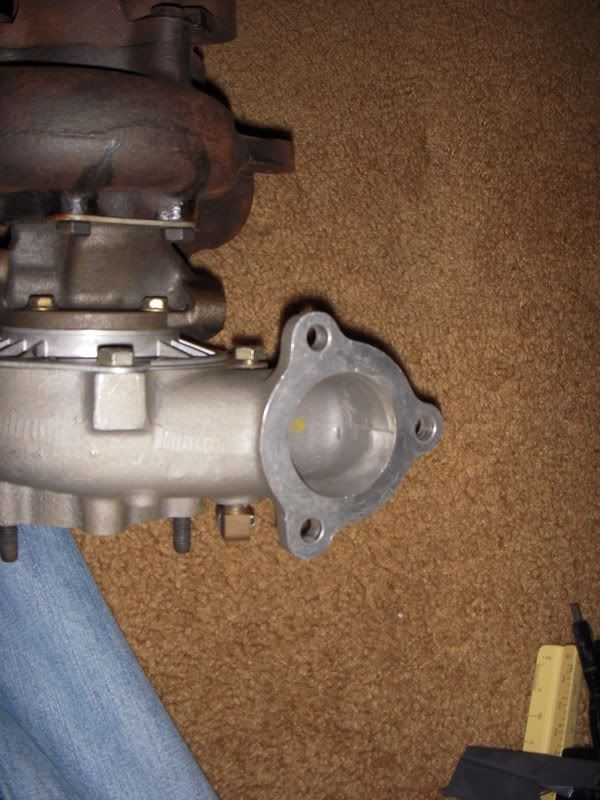

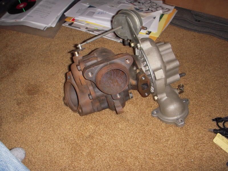

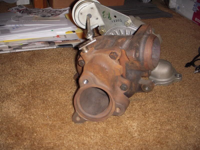

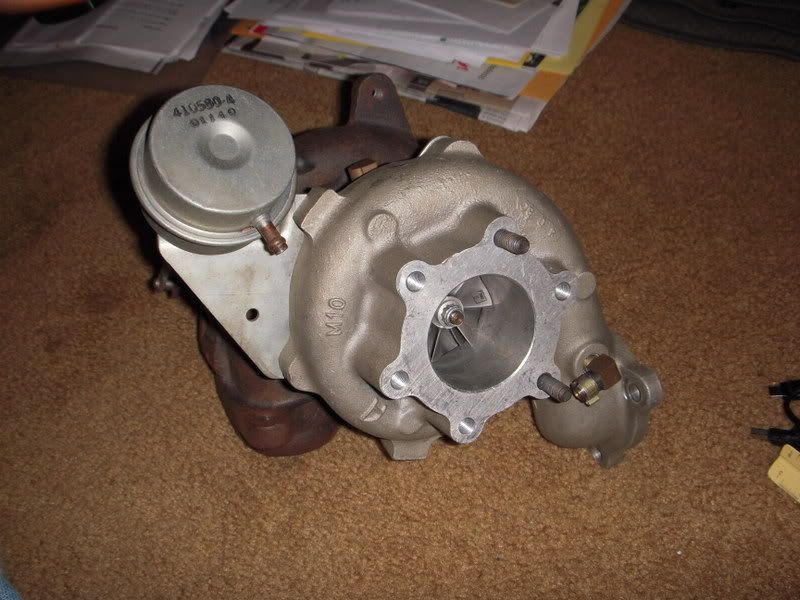

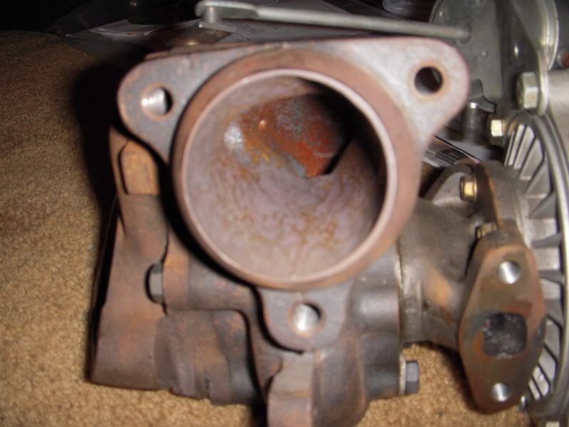

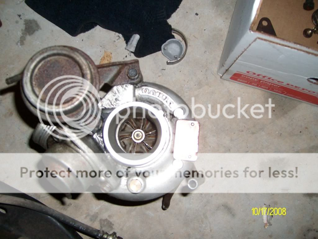

    I'm having difficulty with this M10 turbo. I believe it's out of a late 80's early 90's saab and I just can't figure out what kind of flange it has. I'm trying to get it to hook up to my D16y8 civic with a cast iron manifold. Would I able to get a T3/T4 manifold and find an adapter plate somewhere?
    Any help would be much appreciated.

    i HIGHLY doubt you'll be able to find some sort of adapter plate. you could find out the exhaust housing measurements (a/r...turbine wheel size...etc.), try to find another housing of that size with a t3/t4 flange on it (that'll ALSO bolt to that cartridge) and swap the housings.
    personally, i'd just sell it and buy a turbo with flanges you can identify, and know more information about it.

    ^^^im with you on this one.

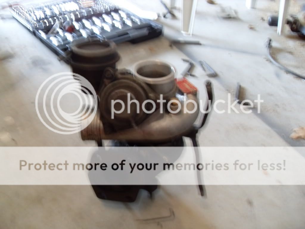

    killthecrow i have a volvo tdo4h thats has the t3/t4 flange and a down pipe it needs to be rebuilt nut itll get in the right path 50 bucks lmk
    dont have pic of downpipe but comes with it
