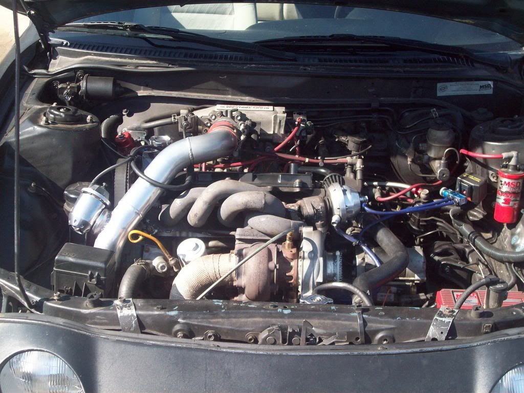

    Im curious what i can do to my 91 Mr2 Turbo for about 2000 dollars? Any suggestions would be great looking for around 280hp. Stock motor and trans with a 4 year old 16g turbo and stock intercooler and tubing. Running around 10psi and also has Apexi M1 down pipe with stock manifold+K&N+Greddy BOV.
