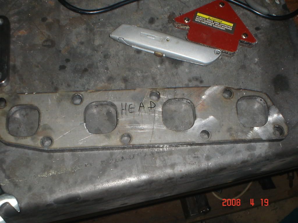

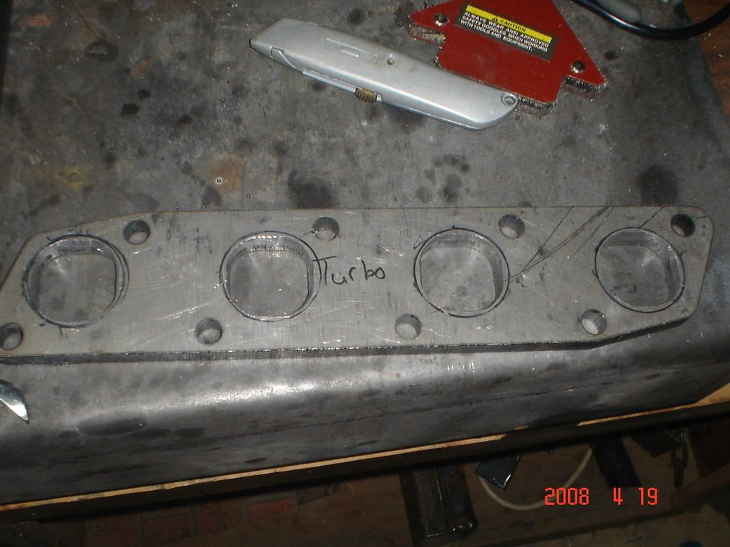

    First thing I tackled was the head flange. It wasnt one the fancy laser cut units so I had to de-bur the ports and had remove some material on the head side to get the flange to line up with the ports in the head. I would recommend getting the flange from BMCrace that is ported to accept the schedule 40 pipe. It makes things much easier.

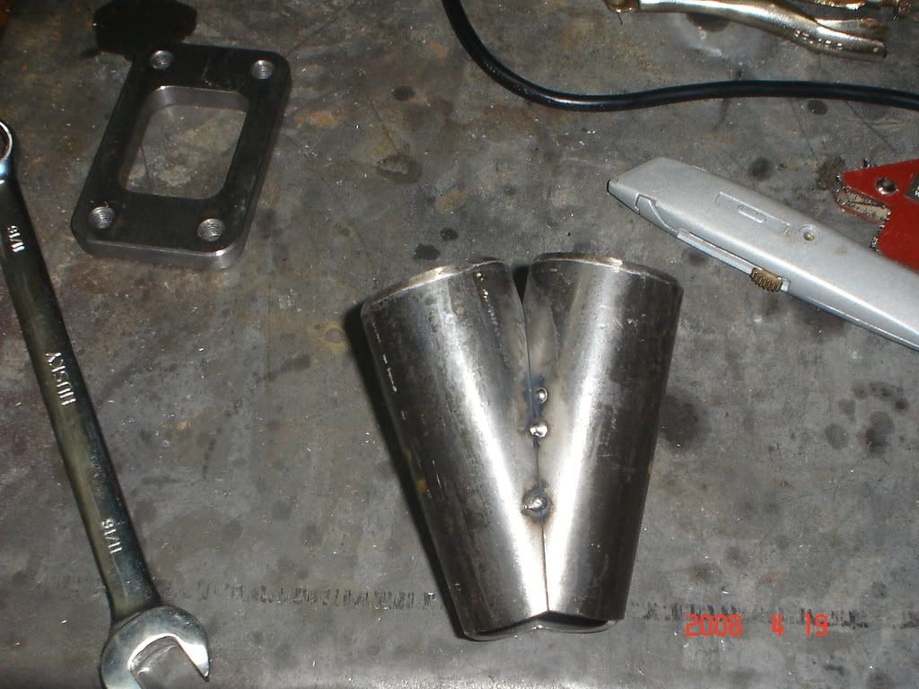

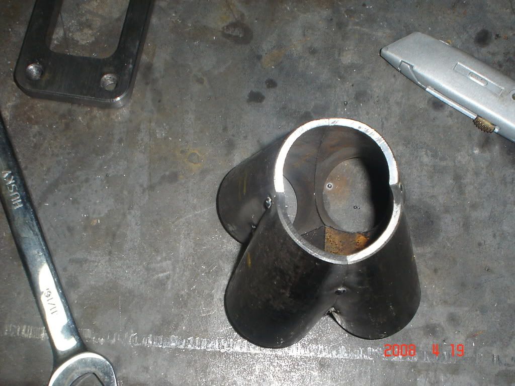

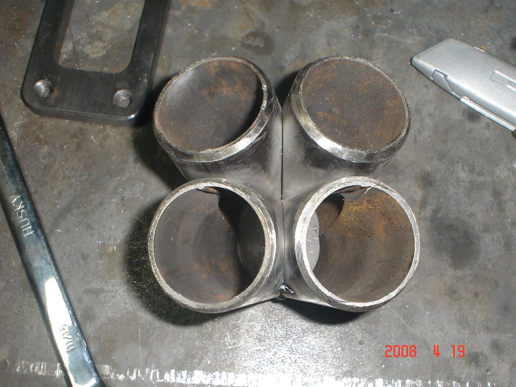

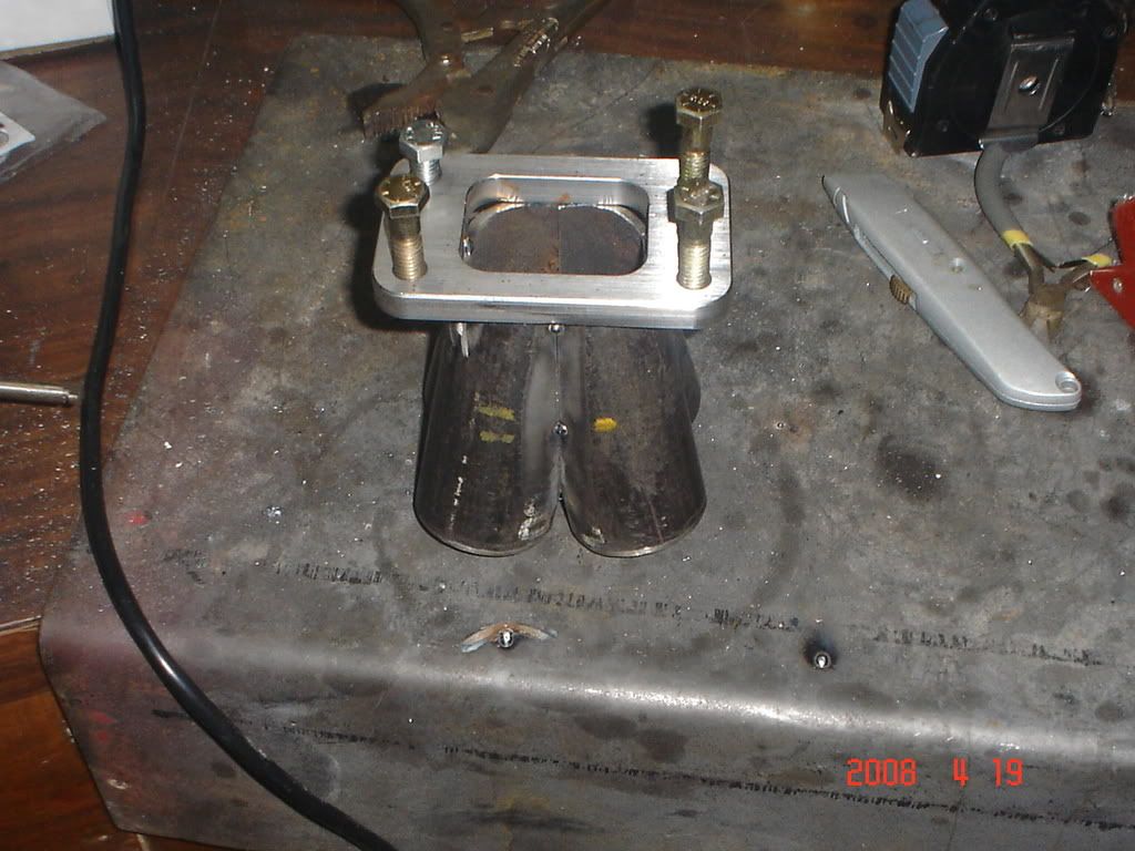

    Next was the collector. It came from BMC race perfectly cut and was an easy fit. I tacked it together and then cut the top where the turbo flange would be mounted

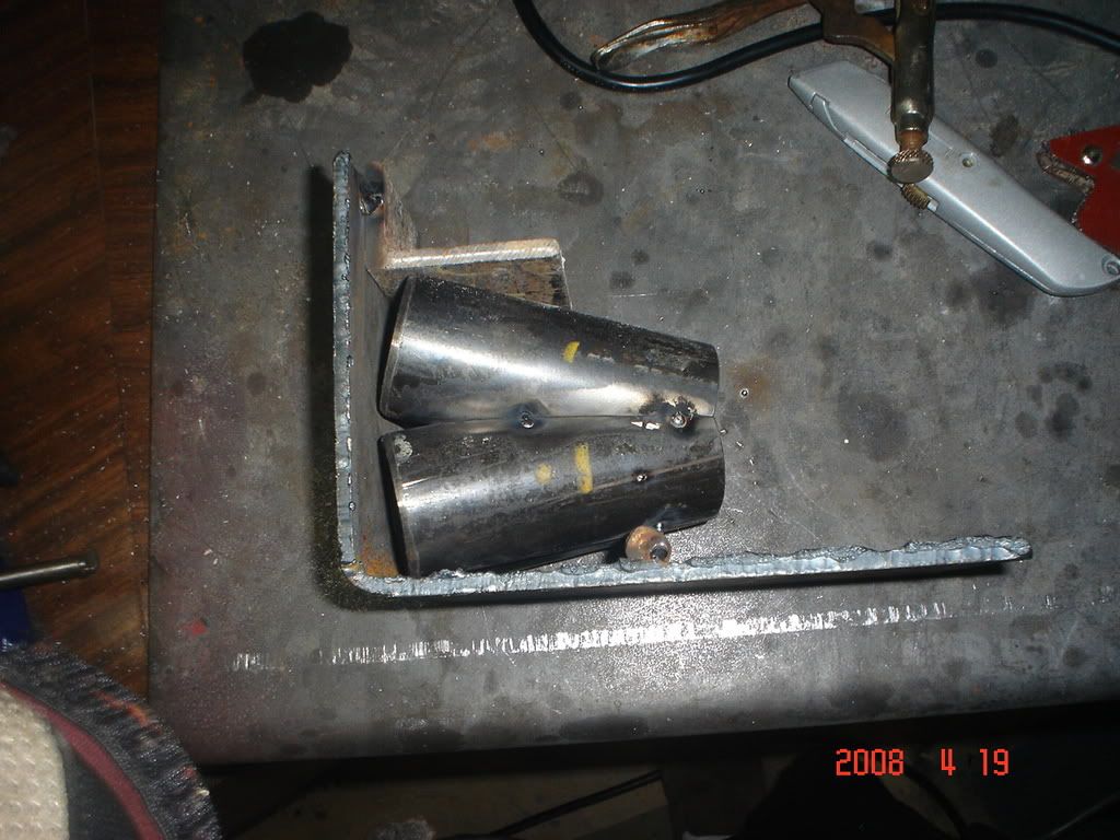

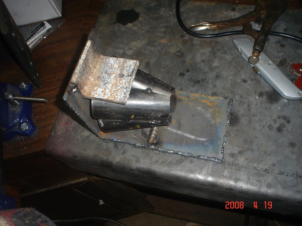

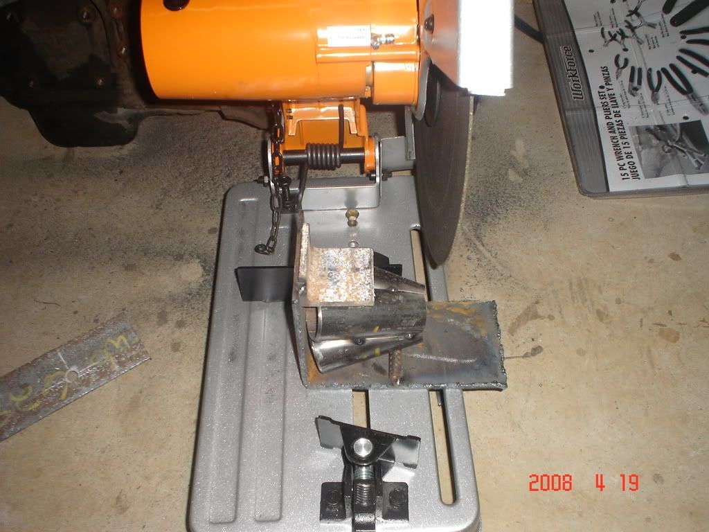

    Here is a jug I made to cut the top flat

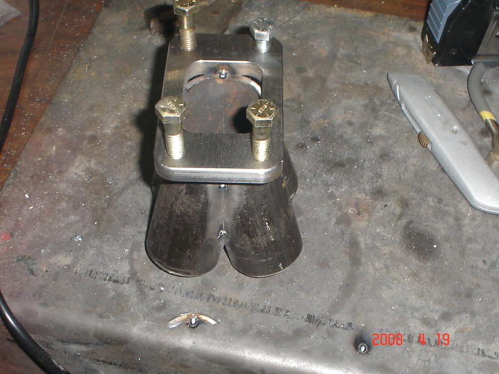

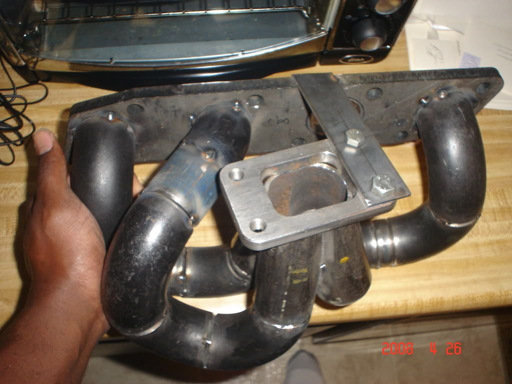

    Then I tacked on the turbo flange. I was told to put bolts in the flange when welding it so the holes dont warp.

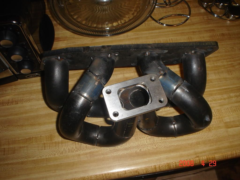

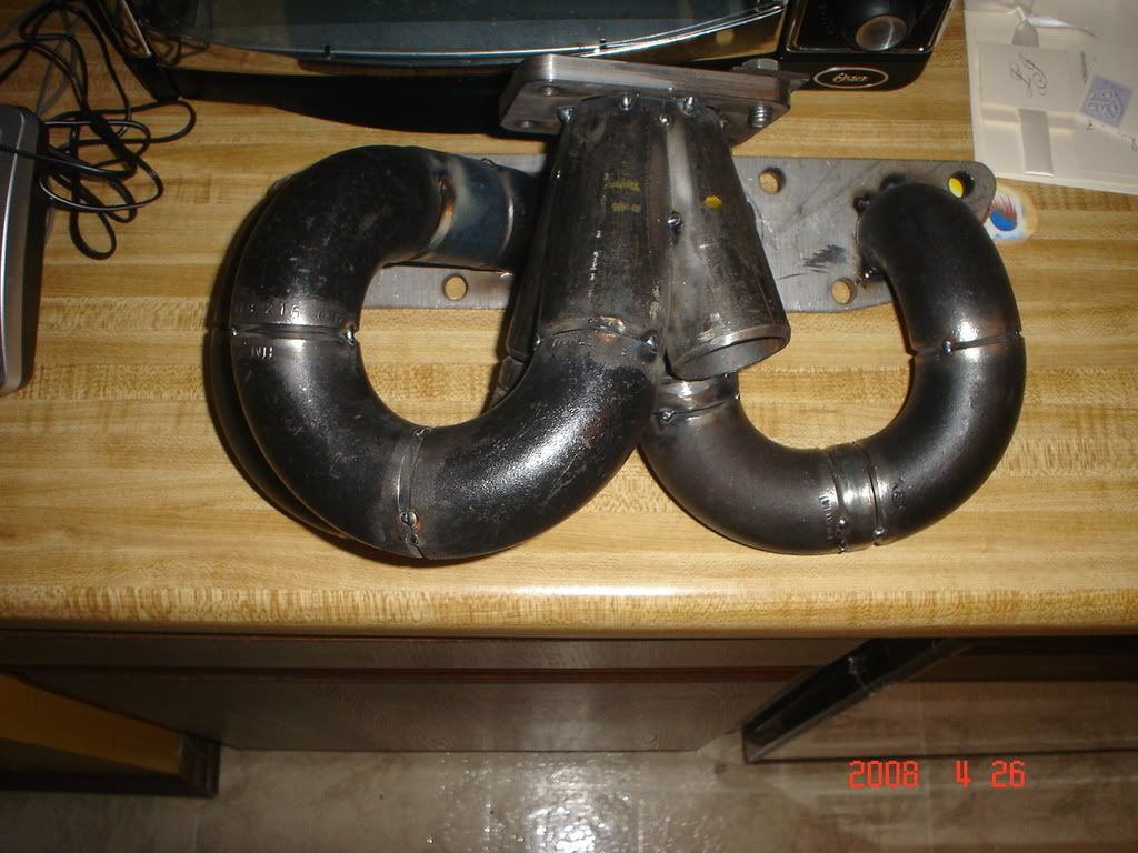

    Next I started on the runners. The first runner is a PITA and I had several cut and re-tack trial and error fittings but I was patient and got it going. It helps to have someone else to help hold stuff.
    And this is as far as I have gotten. I will keep this thing updated as I progress. I will be happy to answer any questions

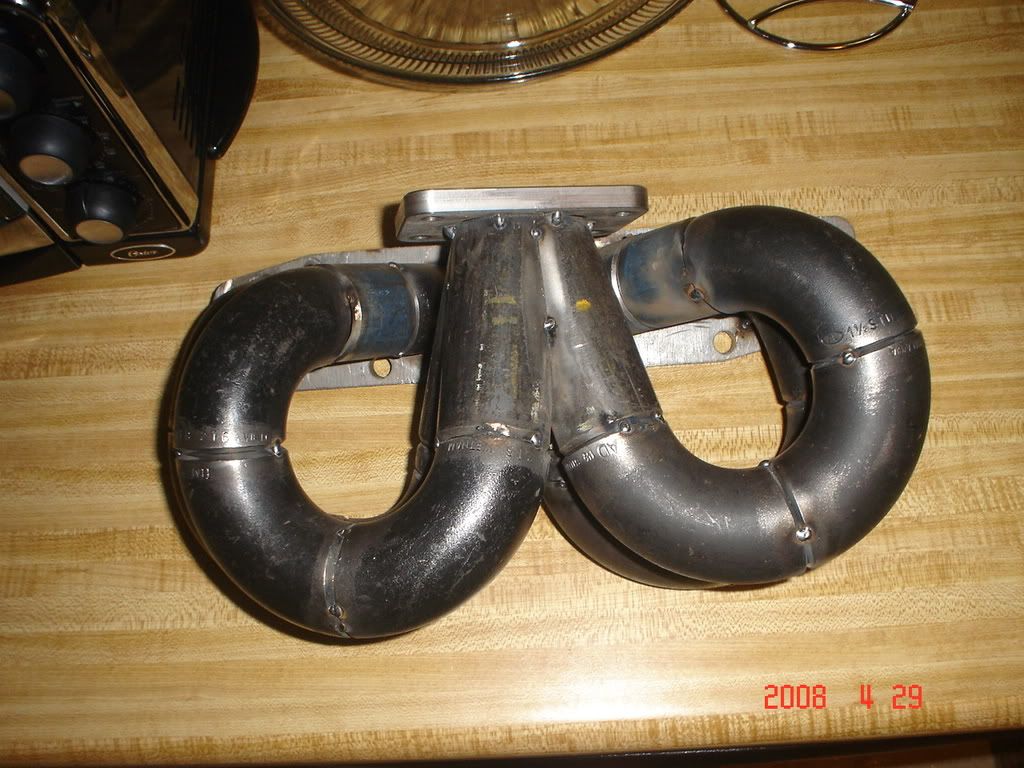

    I finished tacking together the last runner today and now Im about to take it apart and clean every joint before final welding. Any tips from anyone who has done this before would be greatly appreciated. One thing Im afraid of is the metal warping and not fitting back together

    im impressed for this being your first time! take your time, i had about a day and a half in this one and over 600$ just in materials, you will have to weld the runners one by one using one weld all the way around each joint, best of luck to you sir, what model welder are you using?
    just a lil SOHC... B_Hoov's Avatar
    Flowery Branch
    2,185
    oh, and weld the runners INSIDE the flanges ( turbo and motor )
    LAST TIME I MADE A MANIFOLD IT WARPED AND DIDNT LINE UP THE WAY I HAD IT TACKED. I WOULD SUGGEST WELDING AS MUCH AS YOU CAN BEFORE BREAKING IT DOWN TO WELD THE TIGHT SPOTS

    Good Idea. thanks for the advice. I think I will first weld the collector together and route my wastegate and then write up a plan on what I can weld first while its still tacked together to try and minimize warpage.
    Wow, nice so far. I welded my own log manifold for my little setup (not near as complex as your)but it did teach me a few things. Some of those spots are going to be hard to get to with a mig, but I would think it could be done with some careful planning. Make sure you mount your flanges down before you weld them, b/c they will warp(trust me I know, lol). Good luck, and props on doing it yourself
