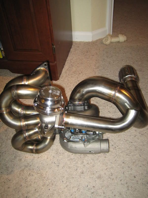

    Just got my Synapse kit in today. It is AC compatible and I have a 57 trim. Shooting for 300 WHP!!!!!!

    synapse makes great manifolds! you should be very happy with it! good luck man

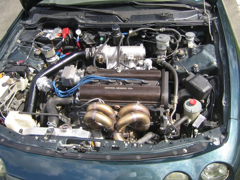

    It is going on an LS engine and the block is built with Mahle pistons and Eagle rods so 300 WHP is my goal. The head is Portflow built with Supertech SS valves and springs and Crower 402T cams and I have a 3'' DP into a 3'' Thermal Cat-back. I could run more on this thing but I don't really wanna.

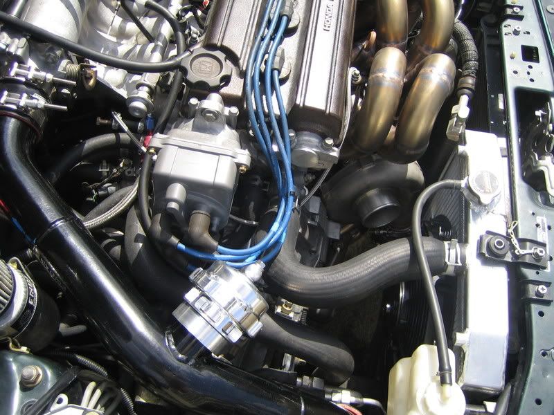

    Movin on up! Got her running last night on stock injectors and ECU. I just let her idle though to check for leaks...all was good. Now I need to get my base map, finish wiring in the AVC-R and get this baby on the rollers!

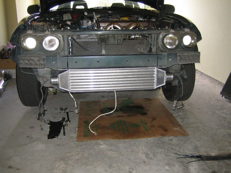

    Thanks guys...I tried to put on the bumper on last night but somehow I had the intercooler on a little crooked and I had to pop the pipes off and do some rearranging. Hopefully I can get it on today

    Got her fully operational today...the CEL is on but that is cause I have no O2 sensor yet...the bung needs welded on. Everything is ready to be taken to Carter Race for some minor exhaust work and a good tune. I hope to drop it of Monday of this week.

    She is on the dyno right now. I just talked to Justin and the damn distributor messed up again the the rotor flew off. I guess it is new distributor time. Hey said it made 210 Wtq on the 7 pound spring so we will see how she does after she doesn't cut out after 5000
