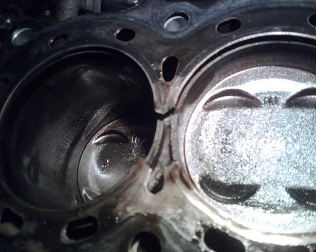

    Word to the wise......make sure you got the right pill ...and enough fuel
    He Melted the head too

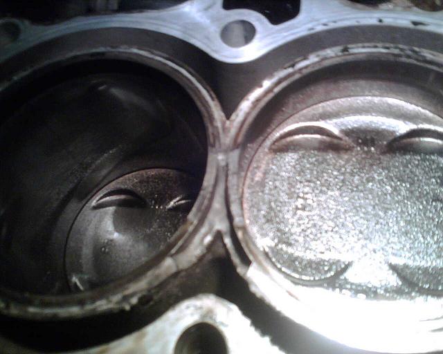

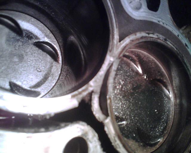

    Reminds me of a kid named "Baby J" who had a nitrous fatality as well. In my case I had proper jetting and fuel, but the fuel solenoid locked up due to temperature extremes (cold/Indianappolis). Since then, I mount all noids on the pax side footwell INSIDE of the car.
    A quick rehone and some JB Weld and I was able to rebuild this block and up the jetting. It's now an 11 second block.
    wtf... did you jb weld the piece of the sleeve that broke off?

    In the 1st pic there is a block guard.
    Hiram
    10,412
    That would be a headgasket.
