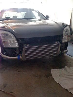

    Just wanted to post this pic and see if this is how anyone else ran their intercooler piping on a BB6.
    Well....ok I'll be honest.....I'm just excited about the turbo project and wanted to share my excitement

    as far as your original question:
    Attached Thumbnails Attached Thumbnails -695712_53_full-jpg
    Professional 19'sPrelude's Avatar
    Gainesville, GA
    245
    Frog - That is indeed a gorgeous Prelude, and definitely one of the nicer ones I've seen. Thanks for your help with the intercooler piping.

    Better plan on sleeving that block

    IMHO... The GT35r is too big of a turbo to run on the stock block. When boost kicks in it will kick in really hard which is not good on the stock block. I'd suggest the gt30r. it gives a more steady predictable power curve without the instant rise in power and can produce almost if not the same amount of power as the gt35r.

    They are prone to pop fairly easy compared to the B16/18

    speaking from experience. build ONE motor, boost it. keep the other as a back up. Thats what I am doing.

    turbo h22 bad news on stock block. will maybe last 20,000 miles. research into FRM sleeves. ring lands are prone to breakage too. just fyi...not hating though. good luck on the build.
