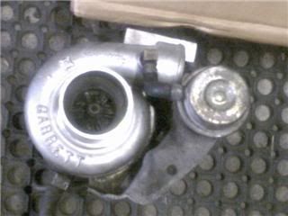

    i picked this turbo off a nissan 240sx had a Ca18det in it ... .48 a/r on compressor and .63 a/r on hot side ... it resembles the Gt28rs but the a/r dont match perfect and the compressor housing is slightly different and has a 4 bolt downpipe and cannot find the car it came off of because i guess it was a swapped 240sx .. i dunno .... and would really like some info on this turbo like wuts the wastgate set at ... is it ball bearing or not .... and where i can buy rebuild kit ( doesnt need it yet ) and new wastegate .... but cannot find any info on this .... ill post detailed pics and let yall decide .the turbine is almost identical to the 300zx turbo's but there compressor housing is different also .. would like some info i will get the part number as the turbo is at my boys house most i could find would be someone said something like a "TB0210 turbo "

    looks like a t28, cant be sure though.
    way too big to be a t25 though

    well i know its a t25/t28 of some sort ... but it resembles a ball bearing turbo .... but i dont think it is . like some info on the turbo and like wuts the wastegate set at .. ill get the model number for people to look up but i cant find like how big is the compressor wheel an things like that i would really want to about a turbo .

    Can you take a picture of the manifold flange? That might help some people out. Doesnt resemble any T25 that I've ever seen.

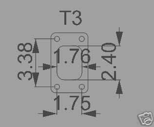

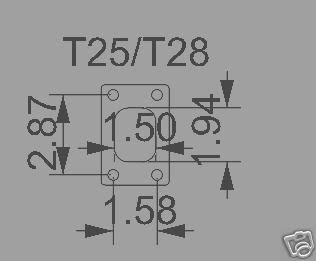

    right now i have a t25 to t3 adapter flange on it since my manifold is T3 flanged .. looks identical to a t3 but just smaller ....

    I'm pretty sure you've got the T25/T28 to T3 adapter. The regular T25 has a different flange and the T28 has a different flange. Anyone, please feel free to correct me if I'm wrong. Try using this information and let me know if it helps.
