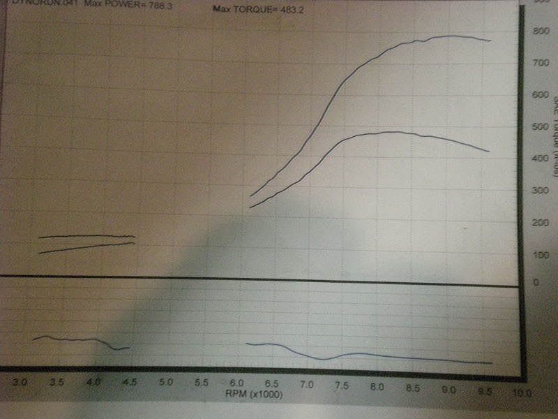

    if you go to get tuned with a 300 hp car i dont think you should have to explain that the car is not a race car. Its pretty much common sense.
    just a dyno chart to show that ed only tunes good when he wants...
    danny im sure you know whos chart that is, and you also know what happend to that motor less than an hour off the dyno.
    I have had two set ups tuned my scotty and i have never had to tell him what to do.
    i say go to scotty, you will save money using crome. But it up to you. good luck
    Privateer Racing!!
    Duluth,Ga
    5,730
    Ive never seen any dyno charts like this from anyother tuner in GA.on a honda/acura
