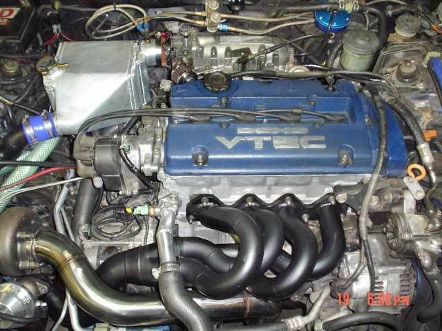

    peakboost makes one but its rediculous looking:
    they made 10 of these..one is for sale on h-t right now
    02 WRX patrick4588's Avatar
    warner robins
    2,329
    i bet that ***** is expensive as ****. pretty badass though

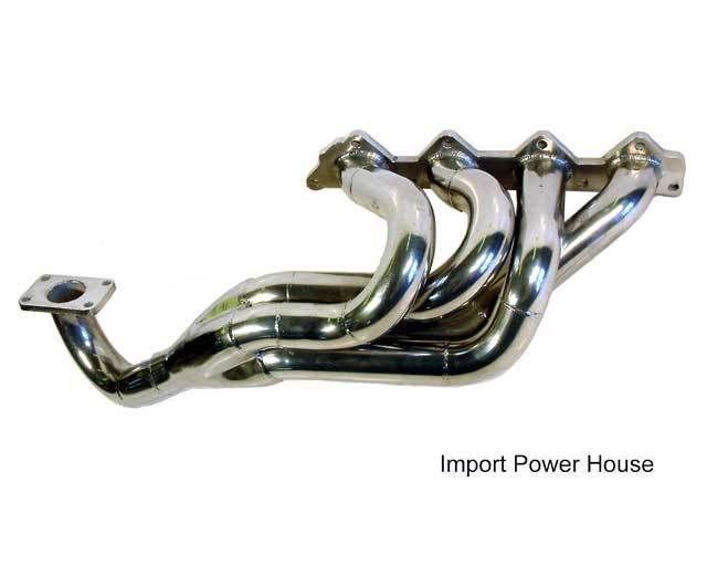

    something like this will work

    i agree, the first one is probably a couple grand, and the other would be where my battery is but i would get to keep the a/c...looks like it's time to relocate that battery! posted this picture to get opinions on weither this manifold will work or not and what would need to be moved/ come out in order to cram it in there, again opinions welcome, i want the leat amount of problems with this thing when it comes time to move everything. looks like i am going to lose my A/C, the compressor line looks like it's going to be a problem...
