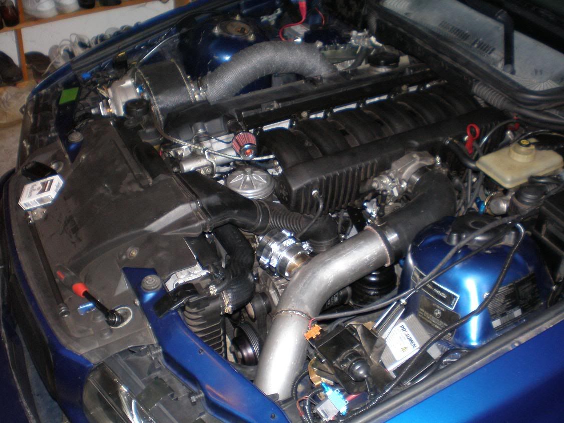

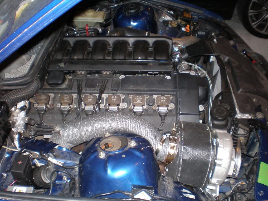

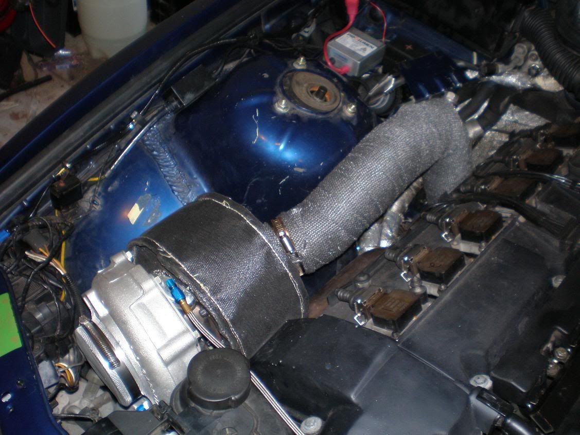

    4th even with lots of heat wrap and turbo blanky the under hood temps are blazing, so i was given some 2000 degree reflective material from thermotec for my birthday (thanks Wayne) for the shock tower and new aluminum valve cover to be made as well. also am considering a CF hood with vents to help get air in and look at ways to get air out fast from the bay.
    5th i sourced a E30 coolant over flow tank (same as Euro E36) and will install that with new lines since my current over flow tank is wedged between the hot compressor housing not to mention the WG piping right under neath the tank heat wrapped the tank and pipe as well for now)

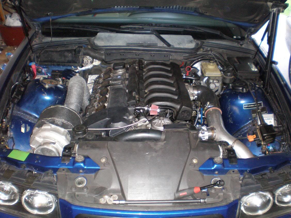

    6th had to have a custom metal lower radiator pipe fabbed up because the turbo manifold WG discharge interfered with that even before we modified it for AC.
    thats about all i can think of for now other than once i get all the above taken care of for sure get this thing tuned, it drives great out of boost though and nice and smooth. it 5 psi by accident didnt bog or hesitate
