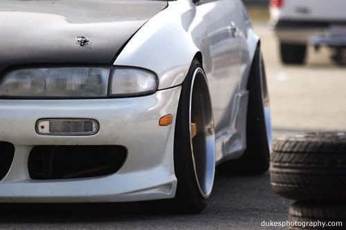

    +1 how much did they charge. if THP doesn't get a fender roller in this week then I am asking for my money back and going to a place that will get it done in a reasonable amount of time.
    ps whoever said the bat doesn't work never saw this s14. it can be done... it just takes a lot of skill
