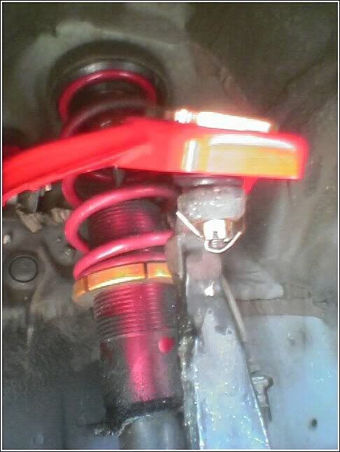

    this is how it will look if you get it
