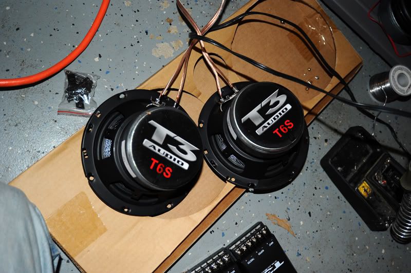

    T3 Audio components for front and rear doors.

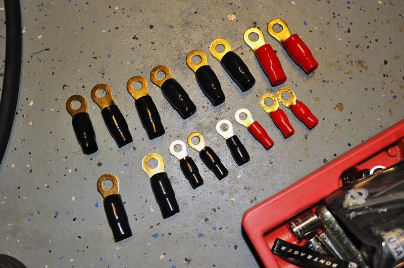

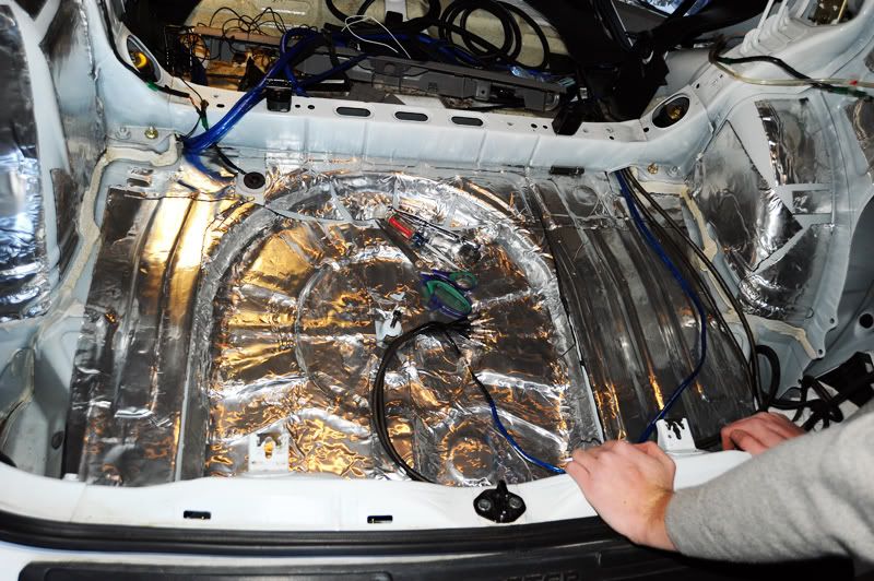

    XS power 5100R battery, Knukonceptz Kolossus 1/0 and 4 gauge, Knukonceptz Krystal Kable RCA's and fuses and fuse holders
    second skin damp pro sound deadening.....much better than dynomat.

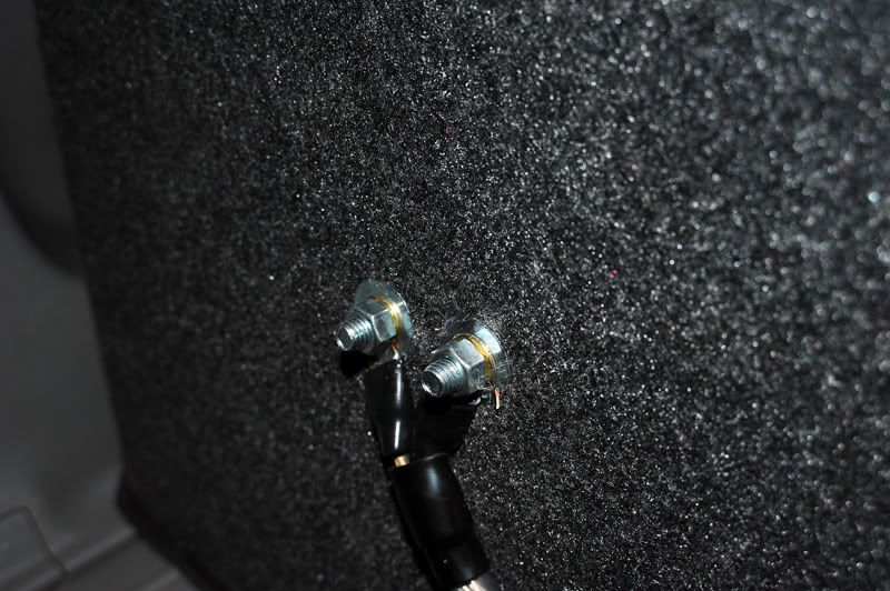

    amps are MB Quart DSC 125 RMSx4 and 2000 RMS x1
    voltage remote knob for the 2000.1 sub amp with the RCA's

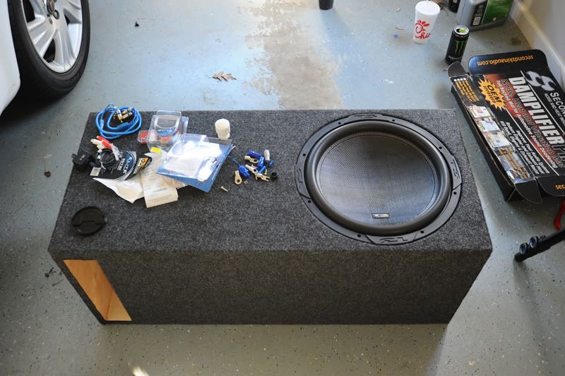

    enclosure built by AMI Creations/dynamic sound, 3.5CU FT tuned to 36HZ. birch is lighter for better MPG and more rigid than MDF. T3 T.2000 15" (takes 2k RMS)
    install time!

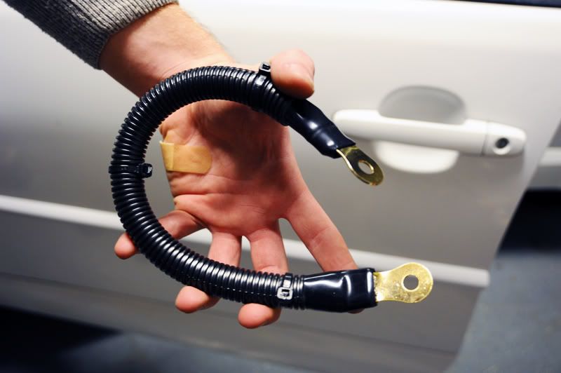

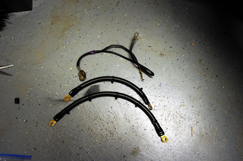

    big 3 wiring to help with voltage drop...
    everything was done RIGHT, all wires were ziptied, everything was put back together perfectly, even the plastics inside the door panels.

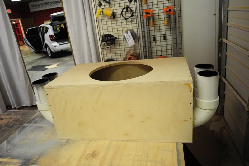

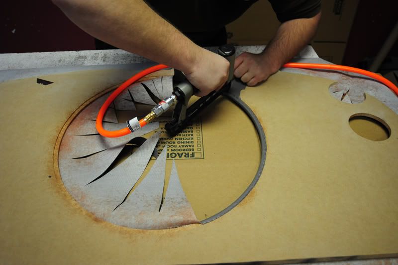

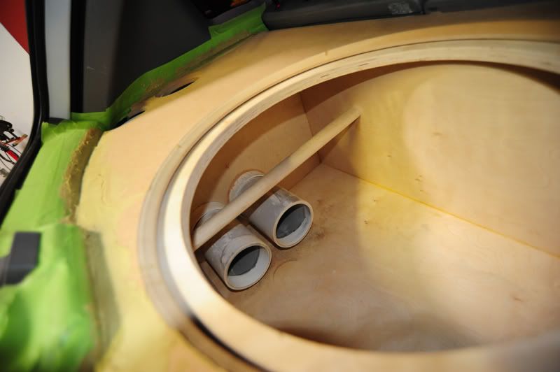

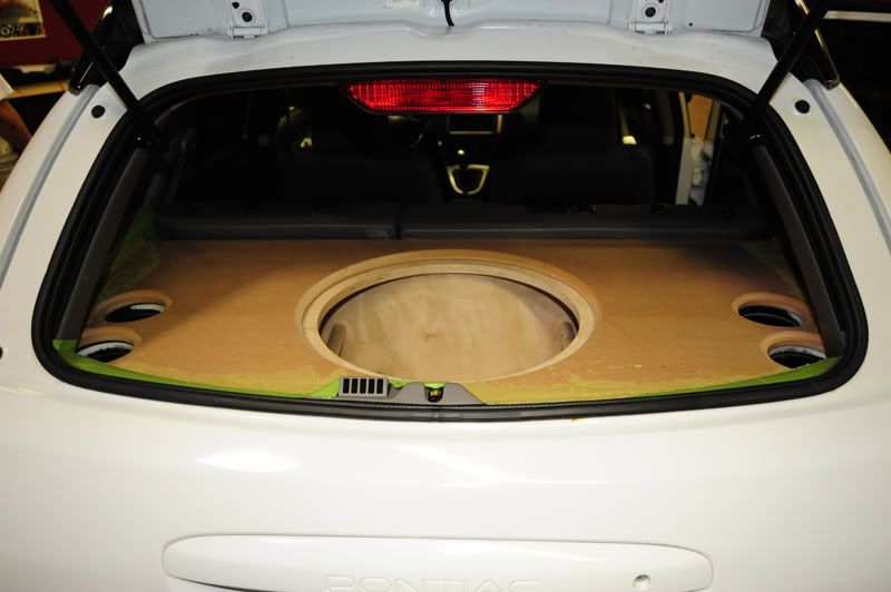

    after a month i decided i wanted more and cleaner install so i upgraded to the T2000 18"
    new birch enclosure. 4.15 cu ft and tuned to 34hz
    its loud, crisp and clear....plenty of people have heard it at meets and have loved it. it makes driving this slow vibe much more enjoyable lol

    Never would have thought about using pvc pipe. Thats a very nice set up.
    20,312
    MUCH cheaper than aero ports and do the same exact job
