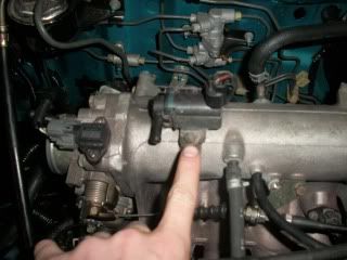

    okay so lemme start by asking what is the sensor on top of the manifold? not the tps on the throttle body and not the map sensor!! its got a nipple for a vacuum line, but no line going into it, i wonder if this is why she wont stay running.
    so is this where that line needs to go?
    could it be a bad map sensor?
    any other ideas would be appreciated.

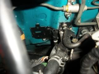

    That all runs to the charcoal canister, which of course is missing.

    yeah i figured it was to the charcoal canister, i have an extra one tho

    do you mean the sensor thats missing the line runs to the canister?

    Yeah, the line that is missing runs to the charcoal canister. Was the timing belt all you've done to this car? What condition was it in before you touched it?

    yes it connects to the charcoal canister.
    that hose connect to the sensor your pointing at. BUT AS YOU CAN SEE, YOUR CANISTER IS DELETED.
    its fine, you can run without it. <<< lose gas mileage. wont cause your car to die or idle weird.
