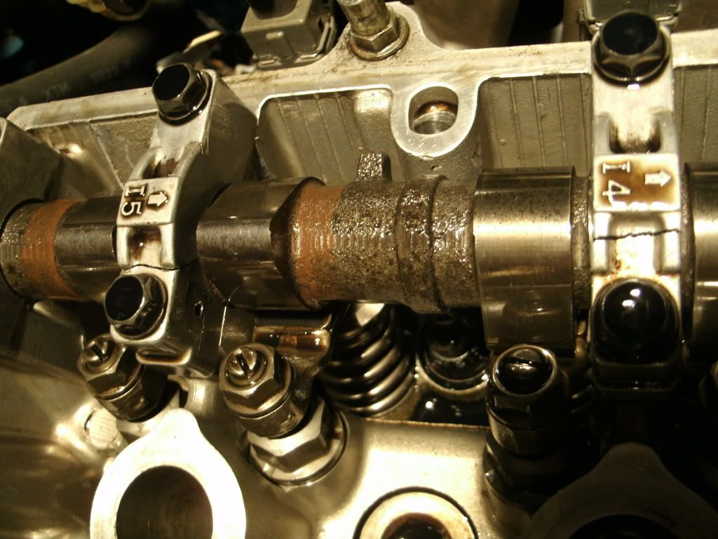

    Tonight, when i took the valve cover off, i noticed this:
    OH NOEZ!
    Valvetrain configuration:
    KMS dual valve springs
    KMS titanium retainers
    Crower 402 cams
    Valve last specs are: .003 intake .005 exhaust (stock)
    My questions are these: is this issue connected with the timing belt failing, or is this a separate issue that i need to address? What can cause the cam caps to crack like that? Now that i think about it, is it possible that the cams are bottoming out the valve springs at higher RPMs (since the lash is so close) and causing breakage?

    Just got back from Motorvations, while i was there i informed Jim that most of the cam caps had been destroyed - he then told me how the heads were actually made at the factory, and suggested that perhaps it'd be a better idea to get a junked head with intact caps. (i wholly agreed)
    Then we dismantled the head to remove the springs, retainers, and valves. A lot of the valves were bent in the actual stem, and we had to use a hammer+extension to push them out of the valve guides. Which means that the valve guides were probably toast anyways and needed to be replaced. Another reason to just start over with a new head.

    Here's another thought i just had - is it possible that the valve contact was so severe that the valves pushed the rocker arms up INTO the cams and the force cracked the caps?

    ive fix lots of broken belts first ive seen with broken caps also. i do believe they have to be line honed to fit right again.
