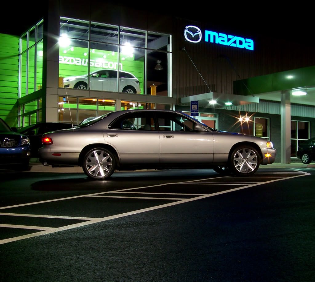

    100mm is 4inches.. the car has been dropped that low as is.
    and the plan was to get an aftermarket fd coilover kit, so i cna adjust it. and it will be much firmer. but i didnt want to get the coilover kit, and modify it first. i was gonna try it with a oem set first.
    as u can tell in this picture of stock ride height..ive got the room.
    i gotcha man, im just saying it might be worth the effort to continue searching for another option that fits without a bunch of fabrication, cause the only way i could see for you to modify shocks that much would be to send them to like Koni or something where they can take the gas out, weld them or whatever, revalve them for the weight difference, and then re-fill them. that's most likely big $$$.
