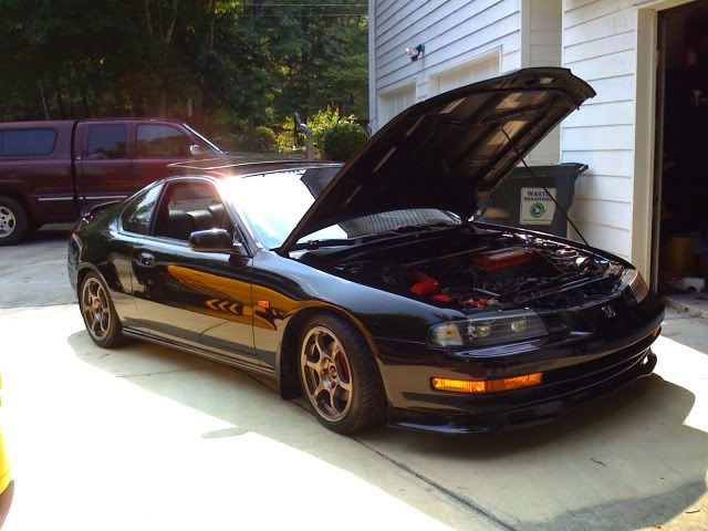

    and the vehicle its being installed in (MINE)

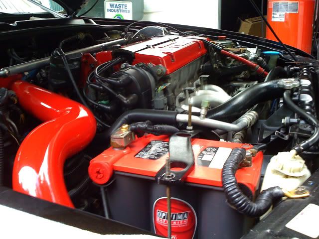

    engine bay before the install
