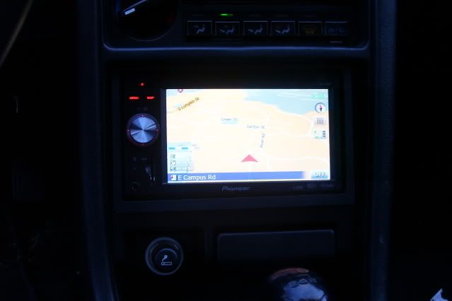

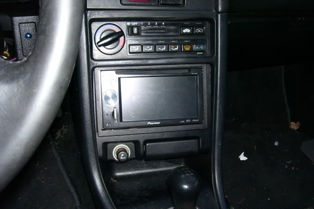

    I should of updated this thread
    I was able to get a sleeve shortly after this post.
    The USDM CRX only came with a single din slot, so I had to order a dual din piece from japan.
    After making slight mods to the frame (the sleeve was slightly larger than the opening), I was able to install it without any problems.
    13
    Very clean install. I love the Avic F series. The are very hackable, due to the fact they run windows CE in the back ground. If you are computer savy check out Avic411.com. If not swing by Zen on the weekends and ill show you some of my mods.
