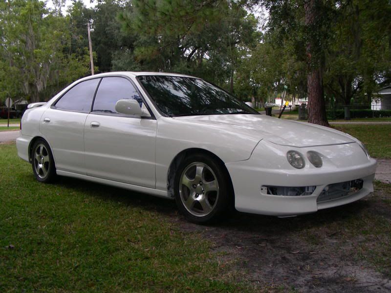

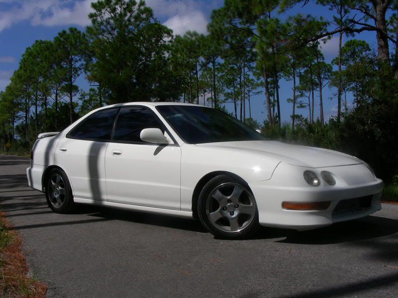

    Default Finally! Got my car painted!! Pics inside.
    Phat Boyz Auto in Perry sprayed it.850-584-5422
    They did an EXCELLENT job. Dropped it off Monday night, picked it up Wednesday evening. Very, very pleased. It was going to be $250.00 but I had him do some extra body work I couldn't do so he charged me $300.00 even.

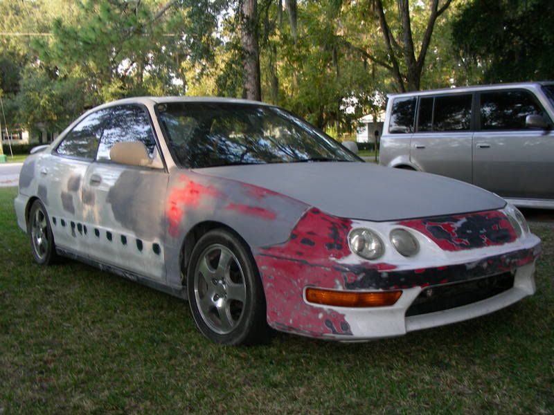

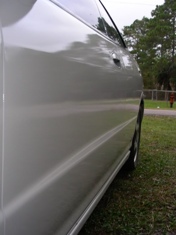

    I'm disappointed in some of MY body work.. You can see a few of the things I worked on. I think the vast majority of people won't ever notice But damnit, I did it myself and that has to be worth something. I busted my a$$ fixing the lil dents and shaving the side moldings. All in all, even though a couple didn't turn out how I wanted em to, I still didn't do too bad!
    Hoooray for me!

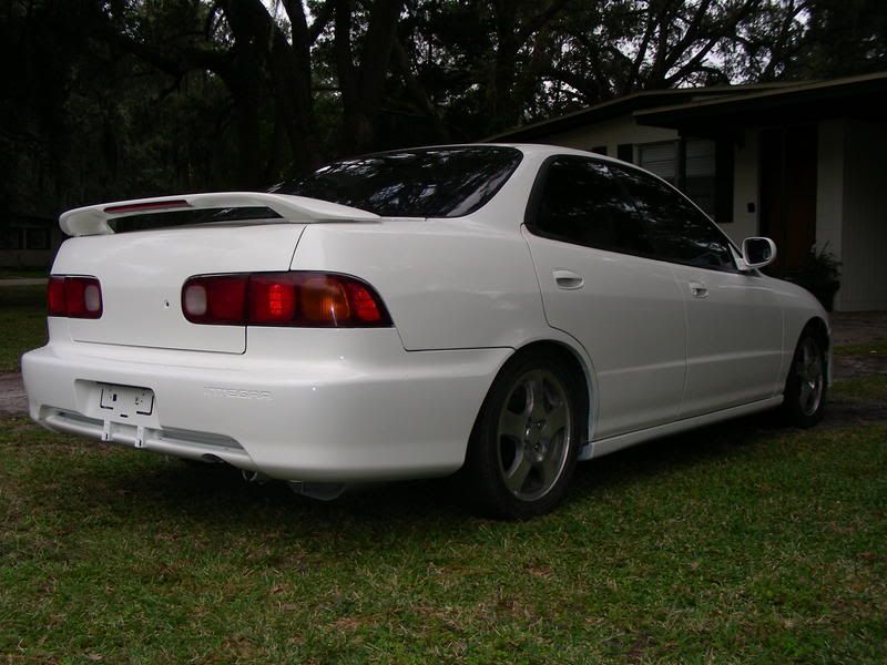

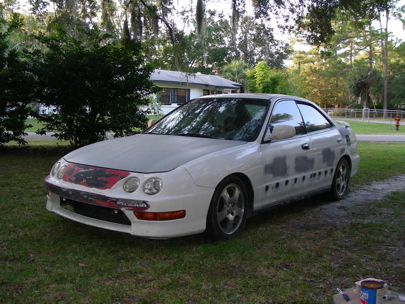

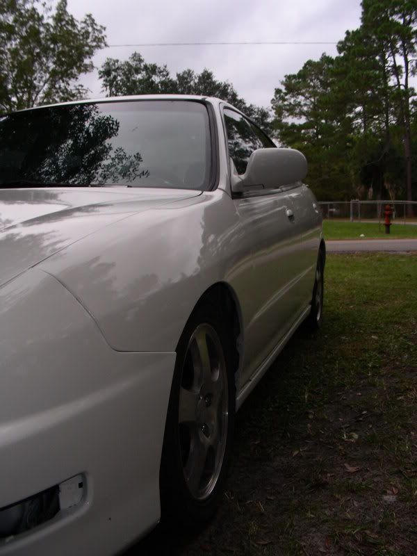

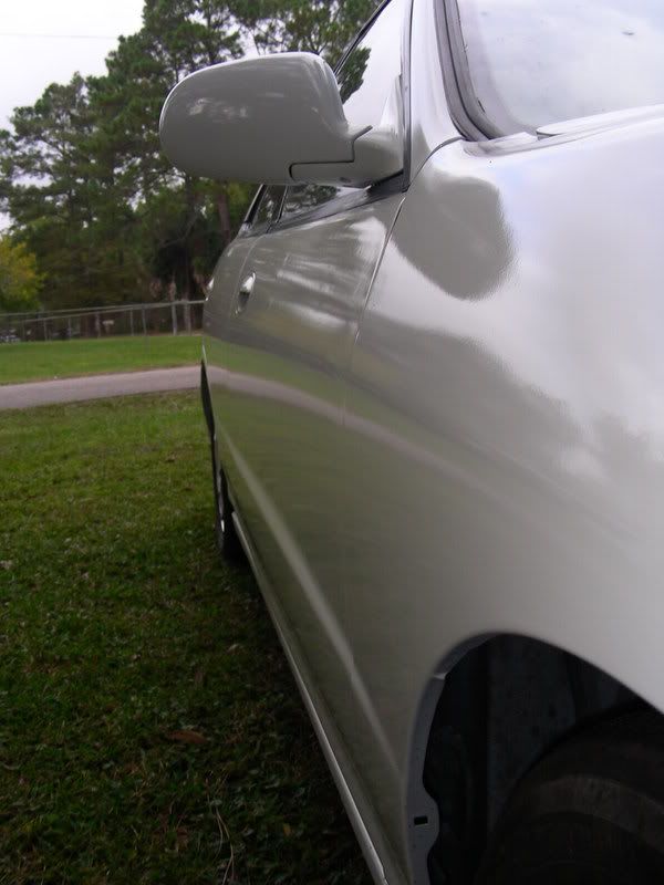

    Some before's and afters:
    Before:
    After =)
    Before:
    After:
    Slightly better me thinks!

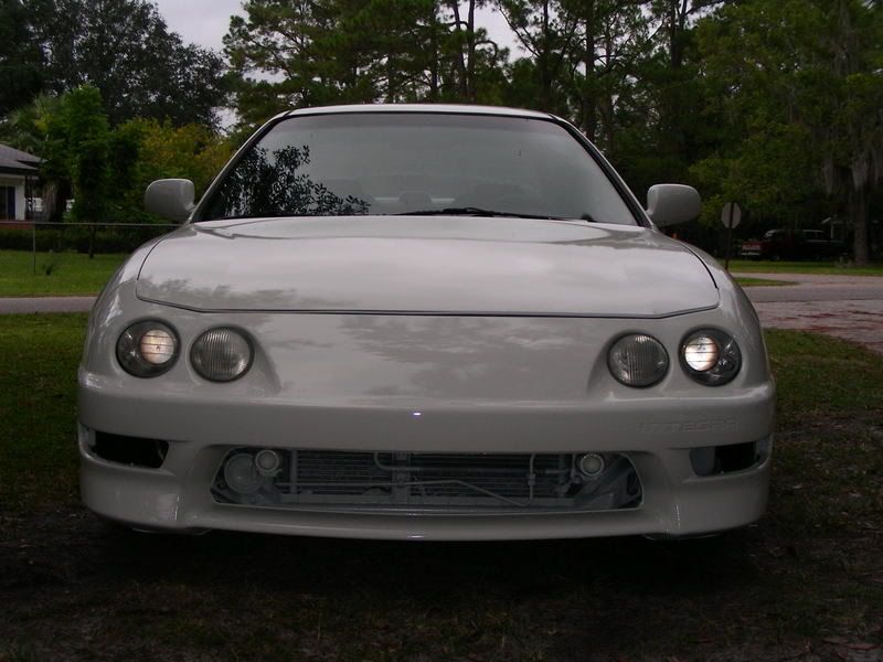

    This will cover the over spray on the front.

    Not bad, esp for $300!
    Boost+84mm=FUN! carbon_crash's Avatar
    Loganville
    2,073
    Def better than before, but looks like it could use a good wet sanding and buffing.
    Ballin' on a Budget
    Monore/Atlanta GA
    847
    Looks good, just need to wet sand it a little and you will have an excellent shine. definately worth $300

    yeah i was looking at pictures like oh boy... then i saw $300 and was like DDAAAAAMMMMNNN!!! hella deal hahahaha. everything looks pretty smooth, just a little orange peely and a little overspray but all in all looks good and make sure you post pics after wet sand and buff and turbo.

    great stuff for the price, but bust out the ol' bucket and sandpaper and fix that orange peel!

    looks like sh*t. Did the shop ever hear about sanding and buffing before the car leaves?
    What is everyones problem? They think they are getting a "good deal" on paint and it always turns out like garbage. Did they remove the bumper or just paint the shell?

    ewwwwwwwwwwwwwwwwwwww
    @before pic

    For 300 I doubt any shop would wetsand and buff and take bumpers off.
    But they could have def. masked up better, look at all that overspray in the radiator/horns/wheel wells.
    But you def. should wet sand and buff the car, just get some 1500 and wet sand her down (with a block) and then get a yellow foam cutting pad and buff her out with rubbing compound, then a black foam pad and polish her.

    looks like they painted over your foglights?
    Looks waaaaaay better than before.

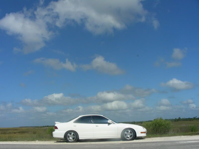

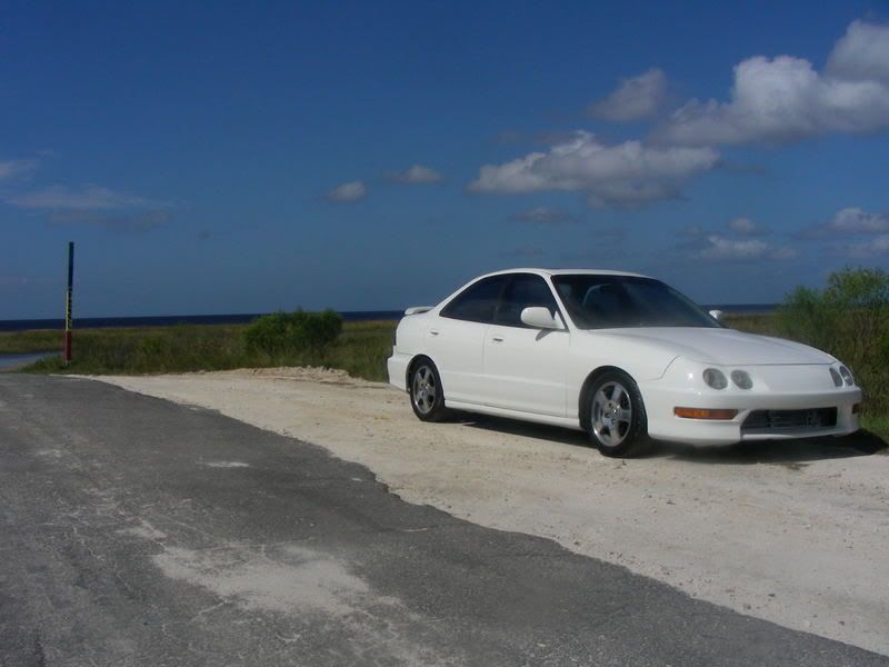

    Hmph.
    PICTURES!!! GAH!

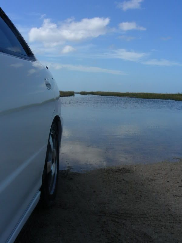

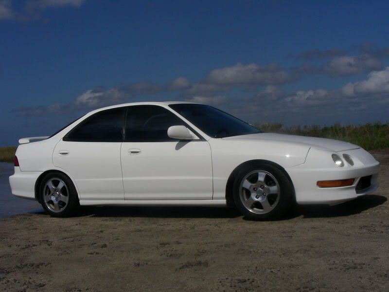

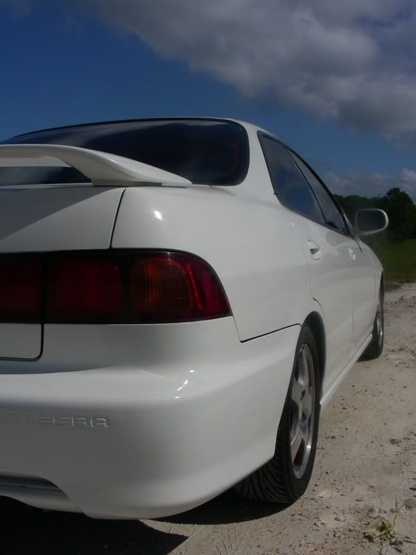

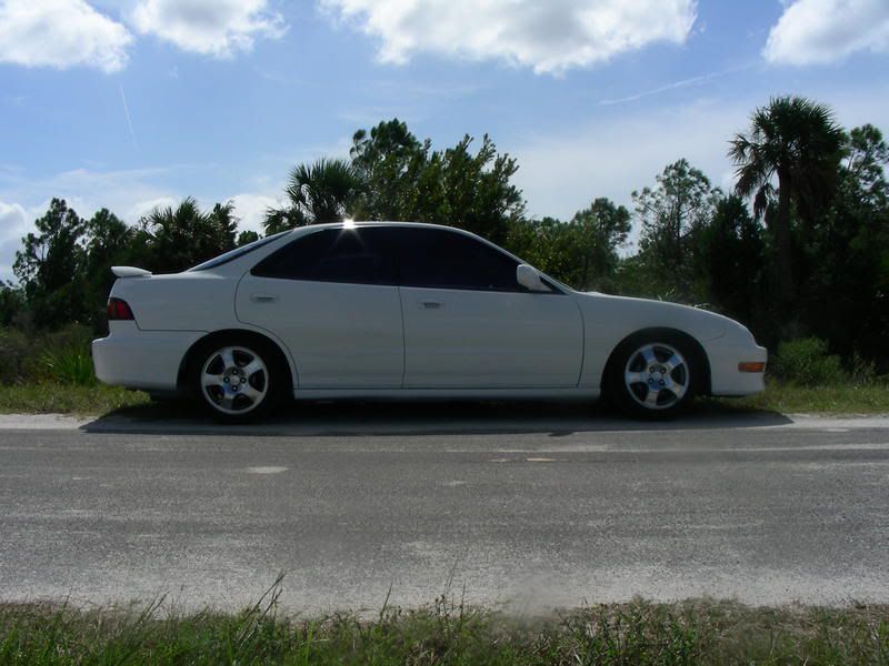

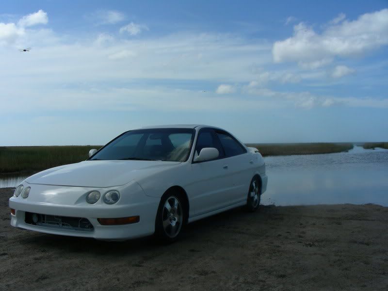

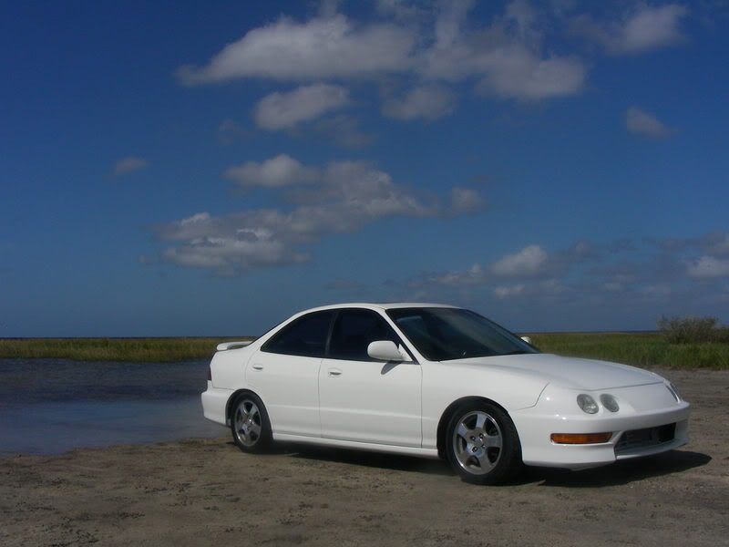

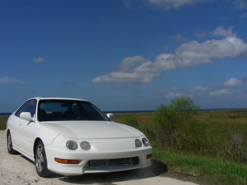

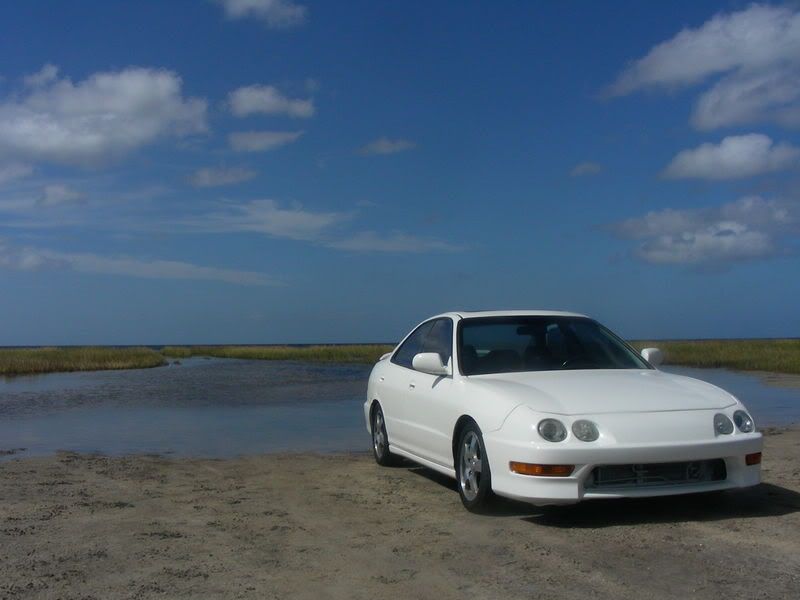

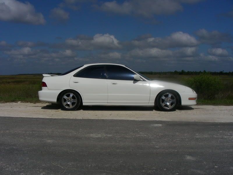

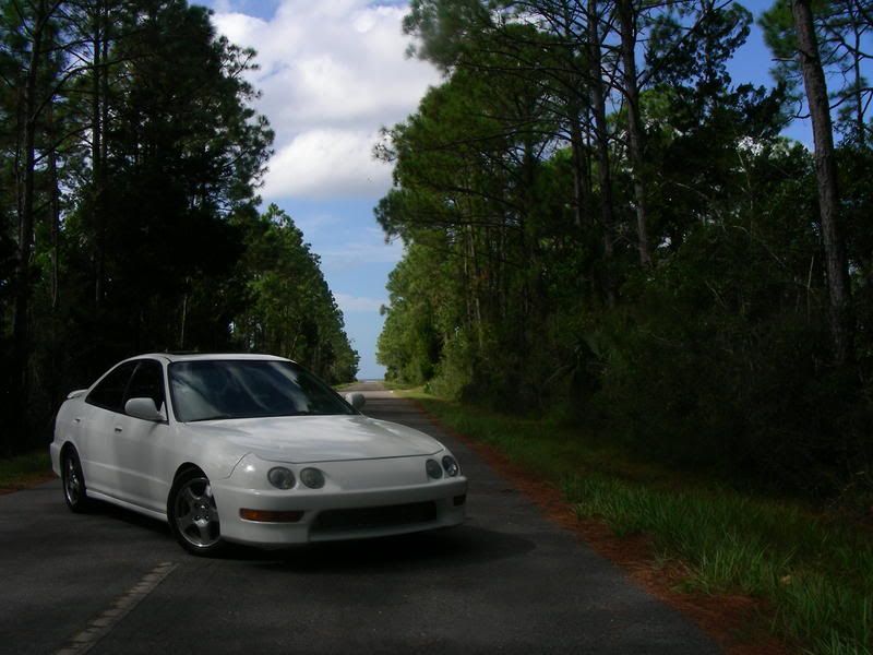

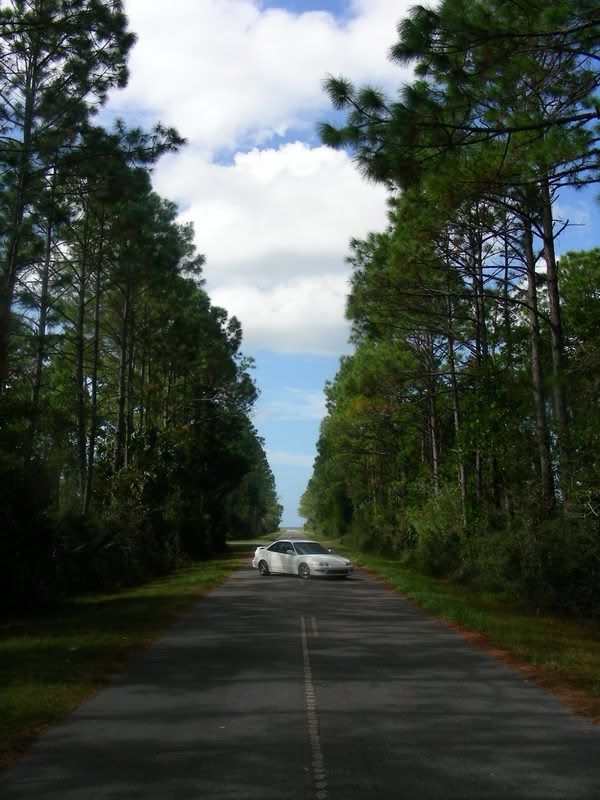

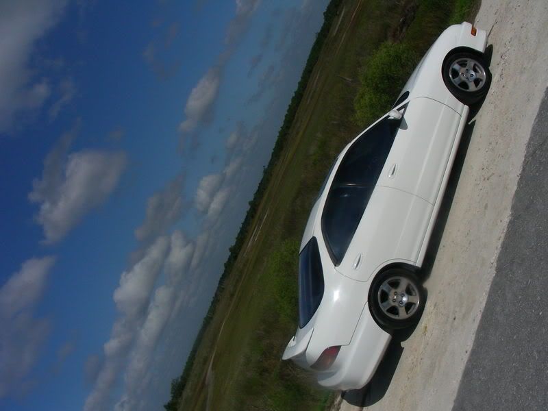

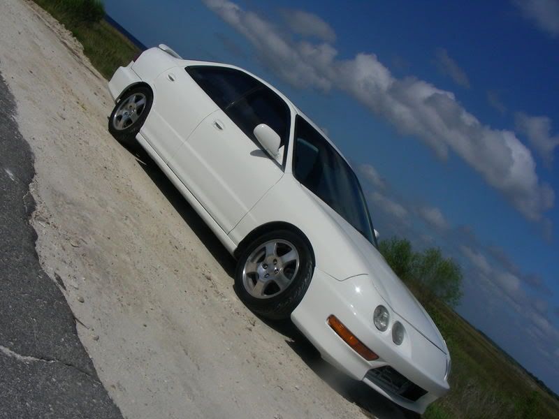

    Yay! Tilty-world pics! I never do these :P
    I wanted my car just this white =)
    I got brave and backed down by the water :P
    Dragon fly in teh corner was talkin smack. I introduced him to t3h V-Tak beat down :P
    And a never before done shot! (By me anyway)

    Sorry, but it's still far from looking good. A wetsand and buff isn't going to fix that poor of a job, especially the massive amount of overspray.
    But hey, you get what you pay for.
