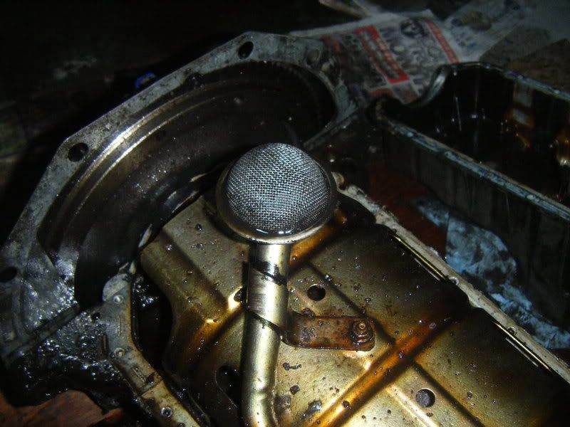

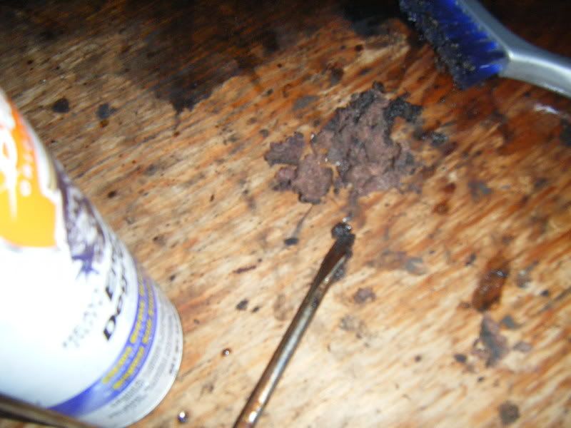

    my engine had an oil leak around the CAS area but i thought it was the head gasket. I went to the parts store and bought an additive that said it would fix head gasket leaks.... bad idea. The car was losing preformance, did and 18.5 at the track, the lifters went crazy on me ticking as loud as they could scream and my oil pressure started jumping back and forth...
    enough weedy weedy, let the pictures do the talking...
    pulled the engine
    And then the first reply was....
    Uhm, according to the manufacturer's website, that product is supposed to be added to the cooling system, not the oil.
    Quote:
    3. Shake well, Mix Head Gasket Repair in bucket or container with approximately 3 quarts of
    warm water. Pour this mixture directly into the radiator.
    Sources: http://www.barsproducts.com/1100.htm and http://www.barsproducts.com/tech/1100_tech.pdf
    and then hilarity ensues.......
