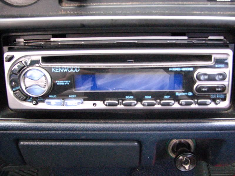

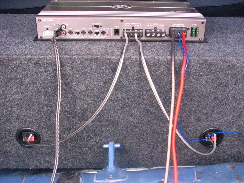

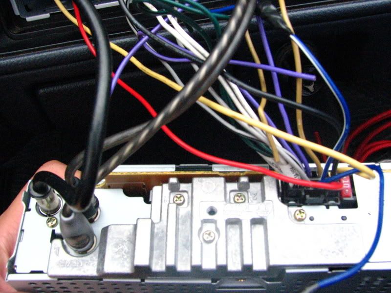

    I have two Memphis Audio 10s and a Memphis Audio 1200W AMP. I have a Kenwood head unit and some Infinity 6022i speakers. Well, before I started to put the system together all I had was front speakers and my headunit and everything worked great. I hooked up the AMP and subs and new speakers and the amp and subs work, but my front speakers do not. You can see the pictures for how the setup looks... I've tried a lot of things, I tried connecting the speakers directly to the headunit instead of through all that connection shit, and I got nothing. I screwed with the Fade and Balance and still got nothing. I think the only thing it could be is the head unit, but to suddenly go out like that? Any other solutions?

    that is some lovely wire you got there... where you at.. i'll hook it up for you son

    well, for 1 that purple wire looks cut but that wouldnt explain the rest,
    anyways, easiest solution is the buy a 4ch amp and hook it up since the rcas work.
    problem solved and youll sound better anyway.

    re-check everything.. and pull off all the wires and make sure they look ok, and try it all again

    The speakers aren't blown because They worked right before installation and I had BRAND NEW ones that I was installing, like still in box just pulled out new. I tried hooking an old and new speak directly to the Front Left Front Right Rear Right and Rear Left wires DIRECTLY, I got nothing. The speakers are hooked up to the headunit not the AMP itself, I think my headunit is bad but it just doesn't seem likely that something like this would happen, thanks for the help so far guys keep it coming
    Carrollton, Georgia
    127
    Ok first off check to make sure your getting power out of the head-unit. Get a test light and check that. More than likely your not. If your not check the harness going into the head-unit and make sure its connecting snug and hitting the terminals (sometimes I've known people to dmg the harness while goofing around with the wires). Ok if your still not receiving power out of the head-unit check the fuse/replace it thats the easiest fix. If not then you probally have an internal problem in the head-unit itself.
    Now lets say your handy dandy test light flashed on somewhere in the above process.
    Do you have power at the head-unit?
    Do you have power at the end of the harness?
    Do you have power after the splice (can't tell if you used harnesses or spliced it out of the picture, I see a lil elec tape but that may be just for the remote).
    Ok if you have power ALL of those places, take a look at the speaker and check power at the speaker itself. If you have power then well..i dunno lol you should have sound.
    Also check to see if your head-unit has the option to shut-off the internal amp. I've heard of some units that allow you to shut-off the internal amp when your installing external amps.

    PROBLEM SOLVED, IDK wtf happened, I guess a loose wire or something. When I hooked a speaker up directly it didn't work, I installed another head unit and the speakers didnt work... Well Bikerj11 disconnected some wires and put them together and the next thing you know my speakers work with his head unit, so then I put my head unit back in and it works... Idk but Yay!
