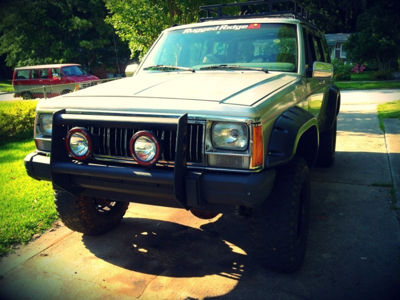

Soon enough! http://img.photobucket.com/albums/v2...s/f7470004.jpg
Just waiting on the shackles at this point.

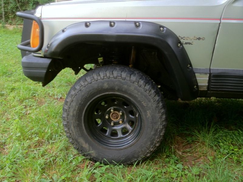

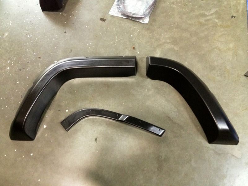

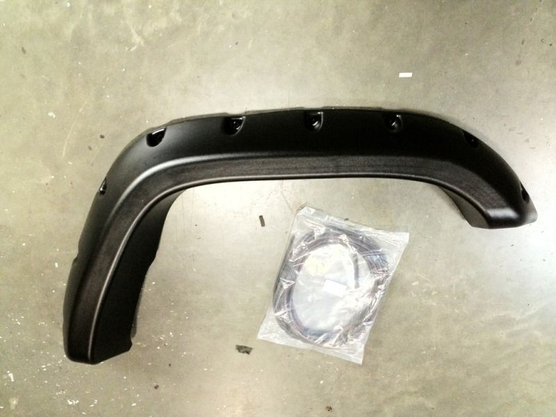

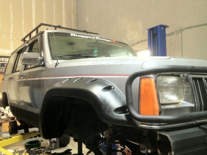

Got my flares in today! Just waiting on the shackles at this point. Hopefully the lift/flares will be on by this weekend!

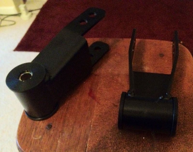

Rear shackles are here, Fat Bob's Garage adjustable 1.5'' - 2''.

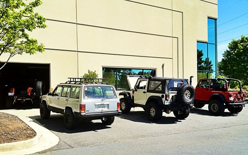

Nice! That cherokee will go wherever dude. Wouldnt be surprised if it could out wheel both the rides next to you when you take the swaybars out of the picture. They are awesome.

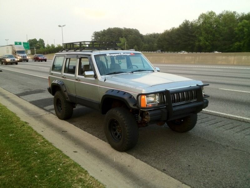

I was the leader all day with these guys. 40's and tera50 on the tj, and Kevins monster.
http://i617.photobucket.com/albums/t...r/ec6b05c3.jpg

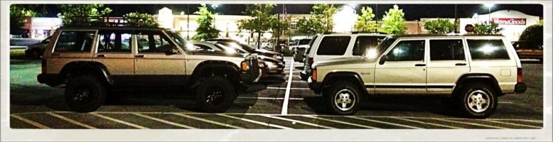

Yea man, they're great! The tan '12 Rubicon JK with the Pentastar/bolt ons is nice, we actually raced the JK and the YJ yeseterday for some fun out back. The YJ has a Chevy 350 in it. lol But all the 35's+ at work make my 31's seem puny! I'll probably pick up a set of 33x12.50x15 Mickey Thompson Baja MTZs once I lift and get the flares/cutting done.
Hahaha...Tire envy is a bitch!
Ya you will def want 33s. That little bit of height definately helps keep your diffs off some rocks.

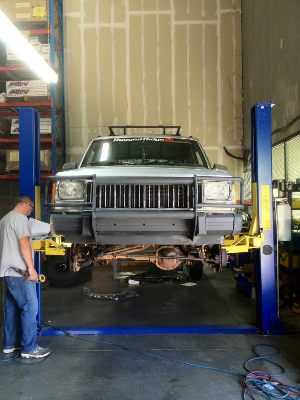

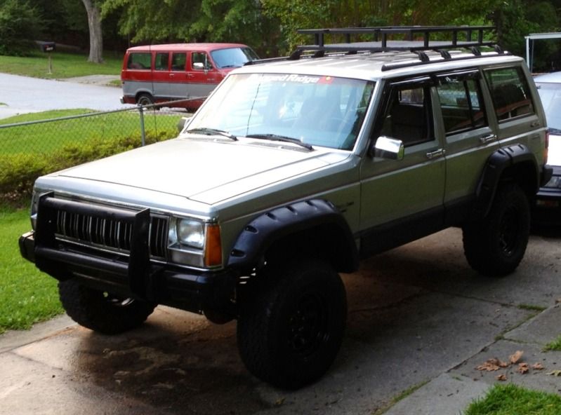

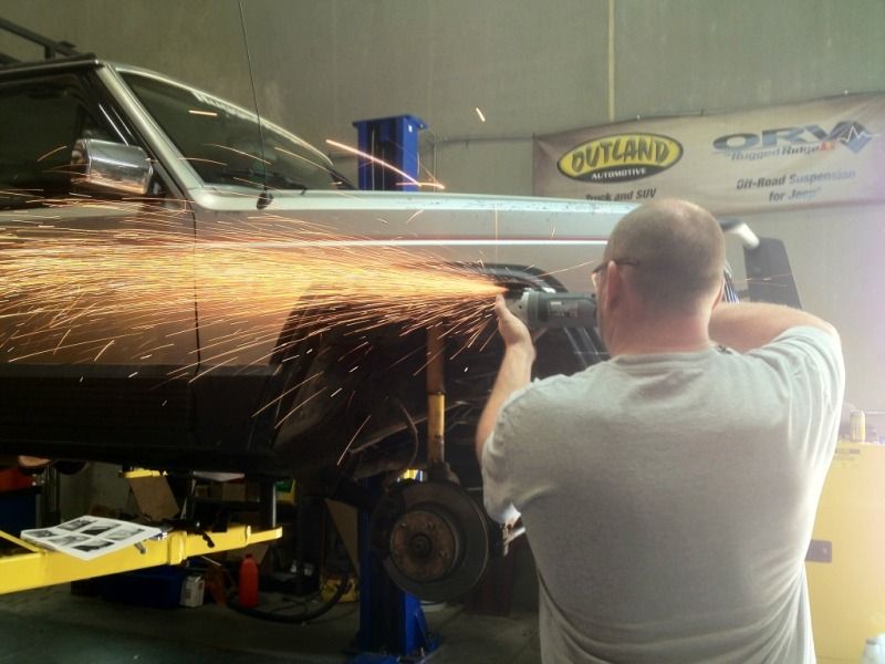

Lift and flares Friday. Also installed an adjustable trackbar and sway bar disconnects.

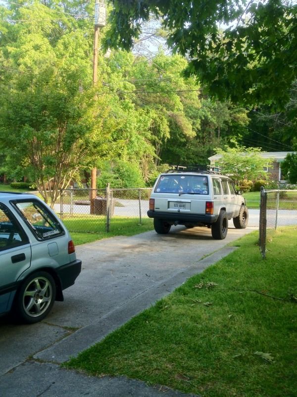

Last morning pulling out of the driveway in stock form:
http://img.photobucket.com/albums/v2...s/a7bc9e7c.jpg

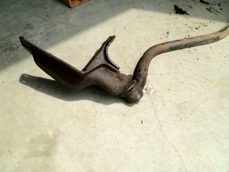

Busted track bar. Good riddance!

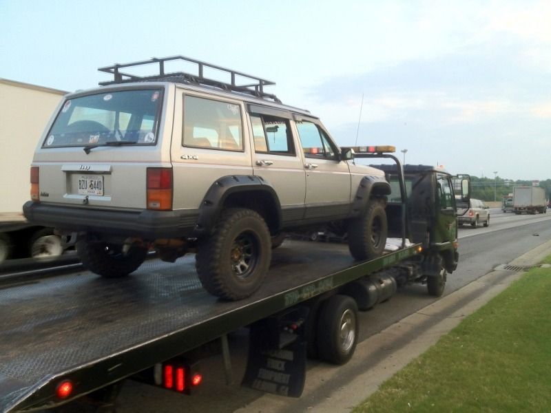

Severe death wobble caused my to tow it home 12 miles. Luckily I get free roadside assistance.

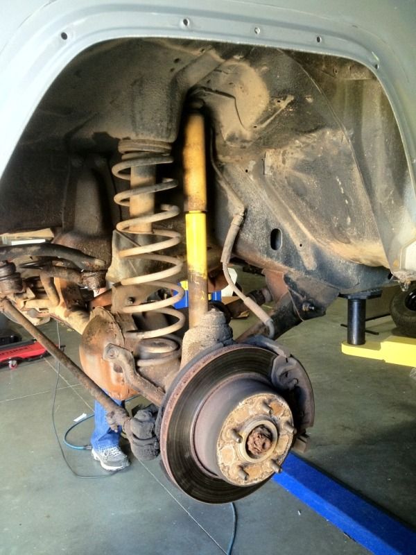

Doing a heavy duty steering kit and ball joints this week, then an alignment. That should take care of it.

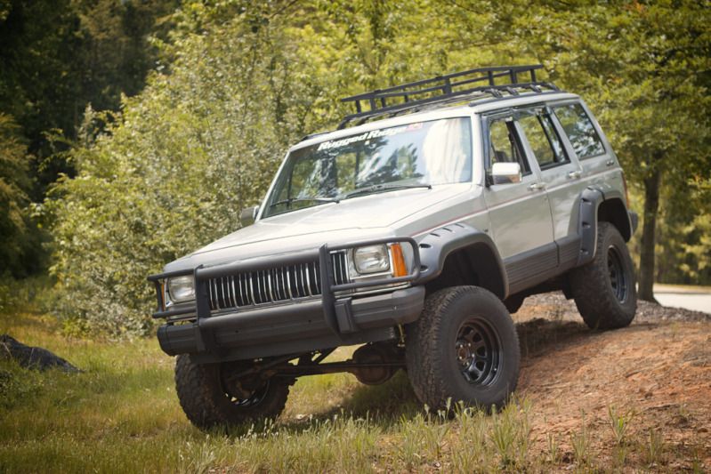

Just been driving it and enjoying it. :)

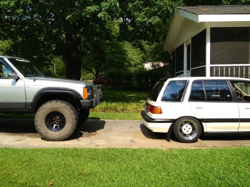

Loud* haha yea man, I've done more maintenance on the Jeep than I have on the wagon in two years! Here's a poser shot from the other day. Sway bar was still connected.

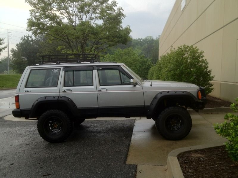

Not sure if I should lower the wagon or lift the Jeep more to get the hood/roof lines level. ;)
More lift is a higher COG..... Not really optimal. Just set up your bumpstops and trim some more metal! Your downtravel is where you win!

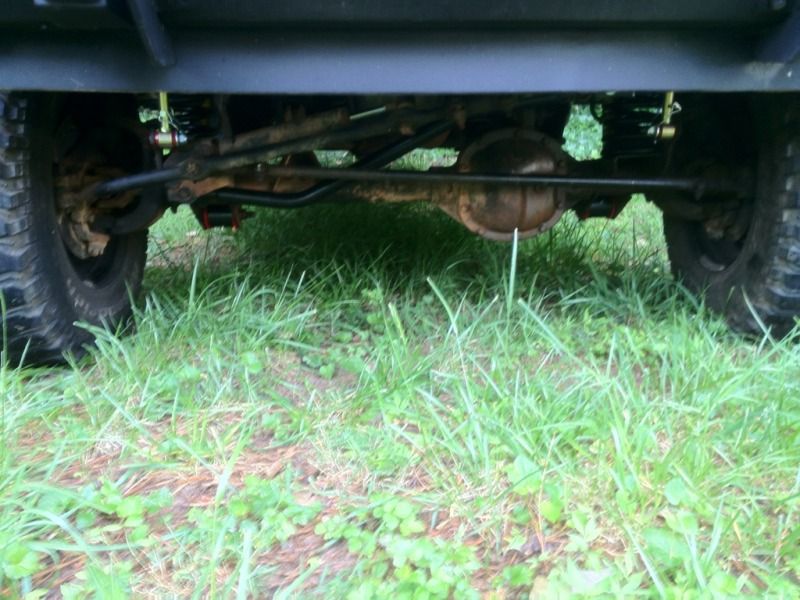

Blew a tie rod end so I went ahead and swapped out to the heavy duty steering kit on lunch today.
1.25'' DOM tubing and 7/8ths tie rod ends.

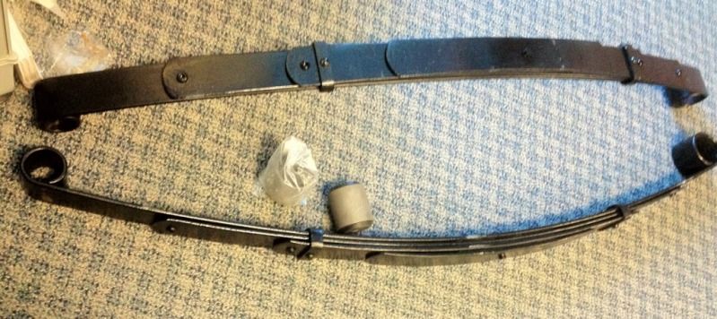

Picking up a set of 4.5 inch leaf springs for my Cherokee tomorrow, the heavy-duty spring and shackle isn't cutting it anymore.
Got some 4.5'' packs with some 6 degree shims today. Might not use the shims, but at least I got some decent leafs!

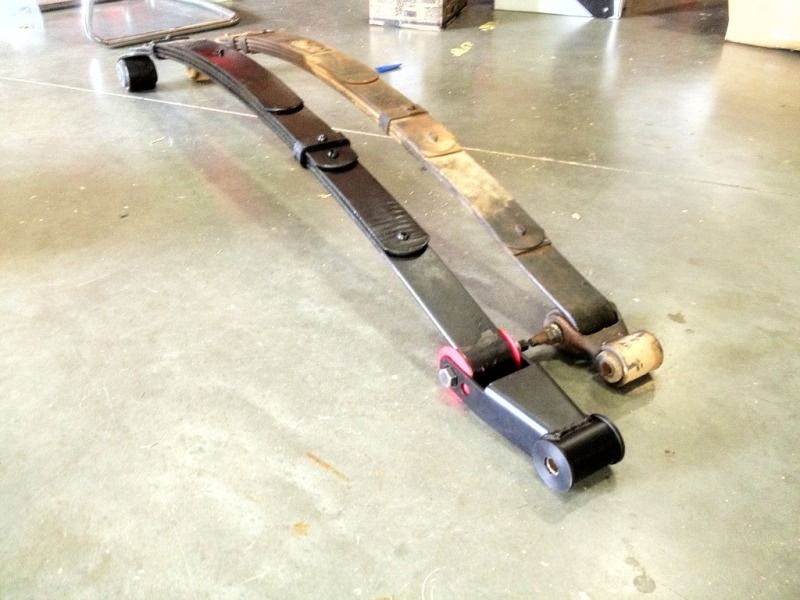

Got the leaf packs swapped today, it wasn't terrible since the bolts had been taken off recently and when I did them last I cleaned the threads with PB Blaster and a wire brush. I didn't really have the right hand tools I needed, but I made due. I'm really happy with the outcome, I imagine once it settles it will sit level. This is on the 1'' section of the adjustable shackle so I can always go up a hole if it's sitting to high in the rear.
